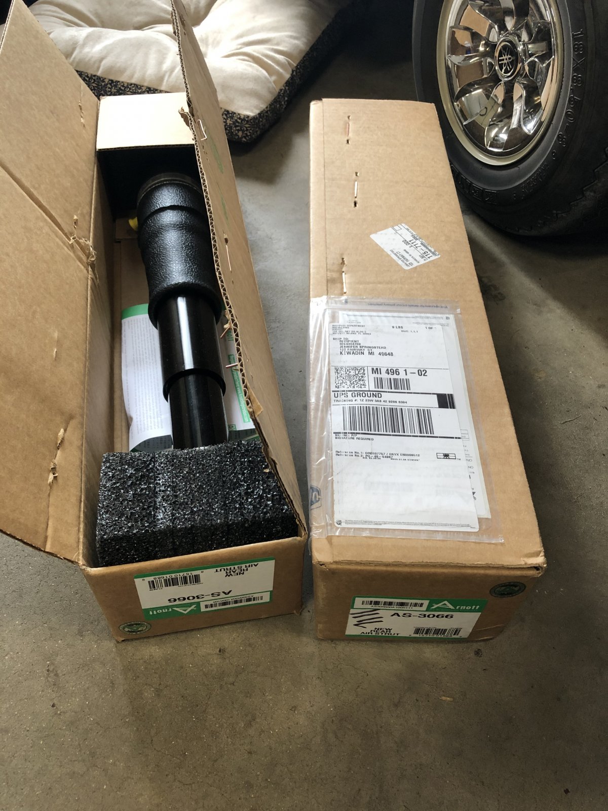

I just replaced my OEM Magneride struts/shocks with units from Arnott SK3354 and AS3066. They maintain the air leveling and have a built in resistor that fools the ride control. They were $1300 at Rockauto. The shock is an Eibach unit and the ride is incredible. I wish I knew about these when the truck was new, I would have replaced them then.
Great to hear!
The rear air shocks just showed up for my wifes denali. Cant wait to get these babies on!
