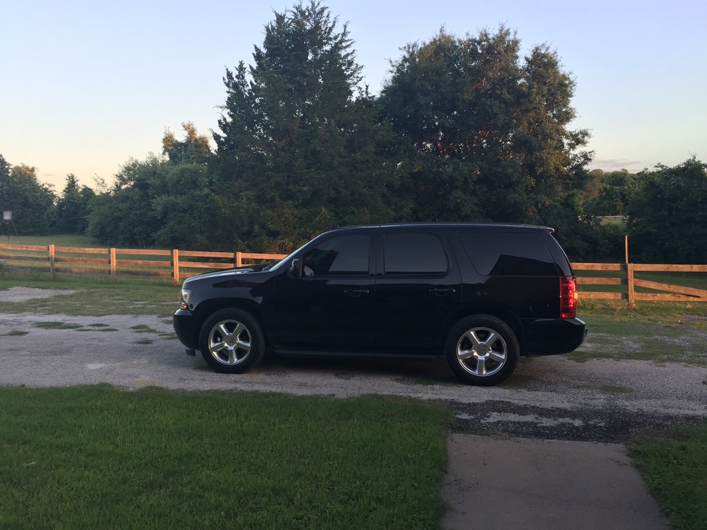

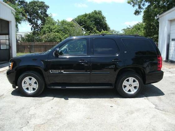

minytrker
Dec 4, 2014
116
30
Before
After
