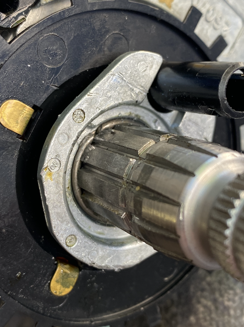

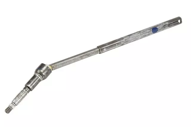

Upon pulling the top plastic cover off the steering column I can see a shaft wiggle congruent with wiggling the steering wheel. However, the end of that shaft that bolts to the upper steering shaft just inside the cabin does not wiggle. I now know where the play is. Whether it's the joint or telescopic shaft isn't known yet.

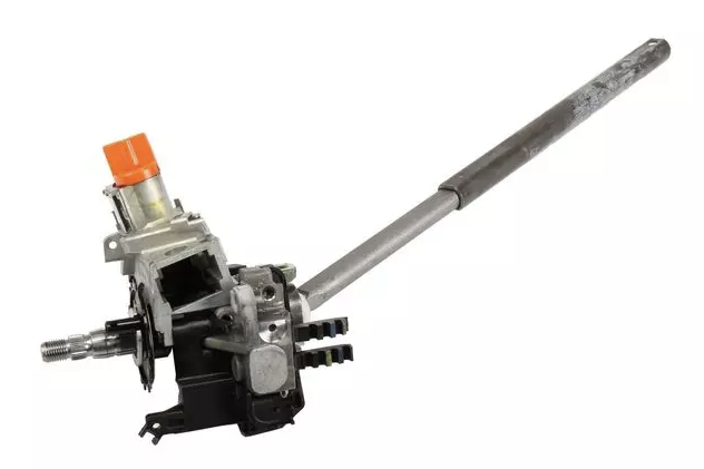

It has taken a minute to locate the shaft part #, Online searches come up dry. Does anyone have a lead on a new aftermarket shaft source or part number?
GM discontinued it, Rock Auto has none, etc .....
GM 26090770 Steering Shaft Assembly. (photo of shaft and shaft within tilt mechanism.

So the play is in the steering column?

Yes, solely in the steering column between the steering wheel and the upper steering shaft. It has taken weeks to find where the dead spot remains as the steering improved greatly while replacing parts, but not quite perfect.
What you've described is usually eliminated by replacing these two steering parts.

@Roilux might need to buy a used steering column?

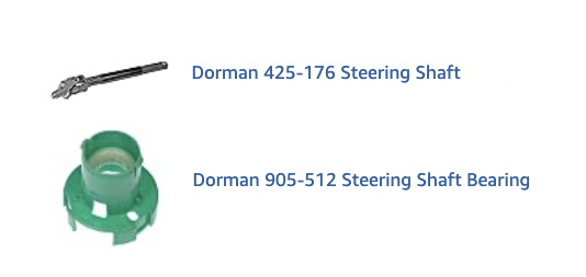

BTW - keep an eye on that Dorman bearing if that screenshot is from your order history. Mine fell apart in less than a week. Similar reports seen elsewhere.
Good to know, the genuine GM bearing is only $1.10 more than Dorman at Rockauto..
Hello fellow Prime shopper. :)
I've already replaced the upper intermediate shaft twice. The ULTRA-POWER unit from RA became sloppy within 3k miles and was replaced last week with a stout Doorman unit. I have an AC Delco bearing in my '04. The Doorman unit was in my '01 and did well for the three years it was in there.

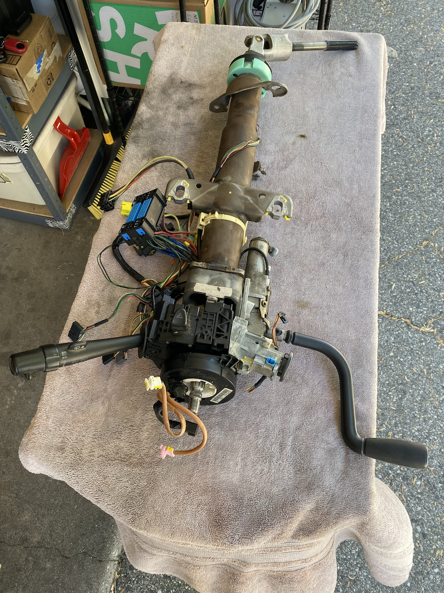

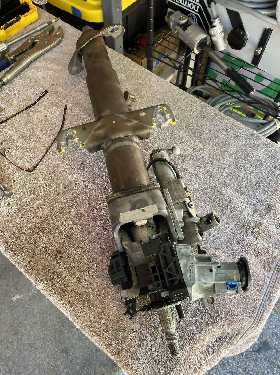

Pulled a steering column today from PYP out of a '06 LT to examine, possibly dissect or determine paths to swap entire columns, swap parts or rebuild a shaft if needed.

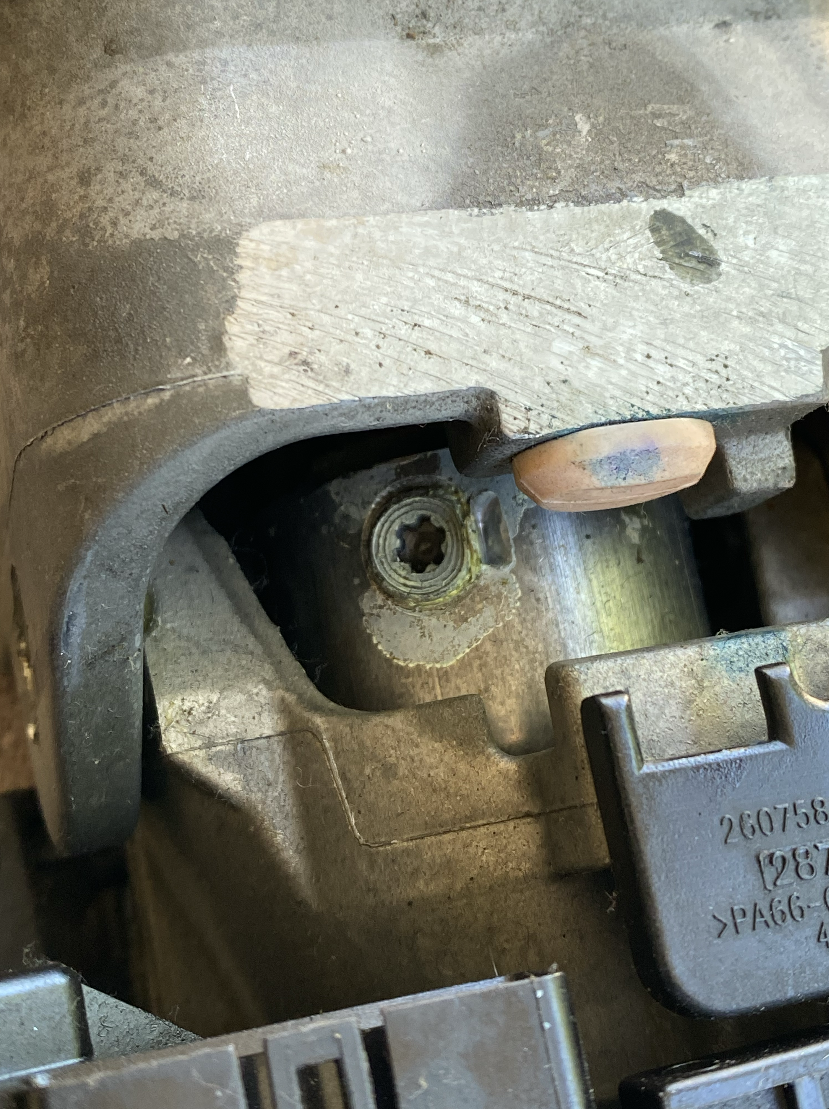

I have noted there are two Torx screws on the plastic joint inside the column that could possibly be tightened.

When tightening the T25 Torx screws inside the column, it only tightens the joint and increase steering wheel turning resistance. The play remains the same. Sooooo, scratch that from the playbook. Should you have really light steering with no play and wish to increase turning resistance then pop the top column cover and give each Torx a 1/4 turn. (last photo in this post)
Now that I have the column essentially stripped, the photo in post #1 of the shaft with tilt mechanism vs bare shaft needs further consideration. Whatever I do once will be repeated once more in order to swap shafts. I'd really like to avoid messing with the clock spring, layers of orientation and an obscene amount of electrical connections, but alas, I'm on a mission.

I'm leaning towards shaft removal from the column. There are far less electrical connections to futz with if I can leave the vehicle's column in place and slide its shaft out.
A 'U' shaped bracket needs to be fabricated to compress the stout spring behind this plate in order to remove the retaining clip. The threads on the shaft and steering wheel nut should do nicely to apply uniform pressure since none of the steering wheel locking plate removal tools I've found appear to be compatible.

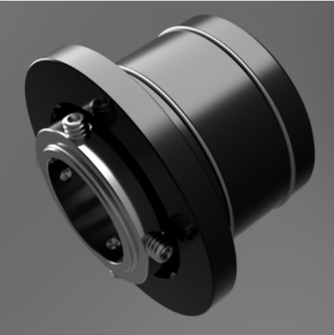

Speaking of lower shaft bearings, once I get this column shaft business sorted, here's the final parts canon upgrade to achieve steering nirvana.
Do I need it now, no. Do I want it, yes.
Wolf Engineering lower steering column bearing.

Nice, looks like they have one that accommodates the position sensor mine has. I even replaced that when I was chasing some issues!
