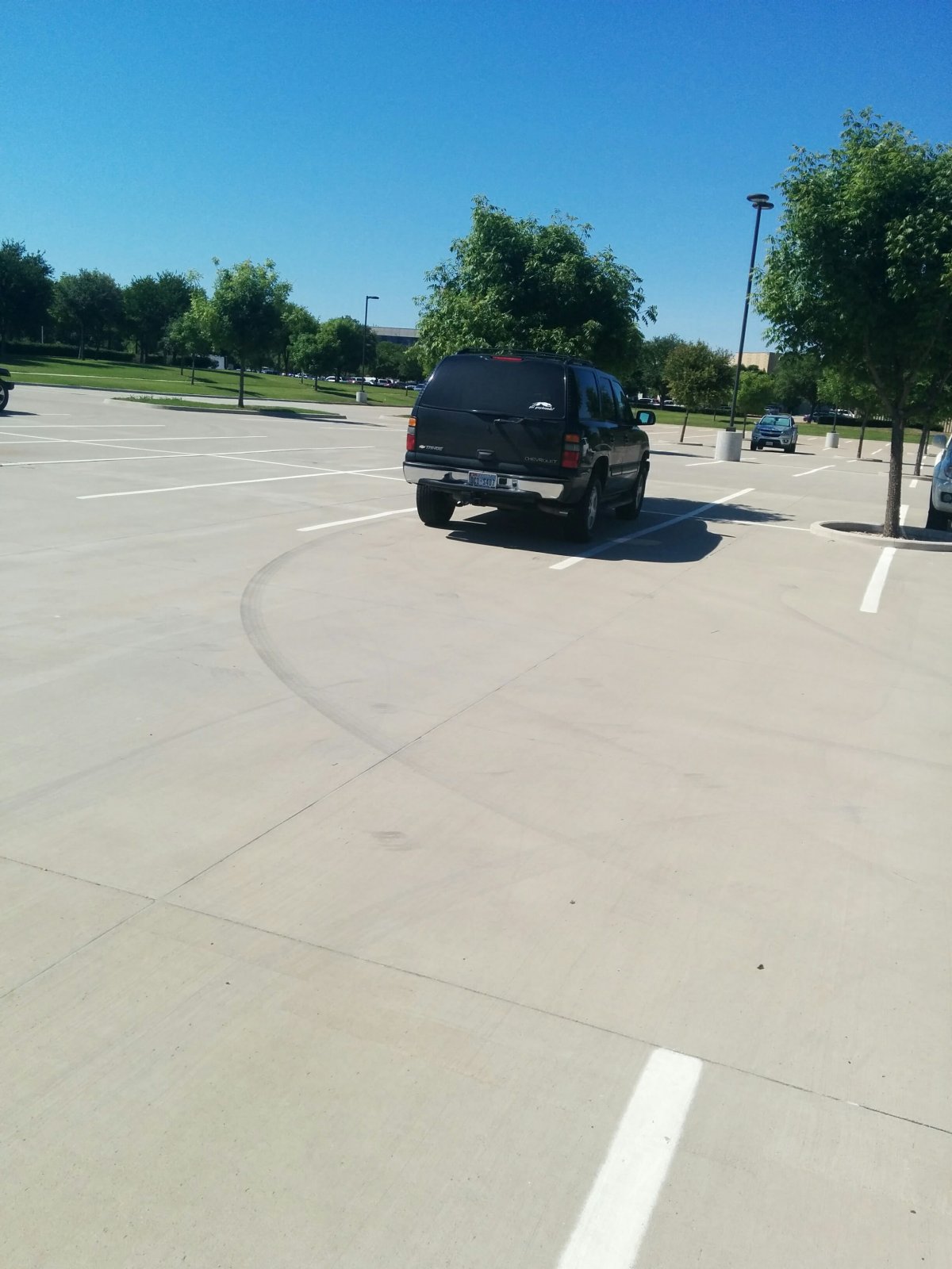

Another symptom from when my centerlink was oriented incorrectly was inability to keep the thing straight on heavily crowned roads and a feeling of instability at highway speed. With all your parts replaced, make sure the centerlink is installed properly: tie rod droops angled toward the back of the truck so to keep them parallel.
Very easy for the unknowing to put back on wrong.
I keep forgetting about this possible cause. Something to check, posted by @SnowDrifter a while back:
It's on correct. I fortunately have done work for 16 years and I make sure everything is installed correctly before I finish a job.
My biggest complaint is this...
The front feels like it's wobbling all over when backing up and when going forward at lower speeds. The wobble is what I have the biggest problem with. The steering wheel has no vibration, smooth as silk. But why the thing wobbles and feels like the tires are skipping the ground while turning is what's really pissing me off
you get anything like this happening?
