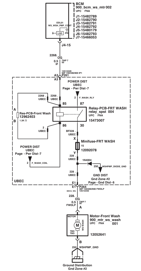

The BCM controls the washers/wipers when you hit the switch. Is it still wiping as well as washing?
If washer only, the relay for the washer is integrated into the underhood fuse box..

Unfortunately the relay is integrated onto the PCB (acccording to the diagrams)
so you may need a whole new fuseblock. Also COULD be the BCM which is the computer that sends the signal to the relay.
But I'm thinking a sticking relay is more likely..
