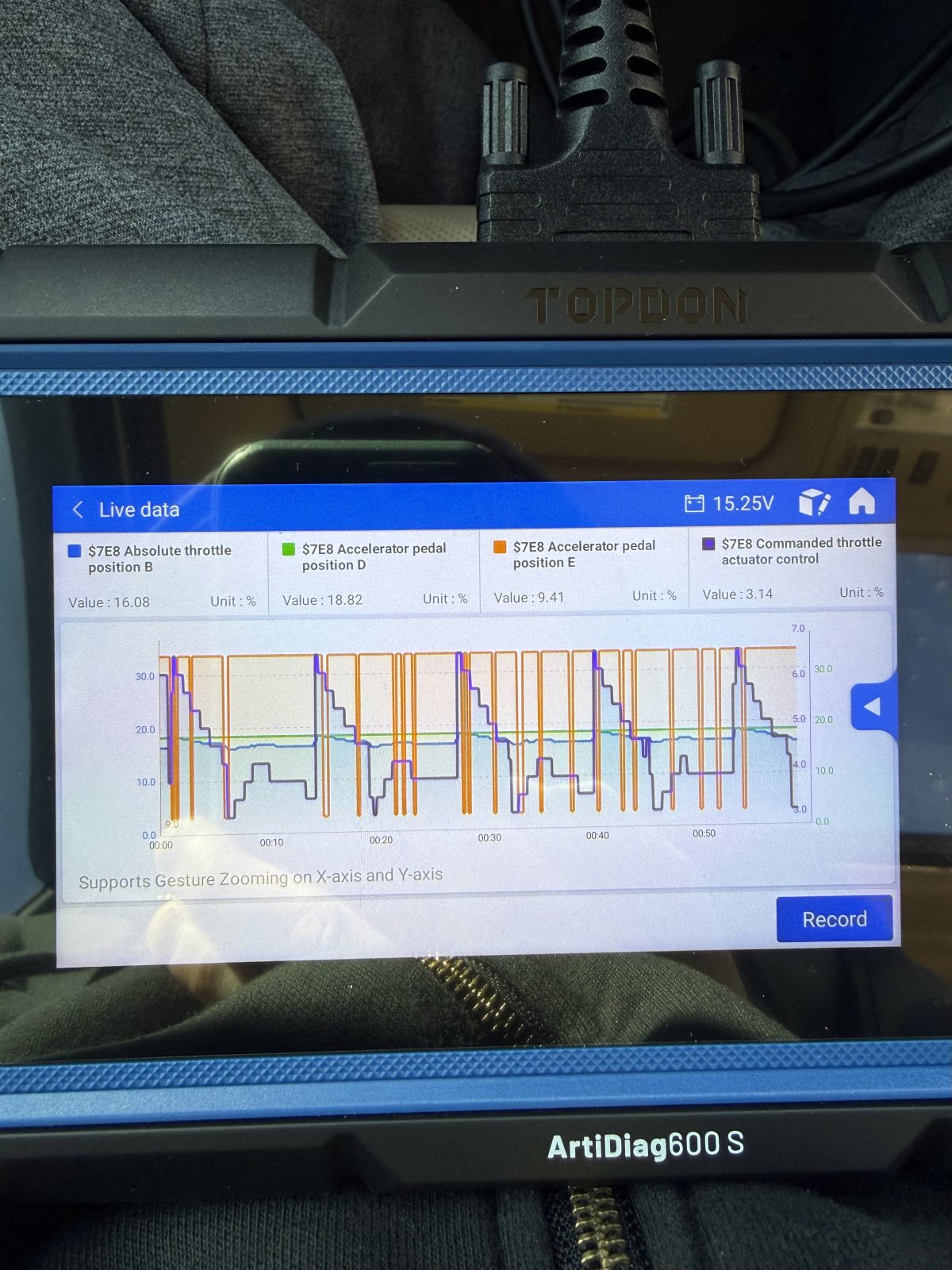

Tested fuses all good. Took power off alternator with key on, still did it. Going to take battery and alternator to get tested. Also started it and with idle going up and down I did a graph of acc sensors and tps. Seems off to me but I’ve never done this kind of testing on a vehicle with so many sensors so any insight is appreciated. This was at idle

I haven't logged pedal position, but that looks off. Guessing you are not pushing pedal?
What's the voltage when running? Is it jumping around too? (log with scanner)

Only grounds I’ve changed are neg terminals at battery to front of frame and front of engine. Also ground strap rear driver side. I will check those grounds. Also yes this is idle no pressure on accelerator. And also, battery voltage showed around 15.1 doesn’t jump too much around .25 at when I checked while running.

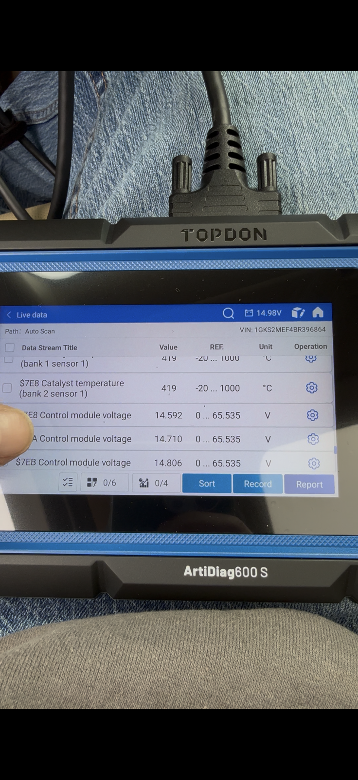

Since you have a scanner, try and look for 'control module voltage' or something like that.

Graph like you did with pedal position might show better if its fluctuating, with engine running.
