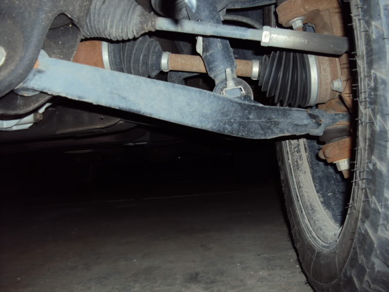

Just curious if anyone has pic's of their cv angles with a 2" or 2.5" leveling kit, I have read they are ok up to 2.5". Just bought the wifey a 07 Z71 and want to run the Nitto 285/50/22. I didnt come up with much on a search but Ive had 5 Chevy HD's either lifted, cranked or leveled and over the years spent a fortune on IFS front ends. I plan on doing the Cognito idler and pitman arm braces too, and if anyone has any other suggestions let me know.

I've got a 2.5 inch kit and running the same size tires as you're wanting. Don't have any pics handy, but my angles are overall not much different between stock. No issues here.

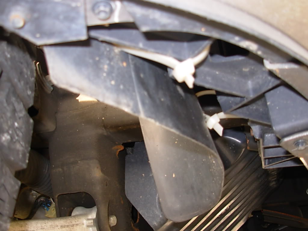

Front wheel wells, had to do some minor trimming on both sides where the tires meet the wells when fully locked either way (front & back sides). Normal driving was no issue, but had annoying rubbing when turning with any kind of suspention shift/flex. Also removed the plastic support that is between my frontal well plastic and the front fascia (also bolts to the fender) on each side and trimmed some off with a jigsaw and then replaced and used a couple of zip ties to pull the well plastic forward to the trimmed support. Added another 2" to the turning clearance. I don't know if the Tahoe's have this same support piece or not.
May sound cheesy, but it actually worked well and doesn't look jerry-rigged.
I can take a couple pics of the fenderwells/suspension for you, but It'll be a couple of days 'til I make it back home to do it. Somebody else may be able to get you some quicker.

Best pic I have of the plastic piece Victory is talking about...this is on a tahoe, so I think that the yukon and tahoe are very similar...pic shows it already trimmed back and tiewrapped.

I know this is gonna be a few days late and a couple dollars short, but last night was the first chance I've had to get some pics under the Yukon. Similar to InTruckDesign's post.
