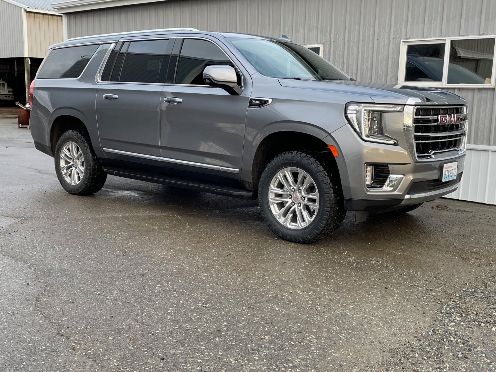

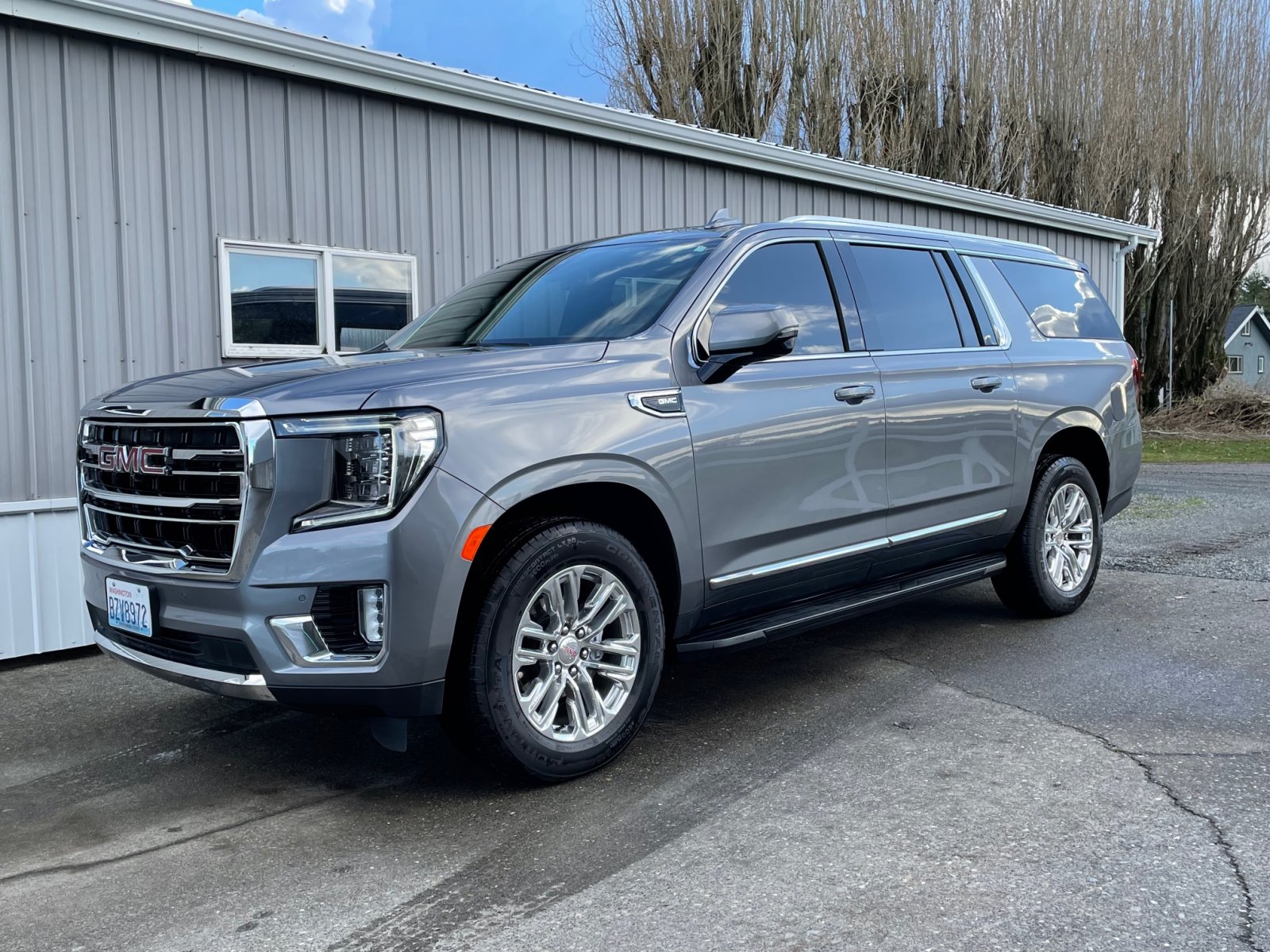

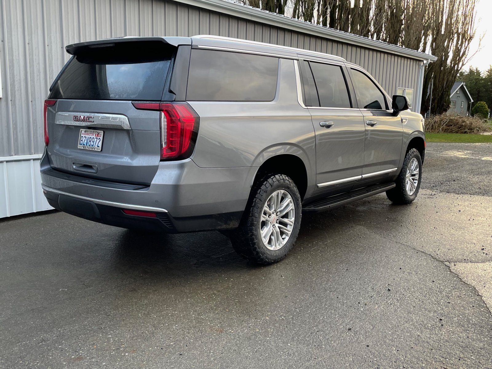

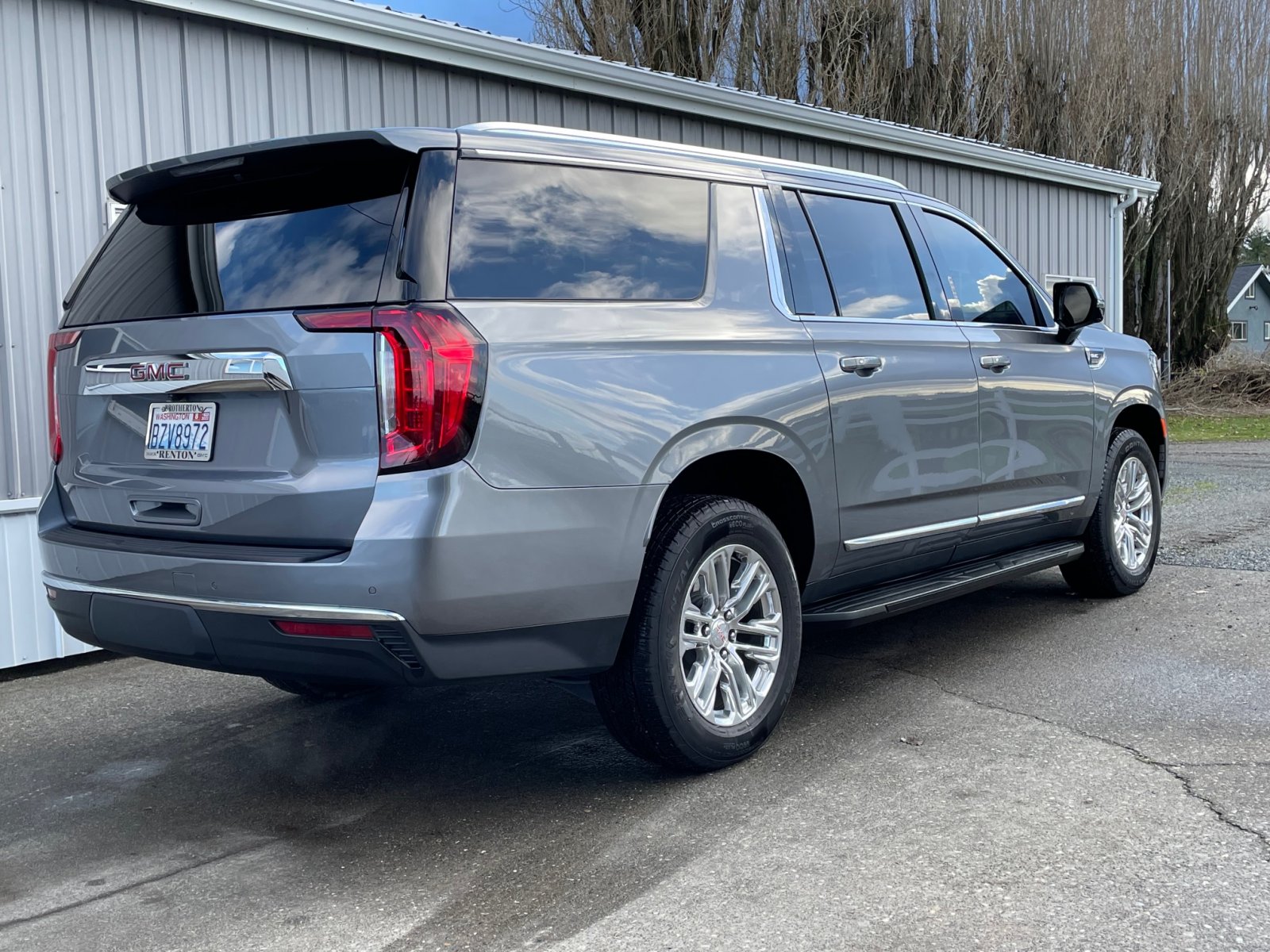

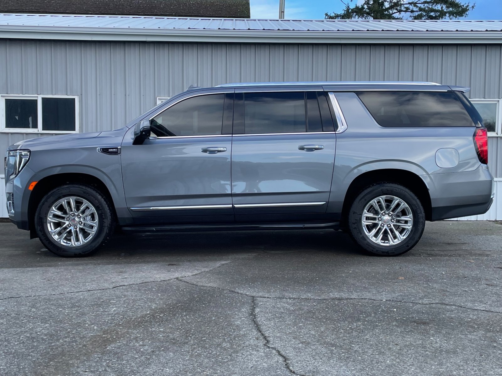

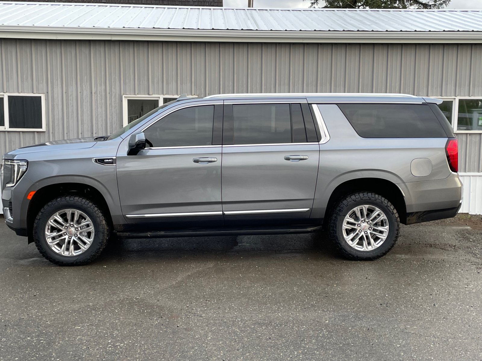

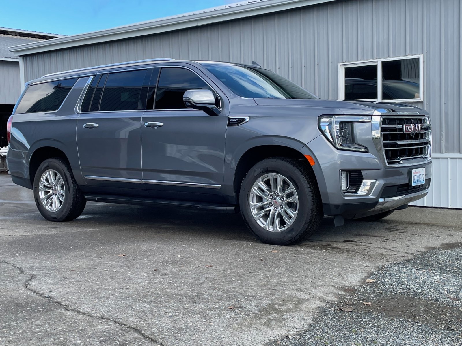

Leveling kit is on but it's not exactly level. Not bad but it's not level...
pre leveling kit measurements from the ground to bottom of wheel arch:
front 36.5"
rear 37.75"
post leveling kit:
front 38.25"
rear 39"
So it seems this kit has underdelivered in the front and overdelivered in the rear which is maybe why the fine print says it does not fit a gmc. Like they told the parts department it's something to do with the ride height from the factory. 3/4" higher in the rear isn't a terrible result and still leaves a little room for sag when the vehicle is loaded. It was dark when we picked it up so no good pics to share at the minut
