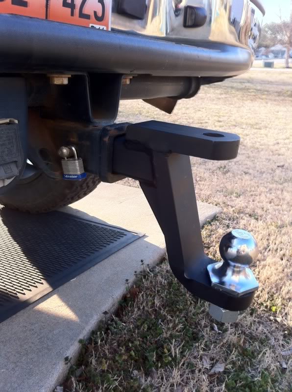

Custom 7" double drop hitch
7/8 flat bar steel
3/8 tube
and some time in the shop
top will house a 2" + ball for the contracting dump trailer that has a high chassey and the drop will house 1 7/8 for the boat and jet skis..
heat + vice + big hammer = drop step one
ready for media blast box then paint'
Flat black powder coat. then oven bake..
no i only have to haul one receiver and never remove..

thanks man, it should allow me to only have one receaver and never have to remove if i do want.. also made it well because it could be done and BEEFIER is always better.. sucker weighs in at 13.8 lbs naked without the balls.. it has some heft to it.. you will think twice before rear ending me.. bc this will go threw your radiator and crack the head or block of your rice rocket car that is always tailgating me.. i can see you in my rear camera...
yea should prove usefull i hope..

Installed the hitch today.. Decided i am going to get 2 sets of swap ball sets.. so i cam mix match at will.
