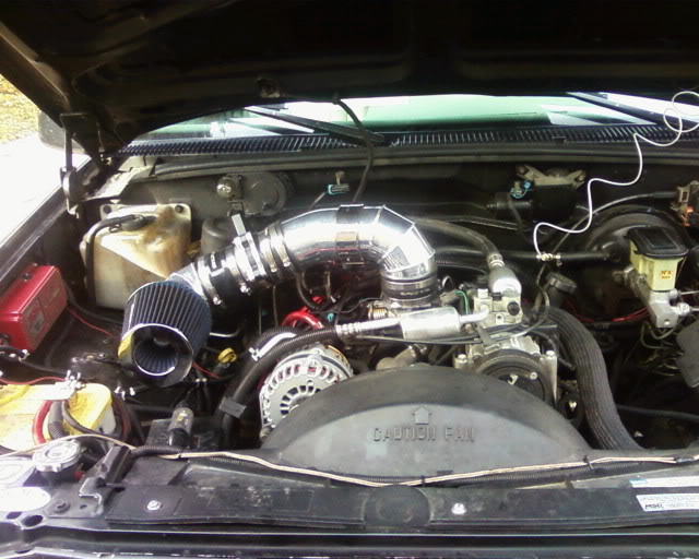

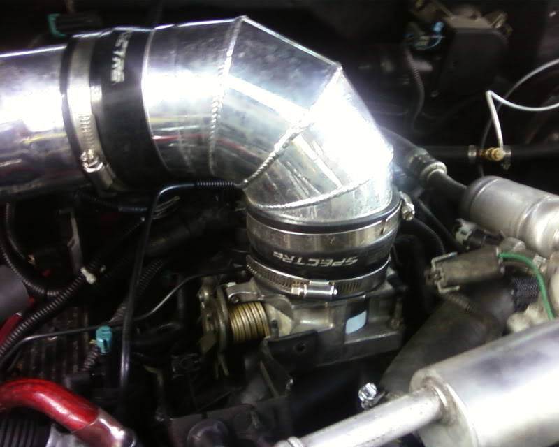

here is what i did with mine. its a 90 off the TB to a 25 degree to the maf then another 90 to the filter. it was custom bent and welded by my buddy at a machine shop. costed me about 30 bucks for the work and the 4 inch aluminum pipe. then a filter and some spectre rubber clamps.
i know i know the band is inside the pipe, that was only mocking up
if you want some more help let me know

cool thanks for the idea. That is kinda what I was talking about. I was going to just run it into the factory box to reduce water exposure.
