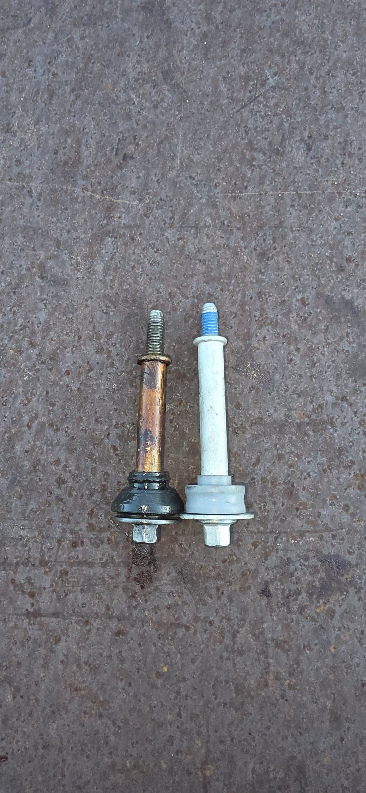

These are the two side-by-side.

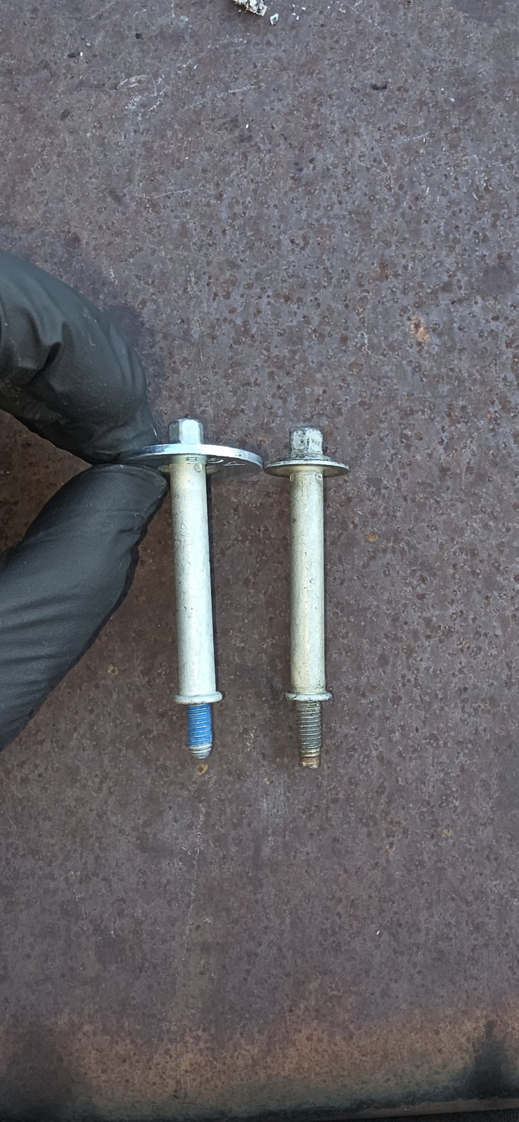

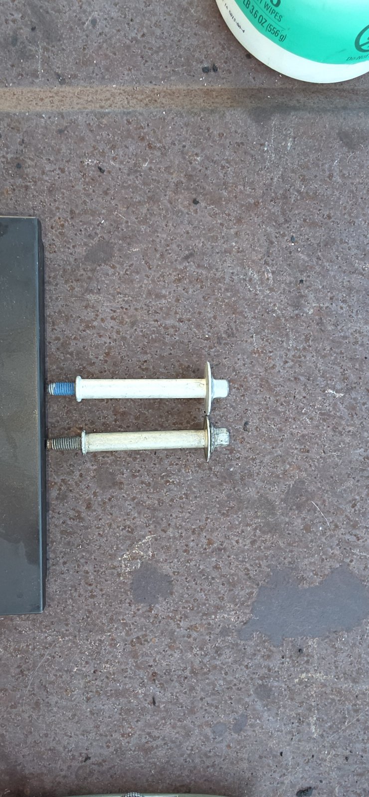

For anyone who manages to be as stupid as me (I know, you have better odds of winning the lottery, LOL)...
The grommeted bolts are NOT the same as their ugrommetted counterparts. The bolt itself is just about the same length, albeit with less lead-in, but the sleeve is longer with a larger diamter. Since the sleeve is what makes it fit or not, this one went not...
It actually looked promising as the height was off by almost exactly a 1/2" flat washer thickness, and they seemed to torque nicely with said washer, but the "bank 1 too rich" and "bank 2 too rich" codes tells me it's not gonna fly.
Ordering the correct bolts now...
