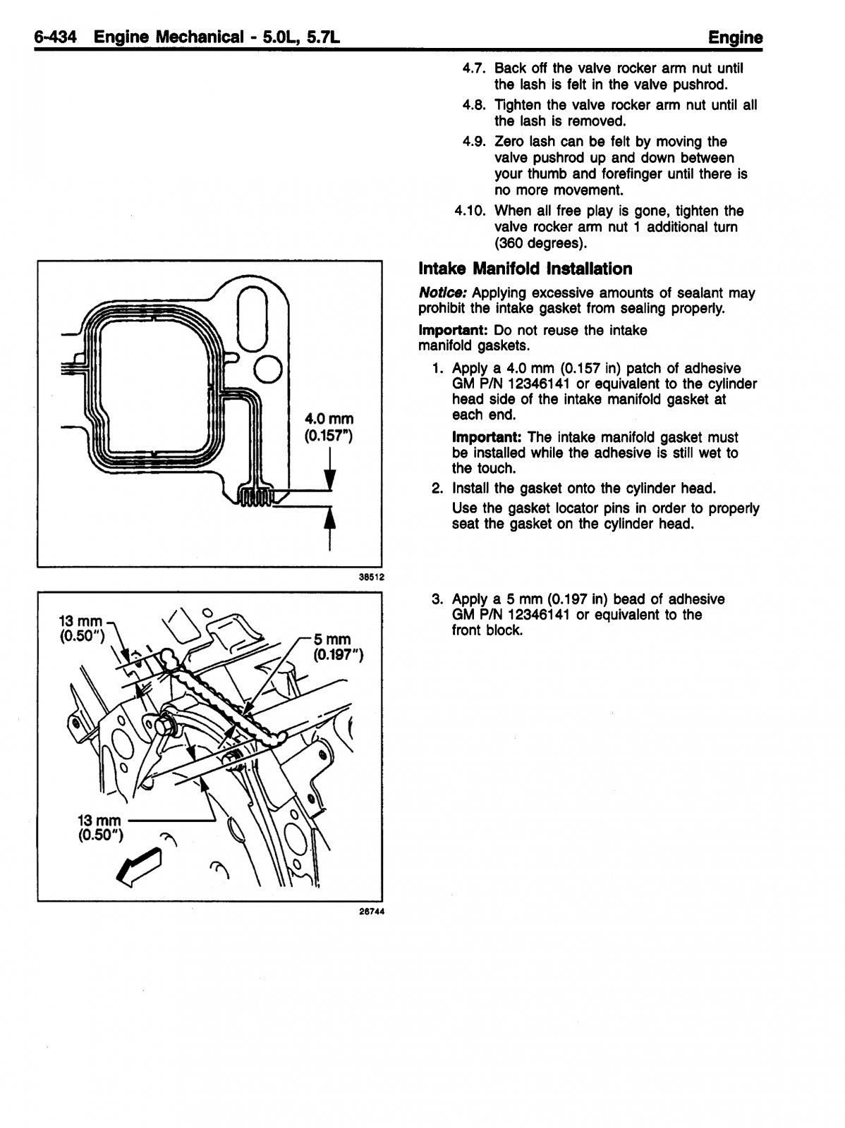

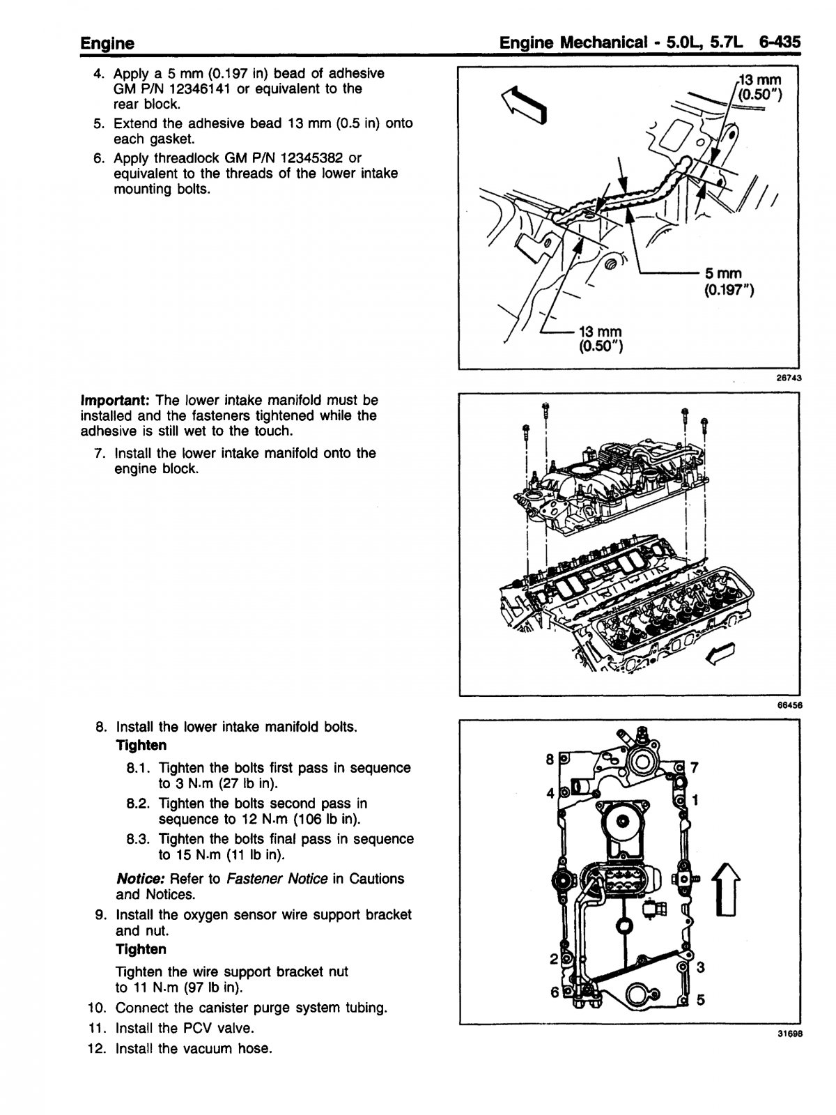

I cannot tell you how disappointing this is after spending about 8k between the new crate motor and all the new parts I added. I put in the felpro gaskets with new bolts w/ threadlocker...and I used the black rtv in the felpro kit for the chinawalls.

Did you put RTV on both the top and bottom of the little gasket tab where it meets the china wall? The RTV was allowed to cure? Usually, by the time I’ve gotten everything back together it’s had plenty of time to set.

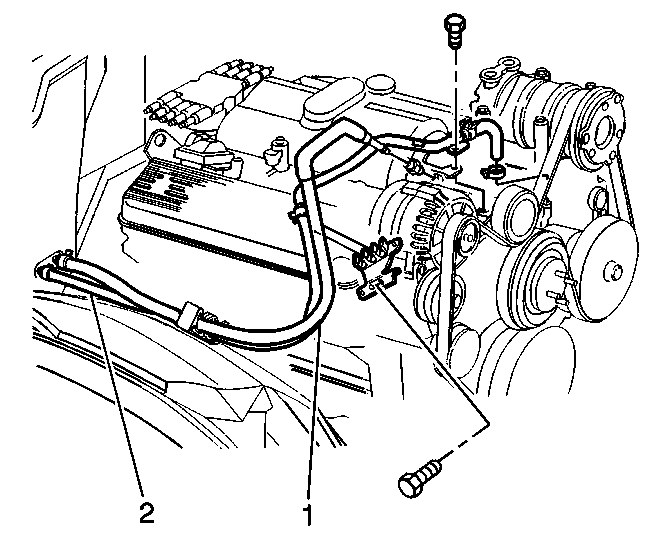

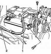

Have you checked your heater hoses near the firewall?
I agree, the lower intake design on that gen one motor is a PITA. I had to replace one on my sons ‘97 K1500 last January when it was 10° outside.
I don't believe I have heater hoses near the firewall. I replaced the 2 heater hoses (3/4" w/ plastic quick connect into the lower intake and the 5/8" at the water pump). I have a tahoe which doesn't have the rear heater like the suburban.

Thanks east302...I will check the knock sensor...I put a new one on. Yes...I did put RTV on the top and bottom of the gasket tab/return at the china wall.
I used the rtv that came with the MIK98000T kit. There wasn't much in the kit...and I did the front wall first, then when i did the back, i'm wondering if i didn't put enough on. I did give it time to set where it wasn't sticking.

If that RTV at the wall was somehow “not right” enough to send coolant down the back of the block, then I’d think that you would see coolant in the oil fairly quickly. It wouldn’t hurt to drain it and see, but an external leak at a hose or something just sounds more likely.

Regarding the heater hoses, that poster was referring to the two lines going through the firewall under the a/c accumulator.

Check the quick disconnect fitting for the heater line at the intake manifold, passenger side. I had one that wasn't seating anymore, and coolant was running all the way back along the rocker cover, down the back of the motor. Took me a long time to diagnose. Get the GM part, not the Dorman if possible.

My apologies. I thought someone was referring to heater hoses coming out of the back of the engine at the firewall.
Yes. I did replace the 3/4" and 5/8" heater hose lines that connect to the heater core at the firewall with new Gates Green stripe hoses. I also put on a new gm genuine heater valve (T). Unfortunately I put on a dorman quick connect...but I don't see any leaks there. All the heater stuff is new...except the heater core (original)...I pulled the carpet back thinking maybe I have a pin hole leak in the heater core...carpet is dry.
