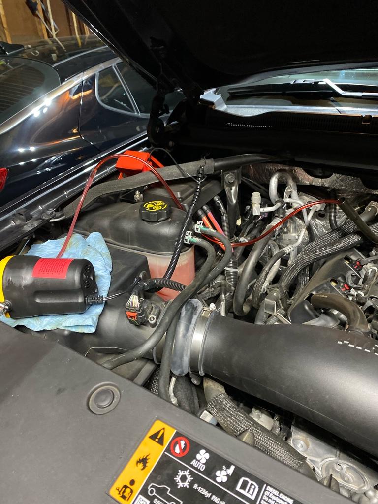

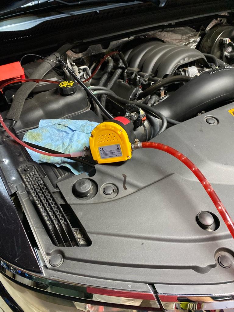

I have that same exact pump.
I modified the housing to flow more air, and i usually put a box fan blowing on it when running it.
I prime the pump using my power vac brake bleeder.
I also took the pump apart and found it to have a decent design for the money.
That’s a great idea to use the brake bleeder to prime. I figure it’s going g to be a while before I do it again. I put amsoil so it should last a while.

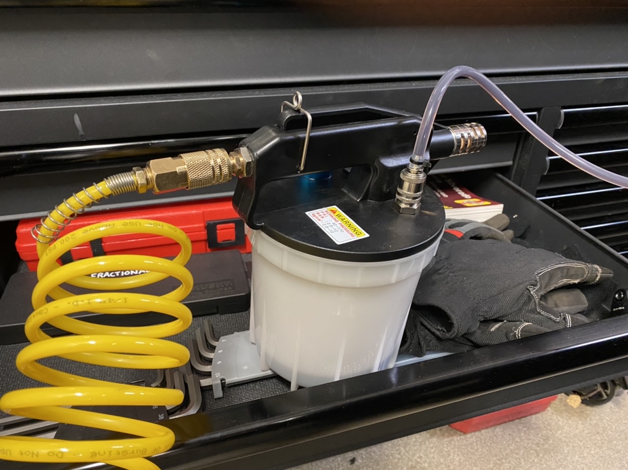

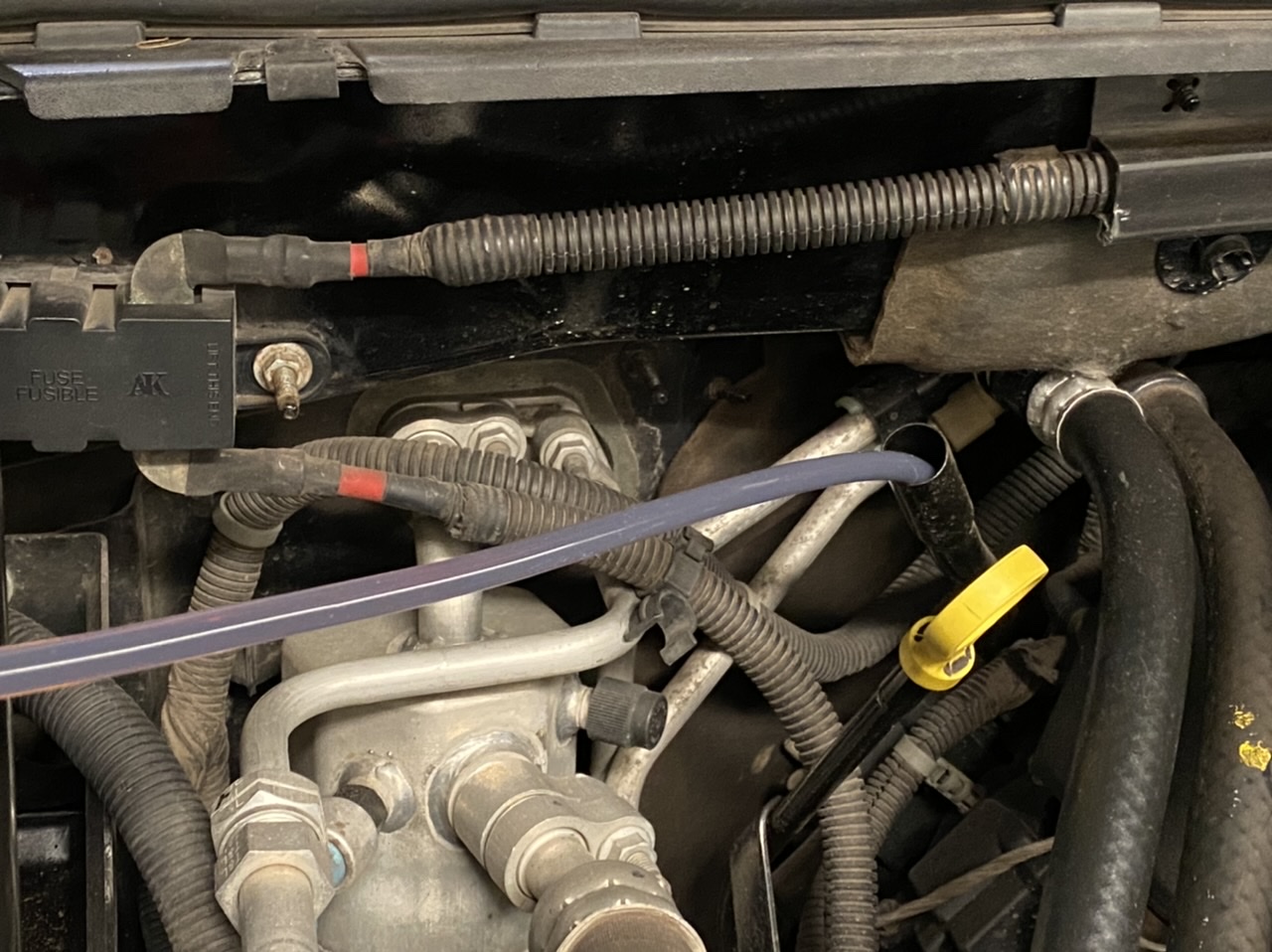

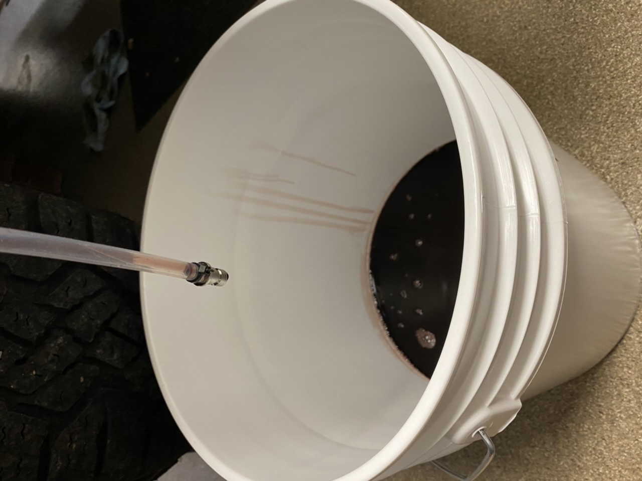

Well, I received the 10 feet of 3/8” tube late last night and was able to put it down my dipstick tube to extract roughly 4 liters of fluid until it started sucking more air than fluid...

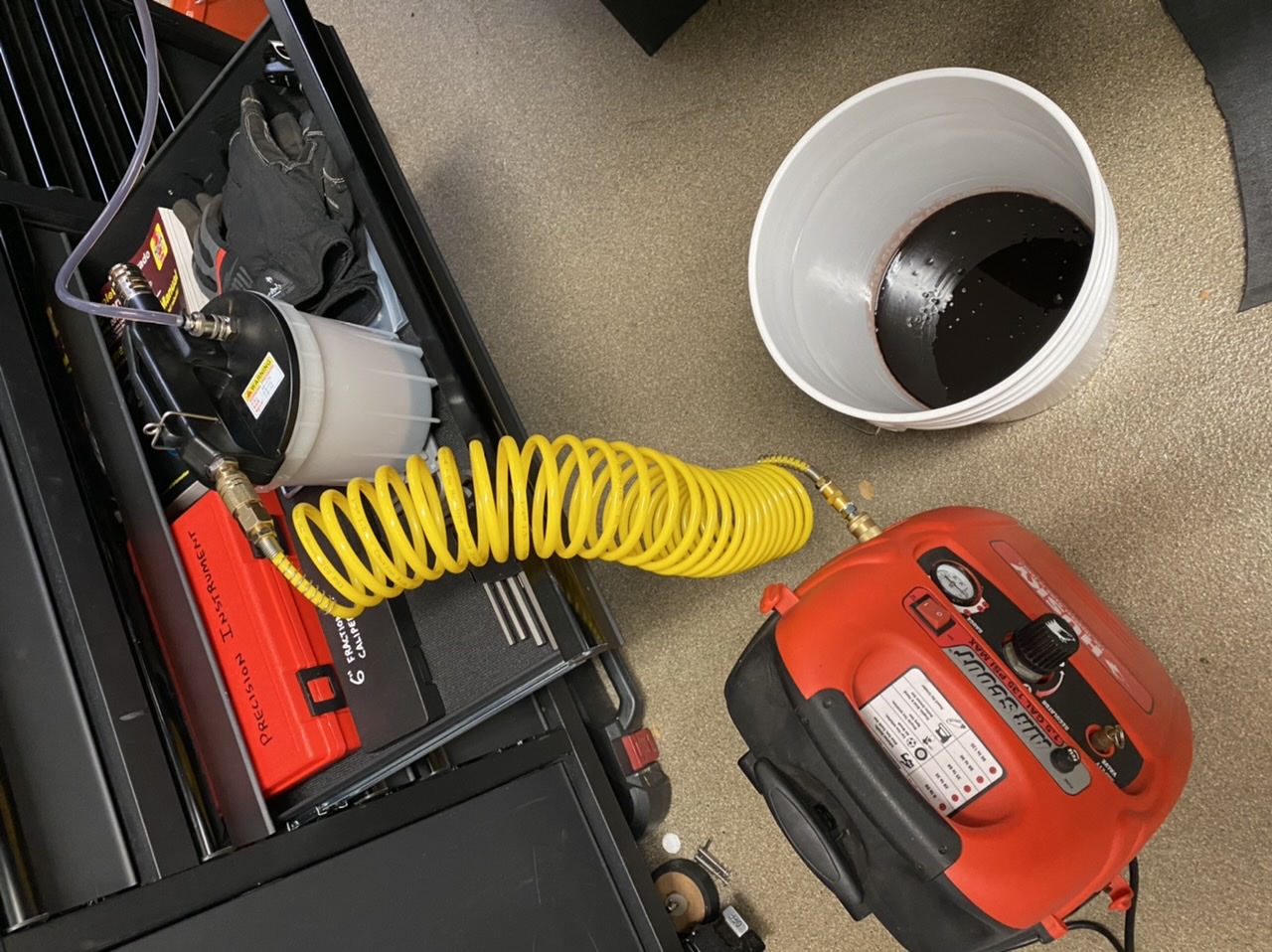

Took about 10 minutes with this small compressor (was only able to run a continuous 25-30 psi) and the Capri Tools Vacuum Bleeder (make sure to use thread seal tape on compressor fittings). A closer view of the Vacuum Bleeder...
A closer look at the hose going into the dipstick tube...
Here’s the fluid I was able to extract this method...
Next I’ll be removing the trans cooling line and starting the engine (carefully not running the pump dry)and removing more fluid before dropping the pan.
The fluid looked good. No signs of problems such as a burnt smell and although it looks completely black in the pictures there is a good pink tint to it.

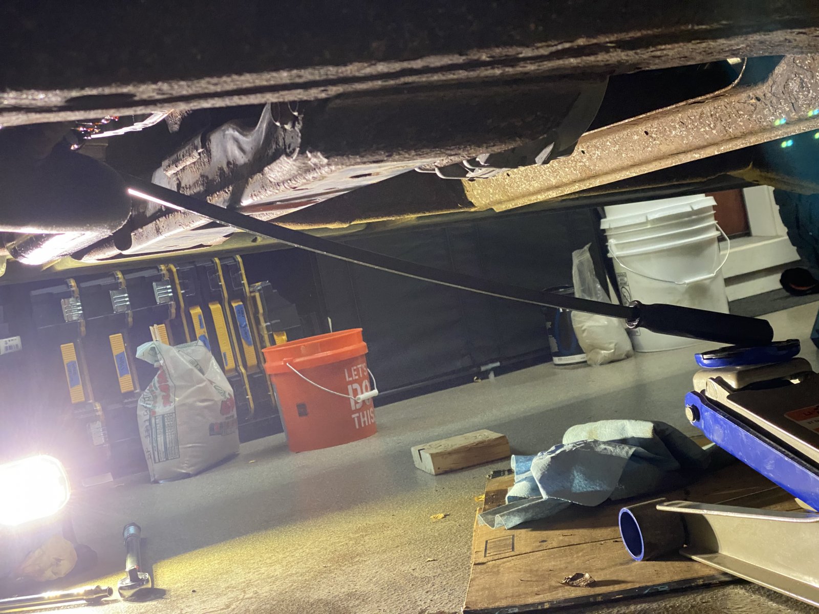

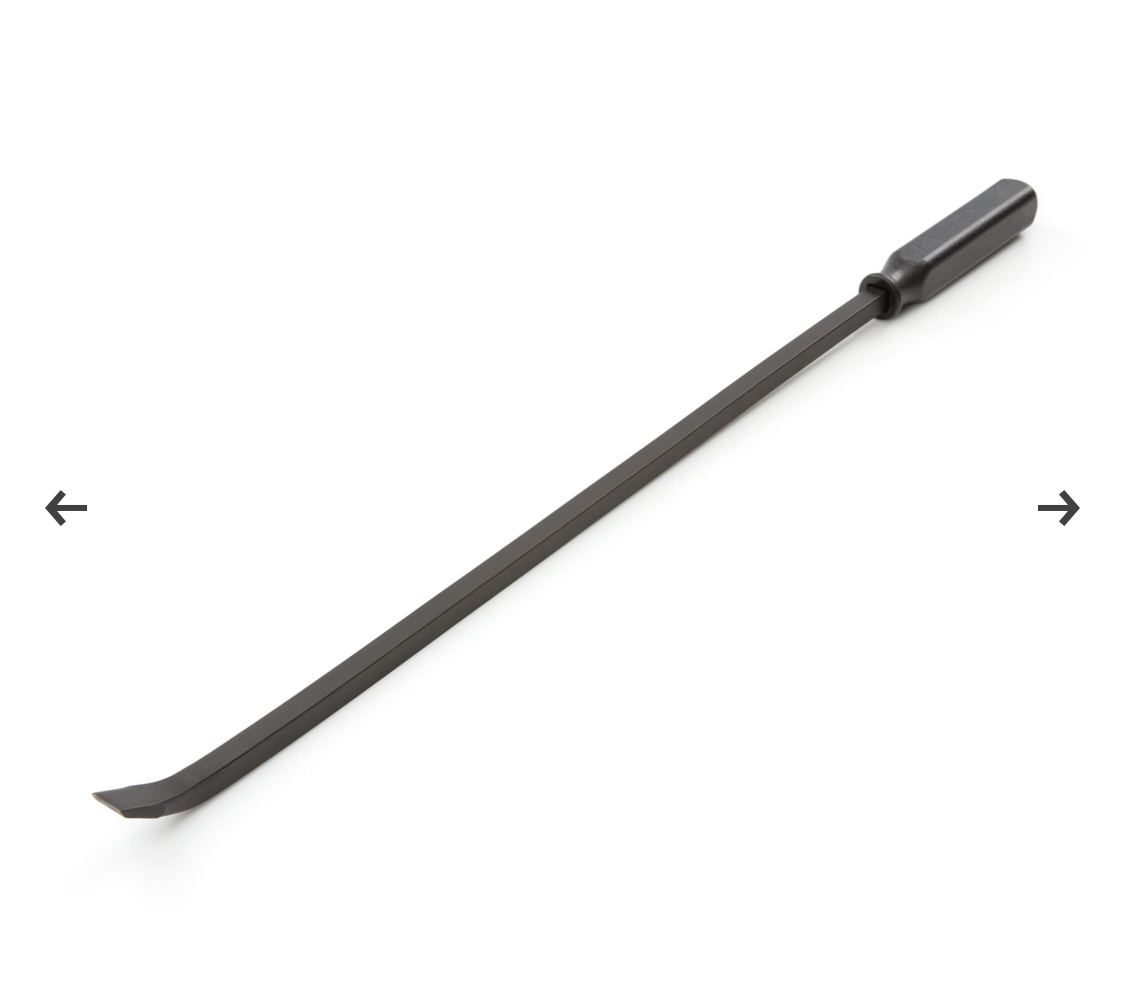

Here’s some general notes that might help someone: after sucking as much fluid as possible from methods above I then slightly lowered the pan enough to put the vacuum tube inside and sucked up as much fluid as possible before dropping the pan. I then used a 30” Tekton pry bar and a floor Jack to lower the exhaust...
Major flexing, but did the job...

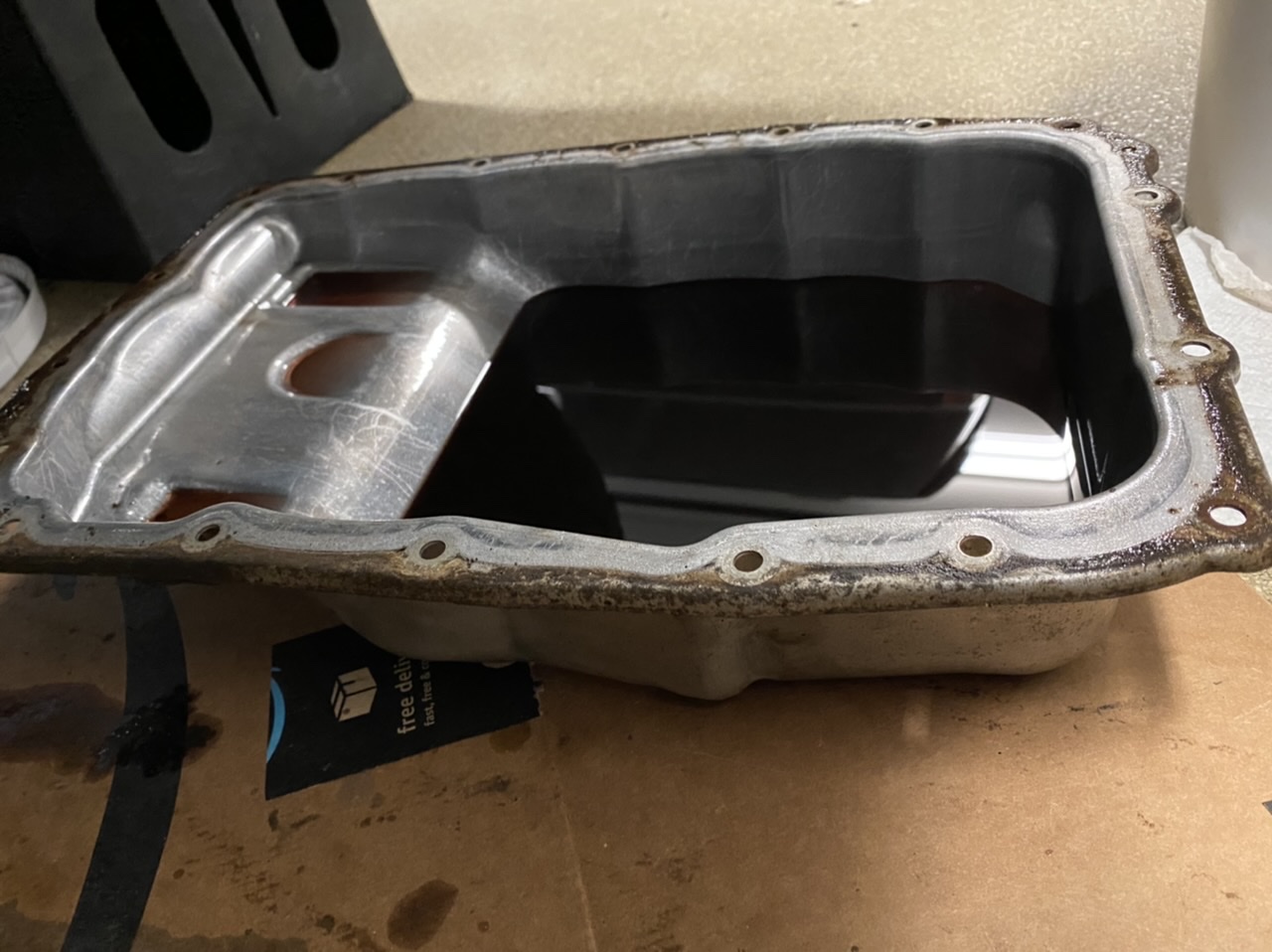

I was then able to remove the pan without spilling fluid all over the floor. Here’s the fluid that was left after all the sucking (I must have had the vacuum line on the shallow part).

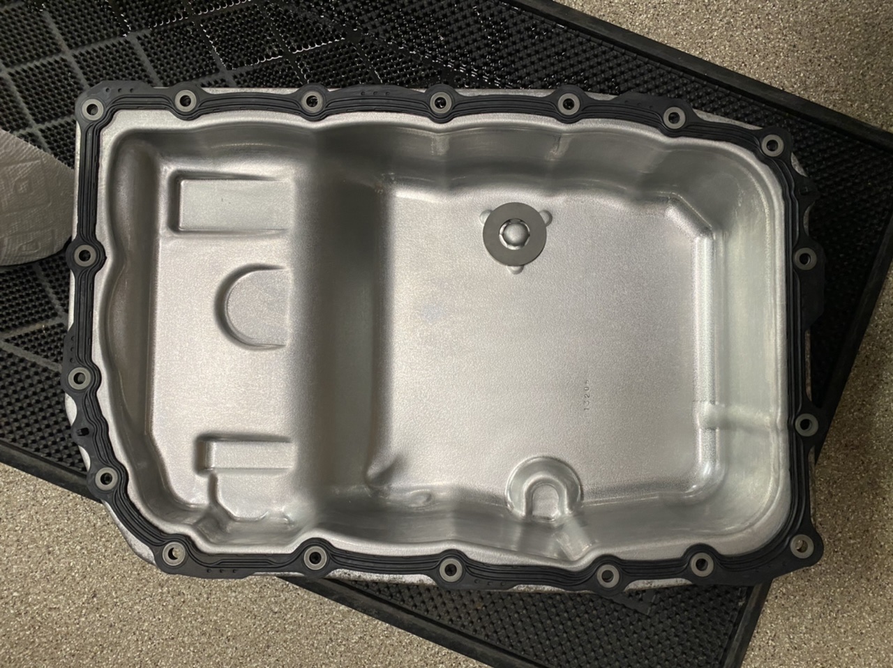

Cleaned both mating surfaces and the pan well (I had to use 1500 grit sandpaper in a few isolated areas as there was some rust buildup). Good as new!
OEM filter and gasket part number is GM 24236517
I used RPT Shift Pro Filter and Gasket part number 997709 and it matched OEM perfectly.

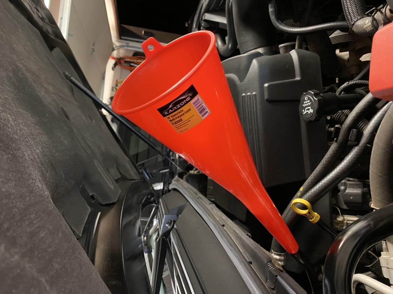

Thus far I’ve added 1 gallon of fluid using this 18” funnel as per Hayes manual and tomorrow I’ll complete the recommended fluid fill procedure.

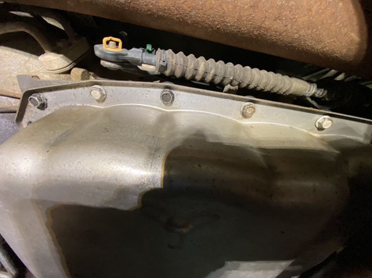

Oh...and I didn’t need to detach the shift cable as it wasn’t in my way to remove the bolts...
