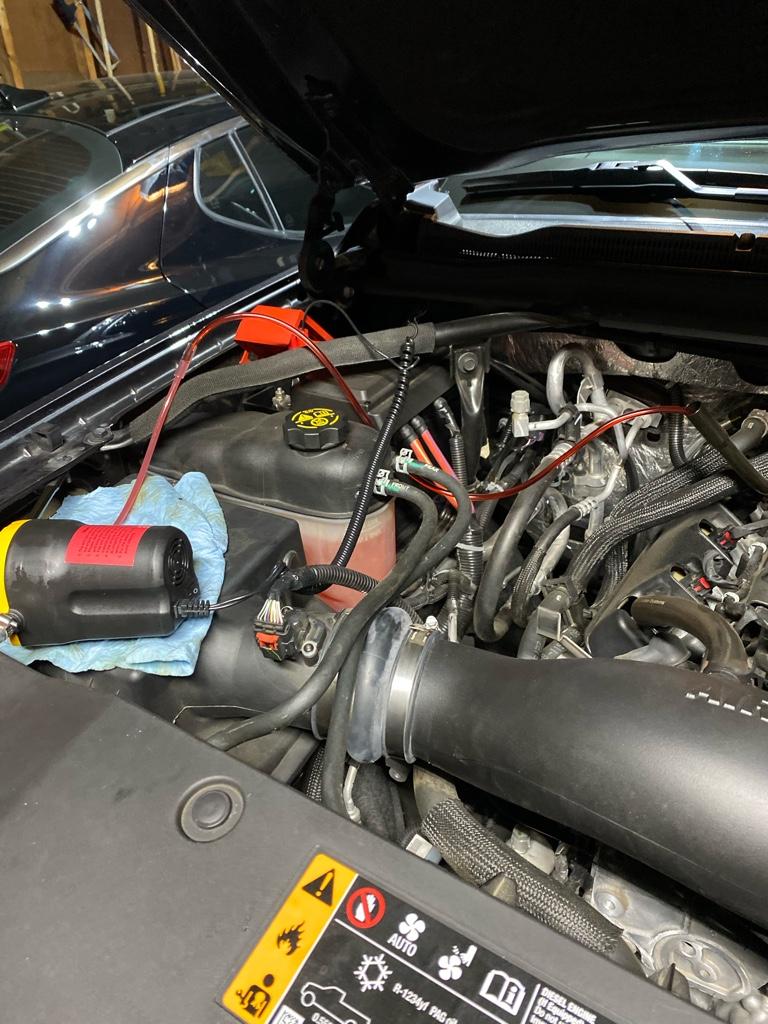

Nice work! I’ve got a 10’ hose coming that I’ll cut to length to make it to the bottom and suck the fluid out before dropping the pan. I’ll be attaching the hose to a Capri Tools Vacuum Bleeder which I originally got for bleeding brakes but have found multiple uses for it such as this:
