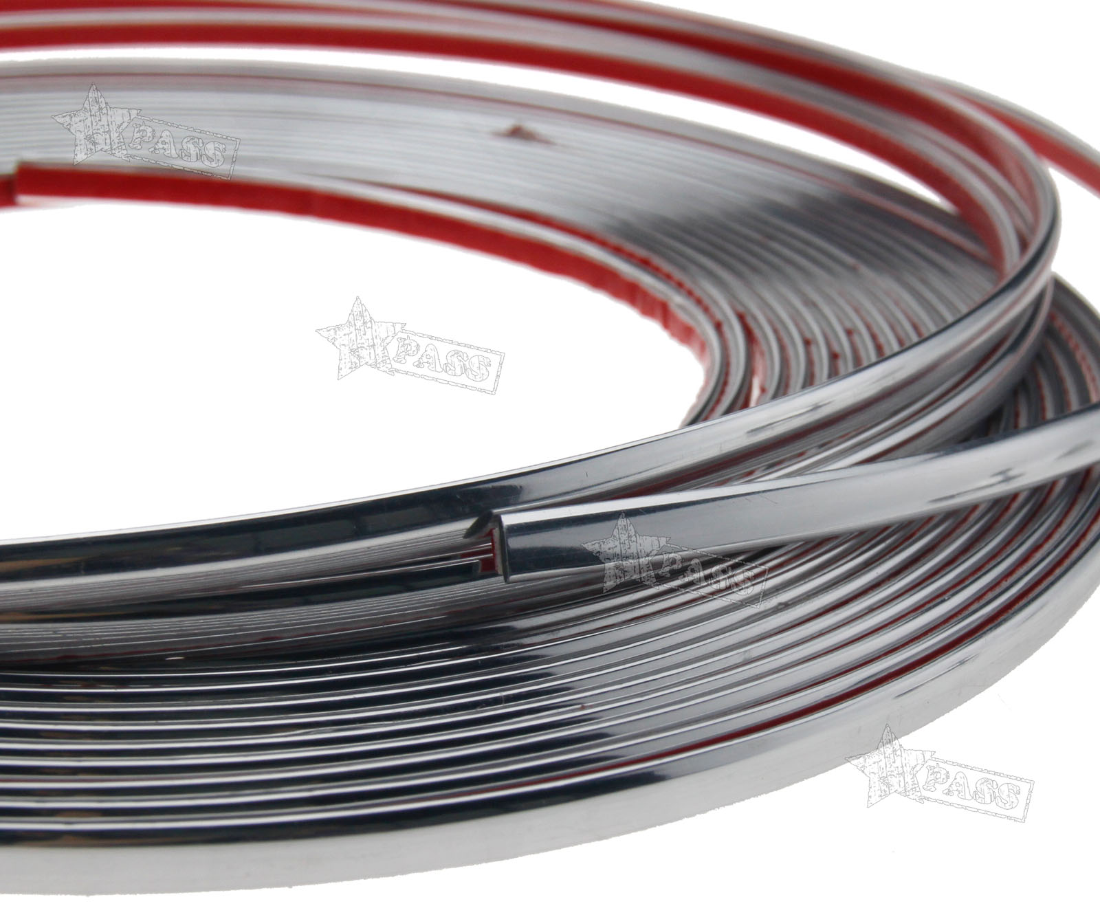

Im going to attempt a upgrade to my cluster,.. I like the esky dash but Im not going to pay $$$ for a used one on ebay, so I bought the white w/blue overlay, some carbon fiber wrap for the bezel face, and some 6mm chrome stripping for the gauge opening edges, (like the eskys). The company I bought the overlay from claims that with the stock lights in the dash it will light up "lite blue", I will try that first because Im really not a big fan of the super bright LED's. If I find the lighting is not to my liking, I will swap in some LEDs. Here are the pcs I purchased and I will follow up with an install write up as I progress,....oh,.. and some FREAKIN WARM WEATHER COMES BACK !!!!!
