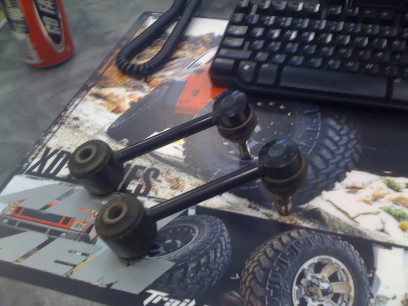

Front JK jeep wrangler end links look like they'll fit w/o issue. I'll let you guys know how they work since I have about a dozen of these things leftover from lifting jeeps. I also chopped 1 1/2" out of the stock rear links in case I have to weld em up but you can't remove the bushings and I'm concerned they will melt when welded. Pics to come I'll try getting them on tonight

Mine handles great but I'd like to have another inch off the length. They didn't fit when I dropped it 4" initially but I think they'll work well after the free travel mod and height it's at now. We'll see in about an hour.

So much for that notion, little bastards are just a hair too short and hit my panhard bracket even it I notch the damn thing. I guess 1" off the stockers is the best bet so next step is welding the ones I cut and trying again. I had hoped it would be easier lol.

I tried everything. They may have fit with the stocker but not with this big ass eibach. I'll get some of the welded links on and let you know, you're gonna owe me a case of beer and some nuggets with all the shit I keep sending you lol.

I tried cutting my stockers and tried to weld the back together and they kept breaking at the welds. Even tried to sleeve 'em amd weld the sleeves but they kept snapping. I think I know why, You say yours hit the panhard bar and I thing mine did as wellcausing them to break with the pressure.. I just went back with a stock set..
