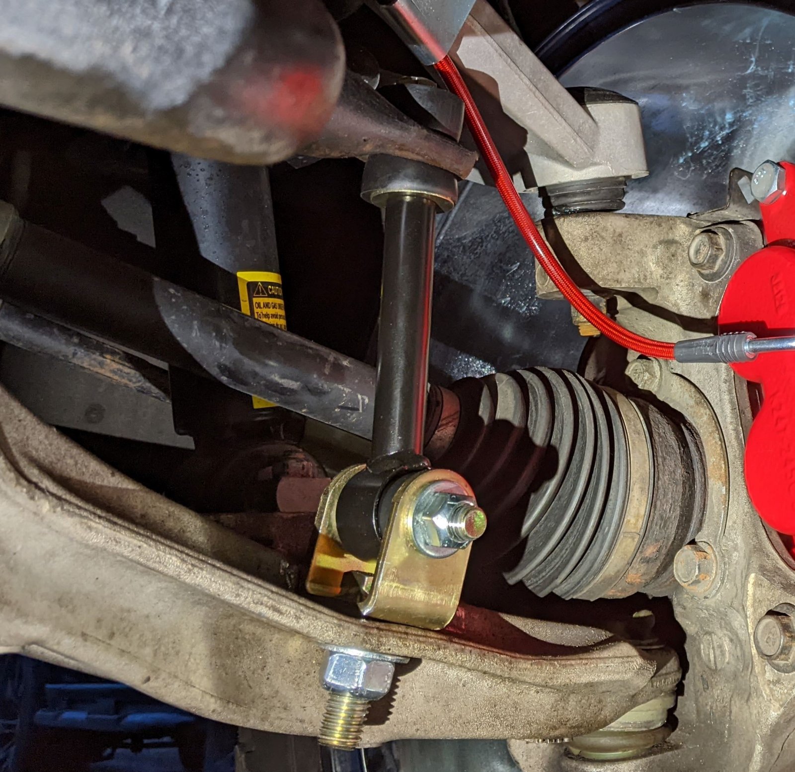

Anyone find a good fit for front and rear end links after 1.5-2.5" level?

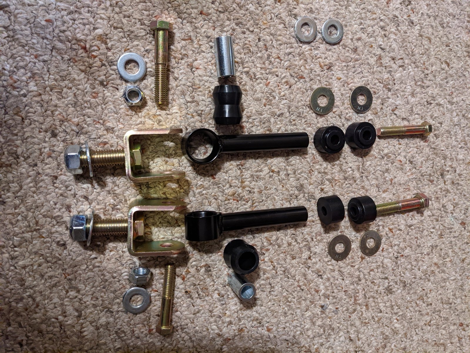

In that past I used jeep end-links but came across these on ebay (for the low) and figured I'd try em out:
Curious what others are finding out there as i'm striking out on much else.
For the front, I've used 3500 Silverado HD +1's but they're non-adjustable so still trying to find a decent set for a fair price. Let me know if any of you have found any good replacement options. If no, I may end up making my own for the front.

Ended going with the rear links above and they seem to handle well.
In front with cognito:

What's your thoughts on the rear ones? I put new GM endlinks on when I installed a Hotchkis rear sway bar. The GM ones pivot at the sway bar attach point where the ones you show are making the red bushing do all the work.

Have yet to swap the pivoting with *new pivoting rear links which leaves bias in that regard. The pivoting design seems to go against my engineering-type thinking. The bushings are where you want the stress for an anti-roll/sway in my opinion. The pivot would make sense for stability during articulation though so there may be minor trade-off there.
Of 3 vehicles I've swapped to non-pivoting; and haven't looked back. Went with the longer rubicon links which performed well with rubber bushings and later swapped into black graphite impregnated energy suspension bushings in the jeep links which made little difference. In the 05 Tahoe I went with energy suspension bushings on both front and rear sway bars and end links and later swapped in black graphite impregnated on the sway bars themselves with no real change in feel.
What I can say is going from a worn pivoting to a new non-pivoting is an instant handling improvement on the highway - no question about it. The worn pivoting style allowed the rear to wag or lean in the wind with lesser predictability and control. I do a LOT of driving among the 3 vehicles so any change is noticeable especially when looking for specific improvements. On the 2015 XL I have the stock sway bars and beat on it quite a bit through higher speed highway maneuvers, favorite on-off ramps and round-a-bouts where I can break the tires loose or dig into the turn.

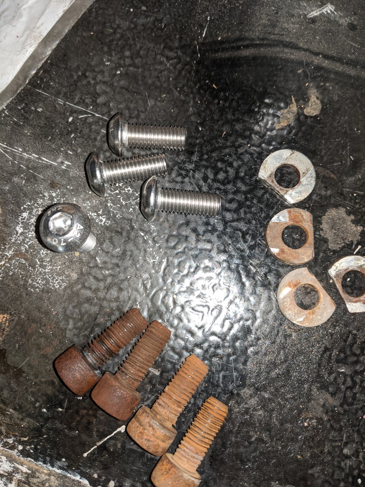

Where about's are you located? Here in MN i'm dealing with the same rust issues. For suspension parts I don't really trust chrome hardware unless I can confirm it's high-quality. Stick with grade 8 or better if possible and the zinc coated hold up to rust pretty well from my experience without sacrificing strength.
Located in Kansas. Agreed on what you said about hardware. When I looked at the Hotchkis stuff I figured it would do this but also figured they would have provided something better. Plan is to hit the hardware store and find a better product. Factory ones were pretty cruddy when I removed them to install the sway bar.
Also to note I did spray paint the sway bar bushing brackets that came from Hotchkis. They are a shiny chrome when new, but now look very dull.

If you don't find what you're looking for at the hardware store, the ones on thread 1 are $30 and limited lifetime warranty. I'd buy em again in a heartbeat. Quality pieces. Bushing can also be pressed out/swapped for something else. They adjust to the same length as the stock and you can go from there.

Went to Ace hardware and got some A2-70 Alan head chrome bolts. They are metric.

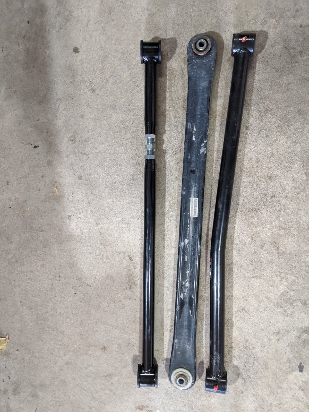

So I pulled the stock panhard bar to find the body side bushing has leaked all it's grease out. Assume it is filled with grease as the fitting and housing were all caked with dirty grease. The bushing was also free to move around, where as the axle side was still stiff.
So I ordered a QA1 Panhard Bar taking the risk that it would fit, even though it's not listed for my model year (2015+). Looks like hole to hole distance is off by about @ 3/16 inch and the bushing is about an 1/8 inch too wide. I'm not to worried about hole to hole because I can shift the axle to get it to line up unless someone says otherwise.
I tried to slide it into position to see if the holes would line up but it won't even fit into the bathtub brackets. The axle and body side bathtub fittings are too narrow, where as the stock one drops right in. It starts to go in as the fittings have a taper to them. Any thoughts? It would appear any of the aftermarket arms would have this same issue.
See if you can get a photo of that. I'd imagine you can pry them open a bit to get the replacement panhard in. Do you have a caliper you could measure the inside of the brackets compared with the new part? Thinking of swapping all the rear arms and pan hard as well.

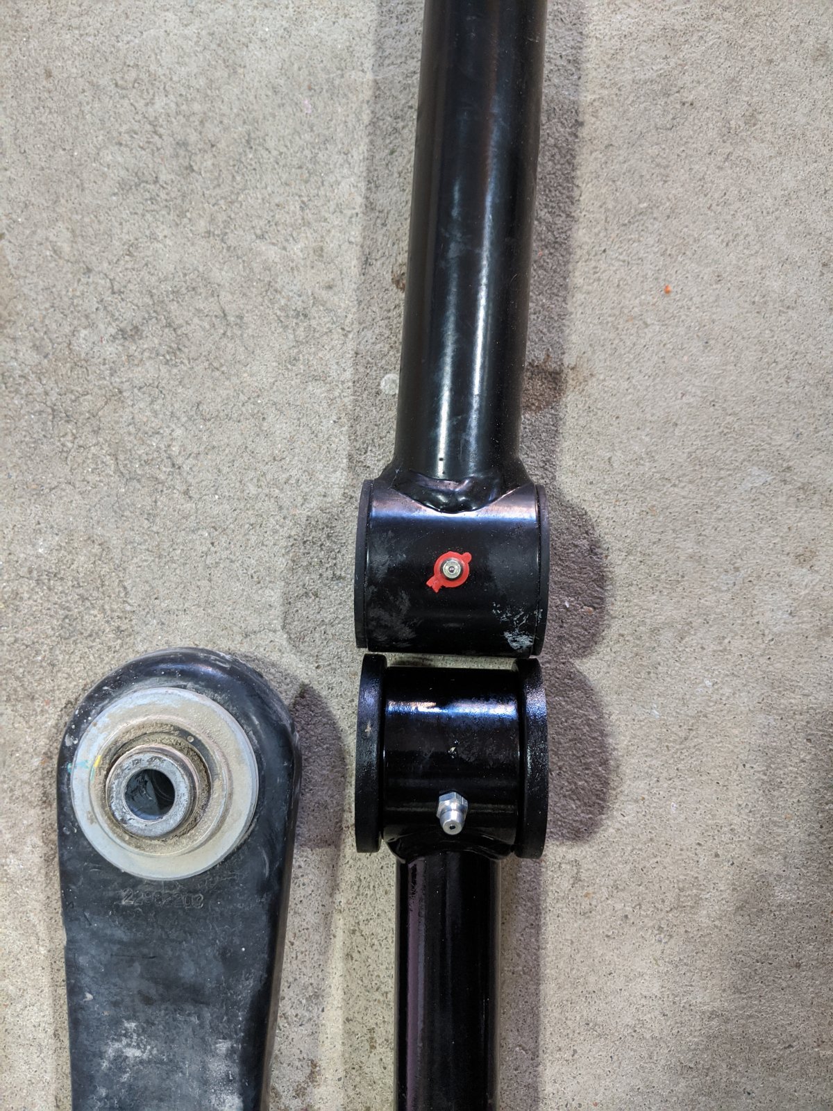

Update: I finally took the stock panhard bar off and chucked it in the trash. In it's place I installed a Spohn panhard bar. It fit like a glove.
I did compare the Spohn unit to the QA1 unit. As you can see in the picture, the QA1 unit is larger in diameter, but the ends are also wider, which was the main reason I couldn't install it. So for anyone wondering.....
