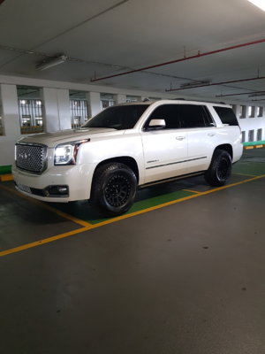

It's interesting. My Essie rides like a Mack truck with the MR shocks. My LS Suburban rides like a dream.
Bxbound7595
Jan 15, 2016
25
What size tires and wheels are you running I really love the way it looks I want my suburban Lt to look like that and how does it ride and what kind of wheels are those
