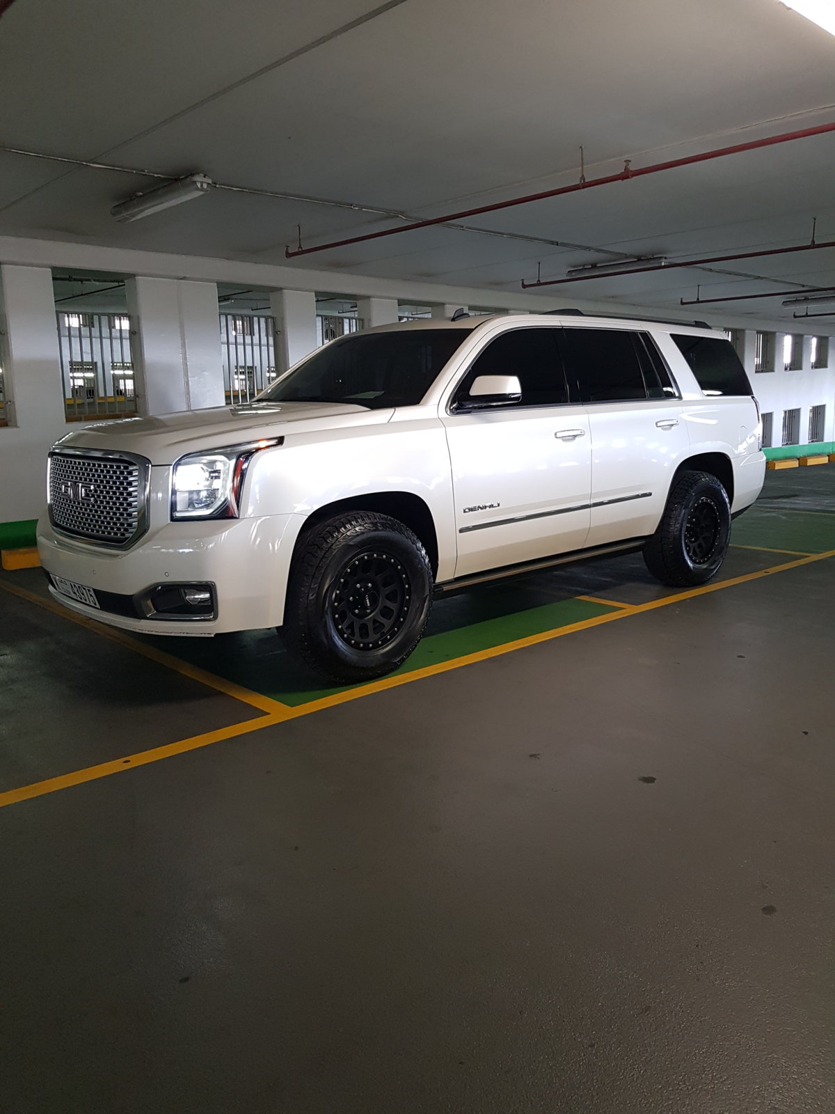

I just disconnected mine, Ride is a little better but still sucks. It does come up
saying service suspension soon. 2015 Denali Xl, lowered 2/3 with spindles.
