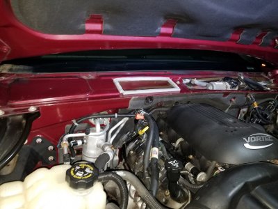

So after reading this (Thank you!), I decided to take it all apart and look. Would this cause an issue? I cleaned it up and remove the old foam and replace it with new foam. I also ran engine for about 25 minutes spraying Lysol in there about every 5 minutes while the AC was running.
I the also noticed the two torque screws that hold the cowl in place we're missing. So I replaced them with some like screws to hold it in place better. It was moving around pretty easily.

Mike, is there a musty moldy smell when the AC first kicks on? If so, there is a procedure for cleaning out the heater core under your dash. You might want to start a new thread about that and get the guys in to help who have BTDT.
