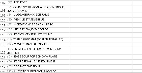

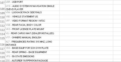

rpo code in your glove box or build sheet will tell you for sure
xl7=315mhz
xl8=433mhz

you must be missing it somehow they are alphabetically listed, see my photo post on the first page
if nothing else call your local dealer's parts department and give them the last 8 of your vin or send it to @915_Tahoe
