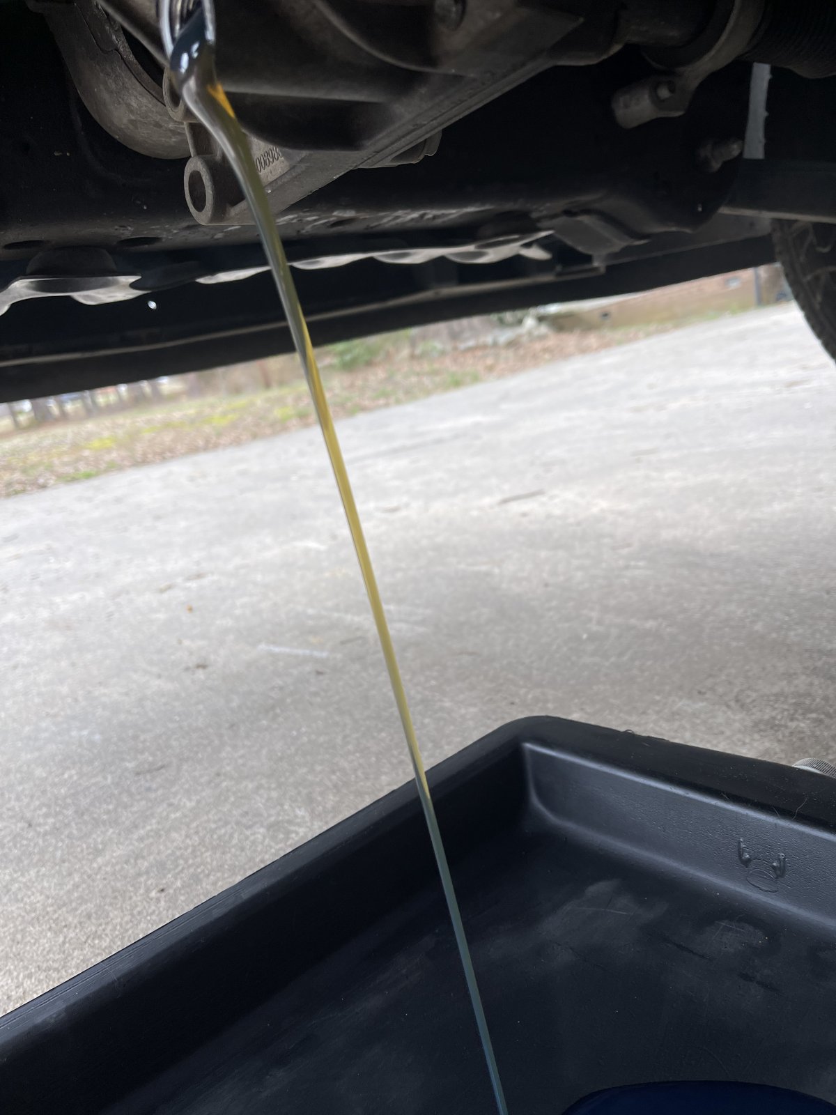

Had the Escalade up on jack stands today to rotate the tires. Front shocks are going out…another story.
It has been 1600 miles, so I drained the front differential oil.
It looked surprisingly clean and clear!
I refilled it again with mineral 80W-90.
I will do this again at the 145,000 mile oil change. If the differential oil is still clean and clear(or reasonably so), I will refill it with Mobil 1 Synthetic 75W-90.
I feel a little better about this front differential now after seeing this oil.
