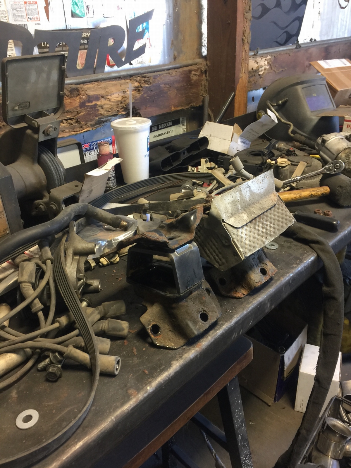

I sent my pics to a buddy of mine who happens to be the same guy who tuned my truck. This is what he sent me. We discussed this issue when he tuned my truck. It like where’s Waldo with all the clutter! Haha!

I don't really like the idea of a solid mount. The vibes from the engine transferred to the frame and cabin are one thing. But the shocks from hitting sharp bumps are only absorbed so much by the suspension. The rest are transferred to the frame, which the engine block is now essentially a part of. I just think that's some excessive forces to be put on those 3 or 4 bolting points. It might take some hardcore off-roading or really hard street driving to crack an engine block, but shit happens.

I don't really like the idea of a solid mount. The vibes from the engine transferred to the frame and cabin are one thing. But the shocks from hitting sharp bumps are only absorbed so much by the suspension. The rest are transferred to the frame, which the engine block is now essentially a part of. I just think that's some excessive forces to be put on those 3 or 4 bolting points. It might take some hard core off-roading or really hard street driving to crack an engine block, but shit happens.
Good point. I beat on my trucks pretty hard. Like you said shit happens! We shall see....

What we did with the Buicks was to add a turnbuckle between the alternator bracket and the upper control arm bolt giving it just enough slack to move some but not enough to bust the driver's side mount and transmission mount which we did quite frequently.
I wasn't worried about my mounts but since the Black Bear tune, when the truck downshifts back into first such as when coming out of a u-turn the whole front end lifts up as the motor spins towards 6,000 rpms. After doing that tonight my tranny made some funny bumps/shudders as I slowed to the next light and it was down-shifting back to first. Didn't do it again though.
