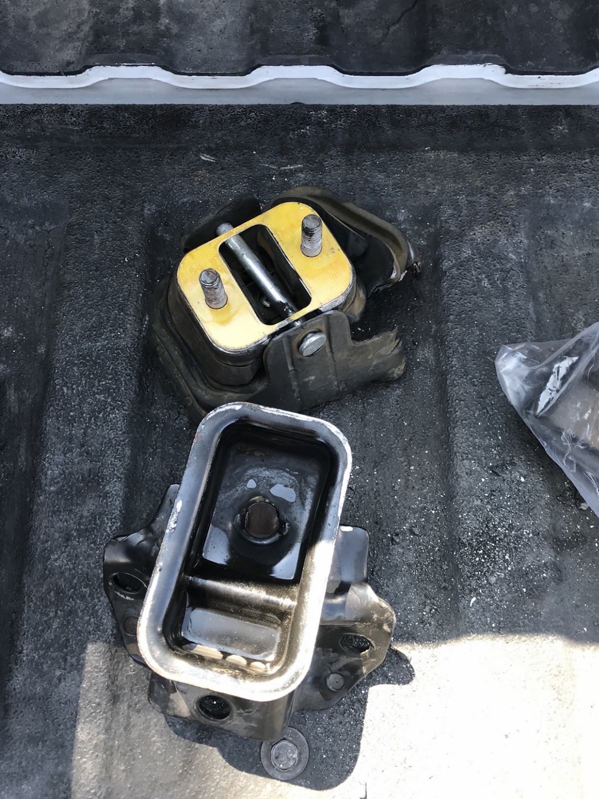

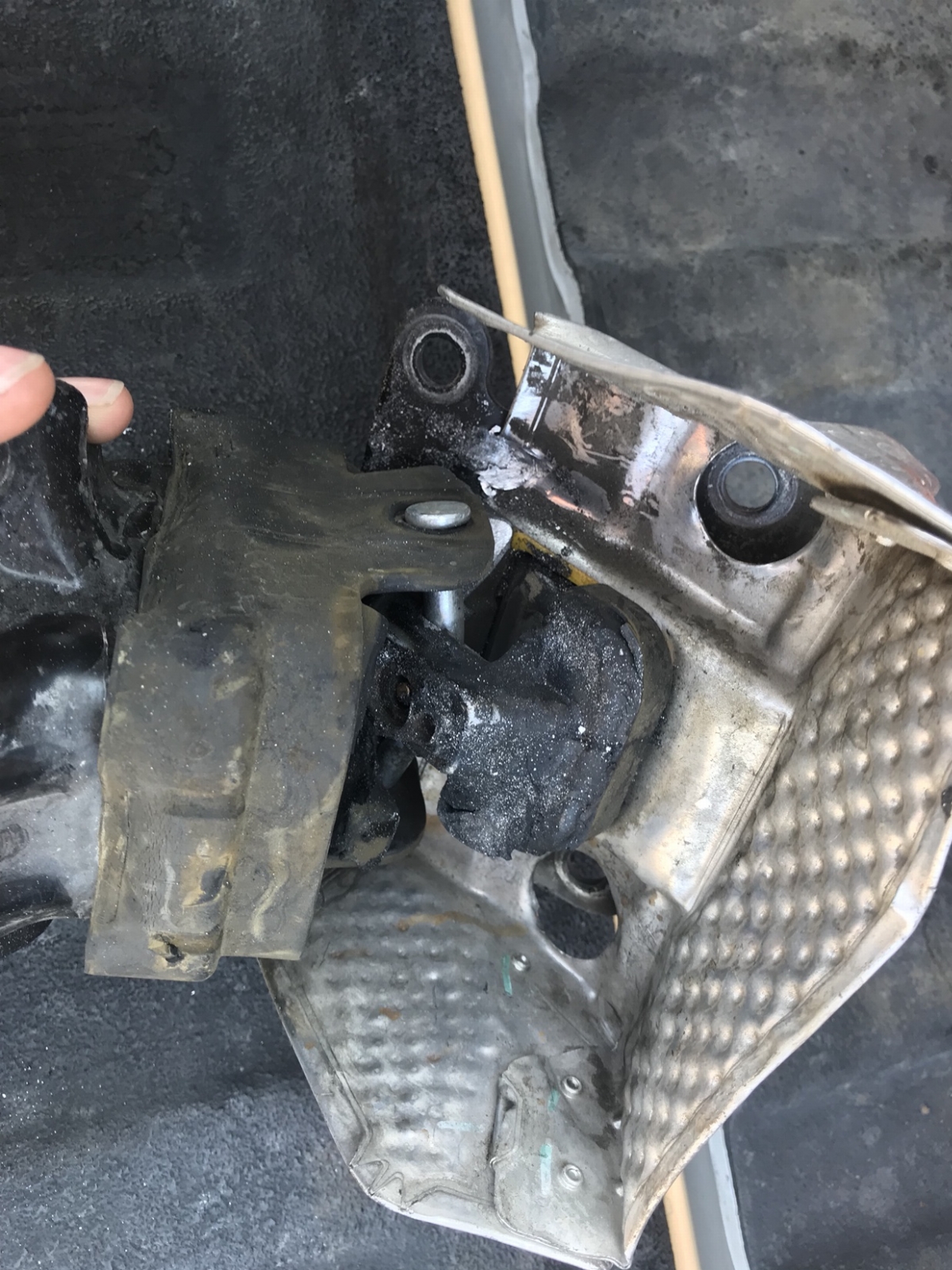

So I replaced the mounts in my Denali when I first bought the truck. They lasted less than a year. I wasn’t going to replace them again until I found a fix.

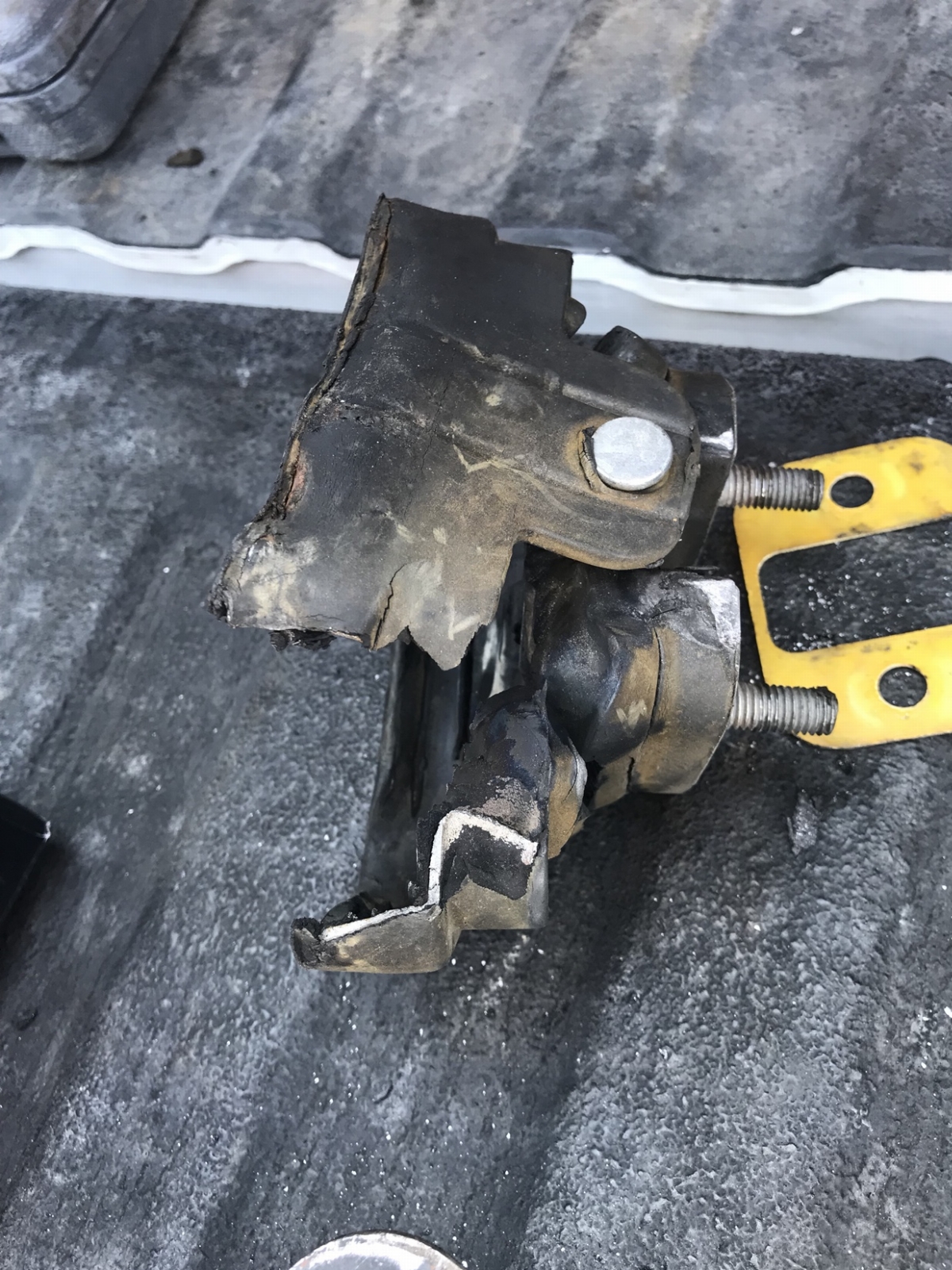

I may have let my motor mounts go a little longer than I should have.
On to the carnage and solution.
Driver side
Passenger side

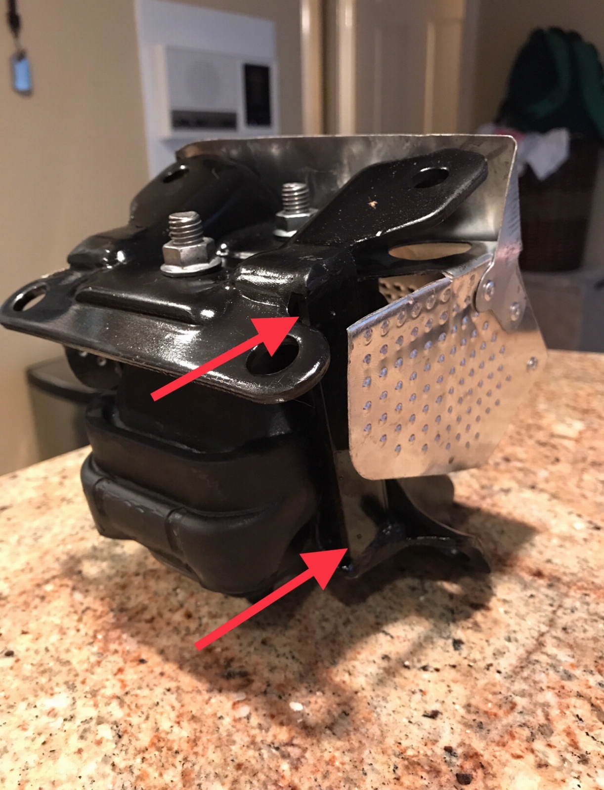

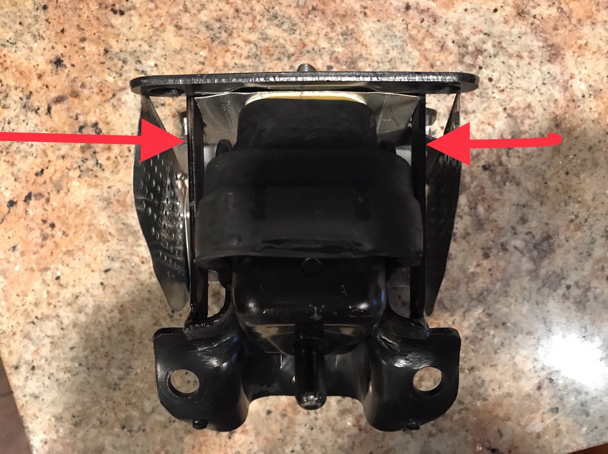

Solution. I first notched the heat shield. I then took two pieces of 1/8” x 1” strap steel and welded it to the bottom crossmember bracket and the bracket that bolts to the block. I sure hope this works cause the Suburban we bought a few months back also has broken motor mounts.

The point of failure is the rubber. Too much flex. This is a picture of original mounts that I replaced first.

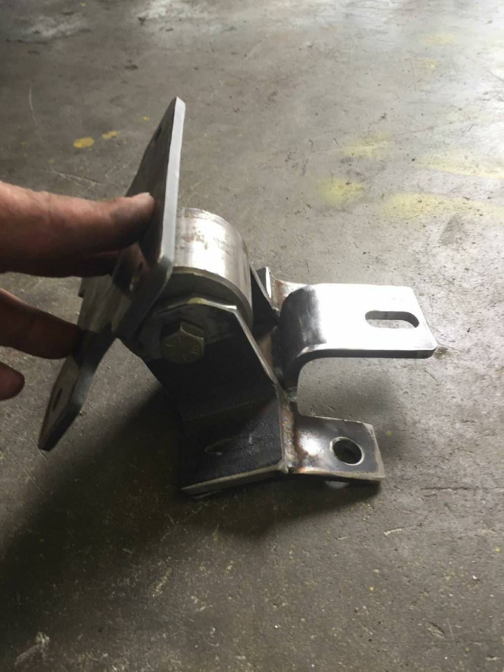

Here is a solid mount a member on another forum made.

The mounts are hydraulic, so they're basically oil-filled balloons. This is great for damping the vibes when running in 4-cylinder mode, but insufficient for the engine's torque when moving such a heavy vehicle. Trucks that tow tend to break the mounts much sooner. Over time, the rubber hardens so it isn't as flexible/elastic and it cracks. The fluid leaks out so now there's just a small amount of dryrotted rubber acting as the cushion which is hugely insufficient. This rubber is easily and excessively stretched and squished constantly from the engine loading and unloading, so the hard parts inside the mount are able to wallow themselves out some wiggle room. Eventually, there becomes a void where it's just metal on metal and the halves of the mount are like two links in a chain hanging freely then being abruptly pulled taught every time the engine torques.

The flat bar that he welded in solidly connects the two halves which makes it rigid mount. The rubber between the two halves isn't doing any cushioning, it's just "there".
