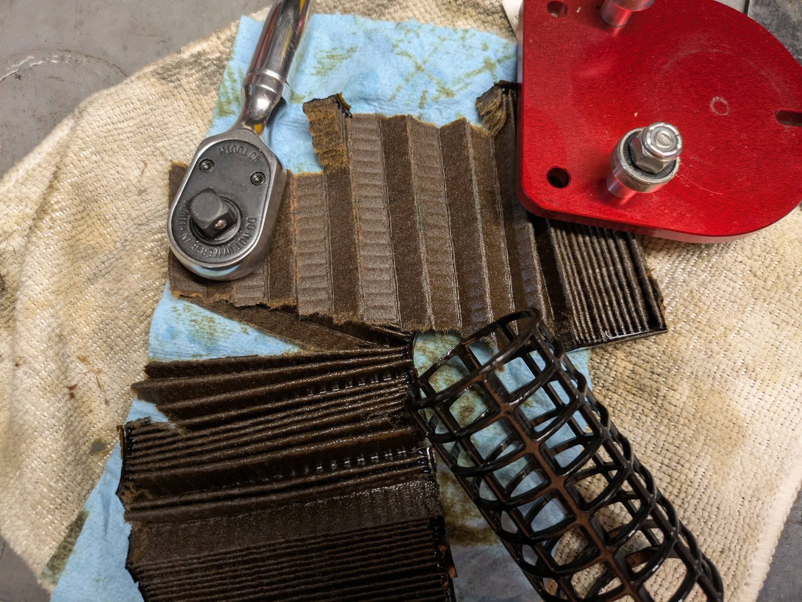

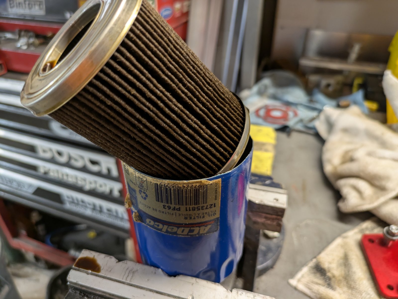

2024, 0w-20 was changed once during initial service at 7500 miles. At 10k now.
Swapped out the lighter fluid for real oil yesterday. Cut the filter open so I could sleep at night. Happy to find nothing in it.
Took an oil sample and sent it off to Lake Speed for wear analysis.
So you only had 2500 miles on the oil you sent in? Would be real surprised if they find anything bad at that mileage.
