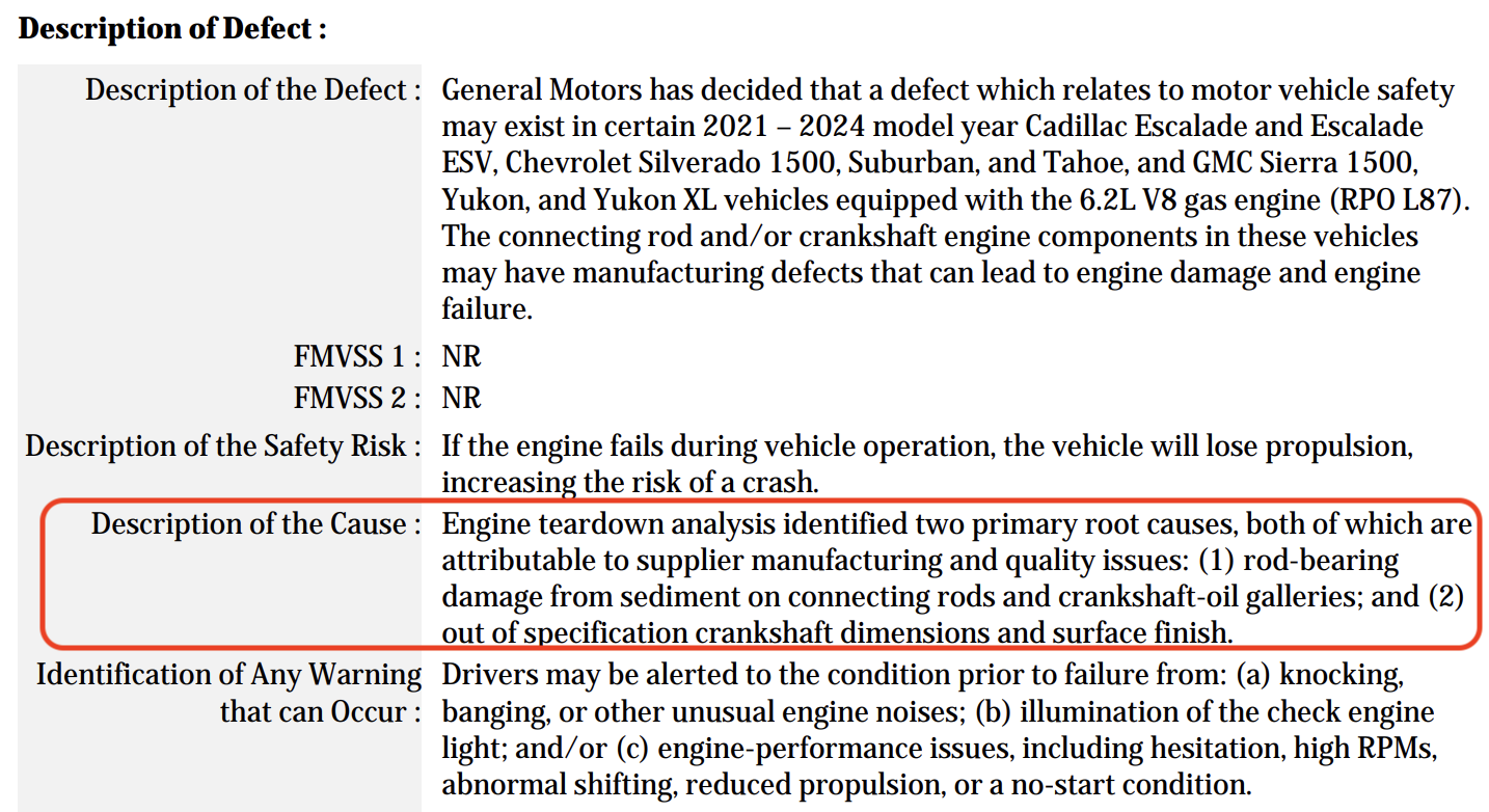

we know more than that. GM stated in the safety recall it has 2 root causes:
1) Rod bearing damage from sediment on connecting rods and in crankshaft oil galleys
2) Out of specification crankshaft dimensions and machining
See here.
Let me make it easy for you all, page 4
It is not that difficult to imagine journals out of tolerance causing this...
