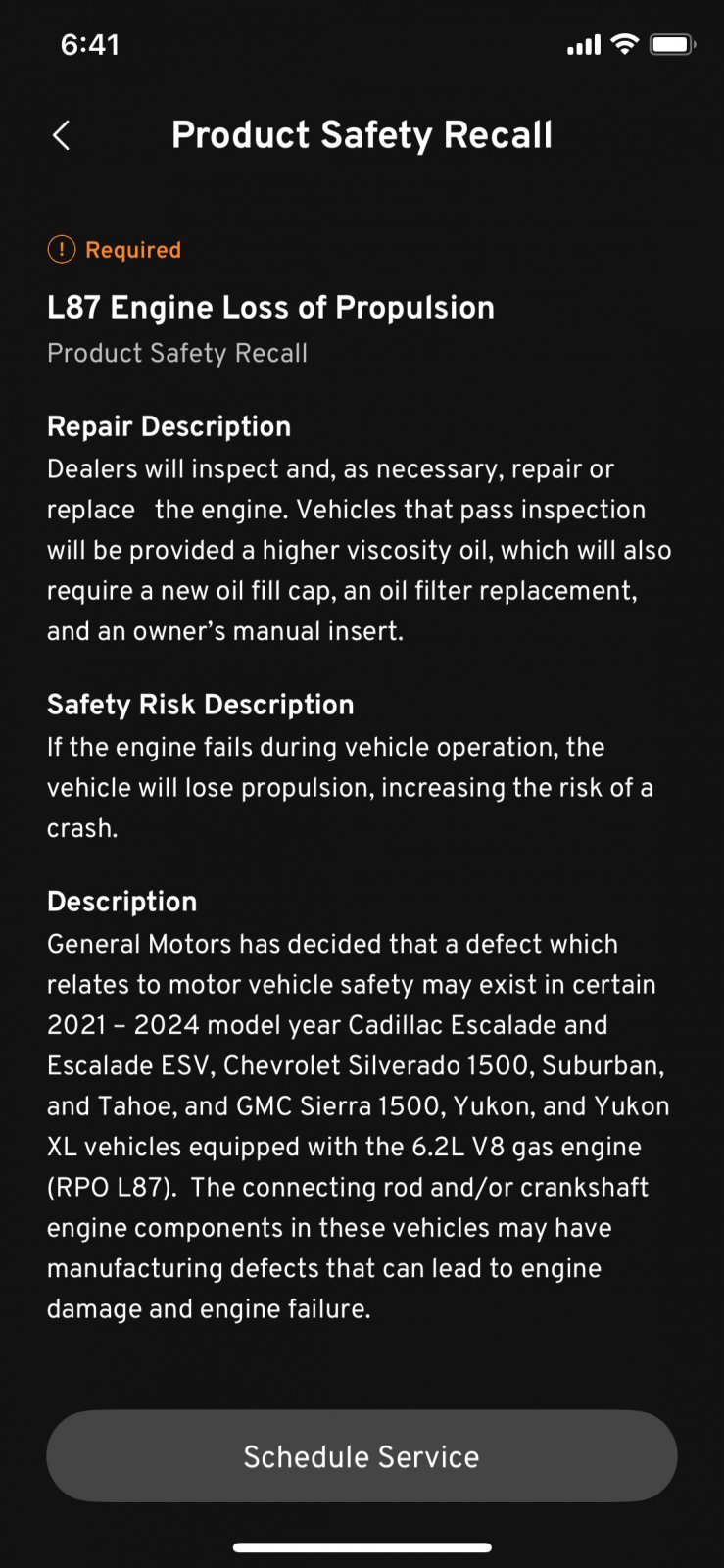

General Motors has decided that a defect which relates to motor vehicle safety may exist in certain 2021 – 2024 model year Cadillac Escalade and Escalade ESV, Chevrolet Silverado 1500, Suburban, and Tahoe, and GMC Sierra 1500, Yukon, and Yukon XL vehicles equipped with the 6.2L V8 gas engine (RPO L87). The connecting rod and/or crankshaft engine components in these vehicles may have manufacturing defects that can lead to engine damage and engine failure.
Safety Risk Description
If the engine fails during vehicle operation, the vehicle will lose propulsion, increasing the risk of a crash.
Also, just got this notice for my Yukon from Carfax Car Care.
One interesting thing I noticed is that GM is now recommending 0W-40 instead of 20. We were right.

thanks for posting.
glad Gm is stepping up .
The p0016 code is interesting . I am curious how that relates to the manufacturing defect they are generically referencing.
Is the crank key way some how off a few degrees?
Either way the 0w-40 is a dead give away that the low engine speed load on the bearings are way too high.

Looks like they are not technically recalling all engines but rather, doing an analysis to see if an engine qualifies for replacement. Either way good to see them following up with an acknowledgment of the issues. The annoying part for me is if this is progressive damage from using the wrong oil viscosity, then the damage is done to most engines and all should be replaced.

Been watching this for almost 8 hours today.
Still not convinced it is not a late April Fools joke or someone testing their Abode skills.
Nothing on the NHTSA web site at this point in time.
NOTICE the oil shown in the picture, it is NOT DEXOS Approved!!! But ask me what I am running in my engine!!! If has a decent high Moly content.
I have been saying since day 1 to dump the 0W20 oil. My truck had it for only 500 miles, then went to "real" oil!
0W20 is almost fine until too many remote starts and idle warm ups contaminates the fuel to the point you are lubricating with a solvent rather than oil.
The 6.2l behaves like a Diesel and with the AFM trying to turn the rotating mass with a single cylinder, what do you expect.
We will see what pans out over the next few days if this is real or someone having fun.
Want your 6.2l to live long, do not use 0W20 oil and change the oil at the 50% OLM. DO NOT WARM the engine up at idle, it takes the engine oil almost 30 minutes of DRIVING to get up to temperature below 40F ambient.

It's real. I took a used 6.2L Suburban High Country for sale on Cars.com and punched the VIN into the GM Recall site.
You have been completely vindicated in your stance on this topic. I know you took a lot of flak from other forum members saying things like "IT HAS A VARIABLE DISPLACEMENT PUMP!!!" "IT WAS DESIGNED TO USE 0W-20!!" "THE THICK OIL WON'T FLOW AS WELL AND STARVE BEARINGS OF LUBRICATION!!" "YOU'RE GOING TO VOID YOUR WARRANTY!!"
None of that was true. GM pushed the engine as hard as they could, strictly for the purposes of CAFE credits and got burned. This is a giant egg on their face and the others that defended the 0W-20 debacle. As mentioned on another forum when warranty $$$ is > CAFE credits = Recall.
