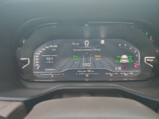

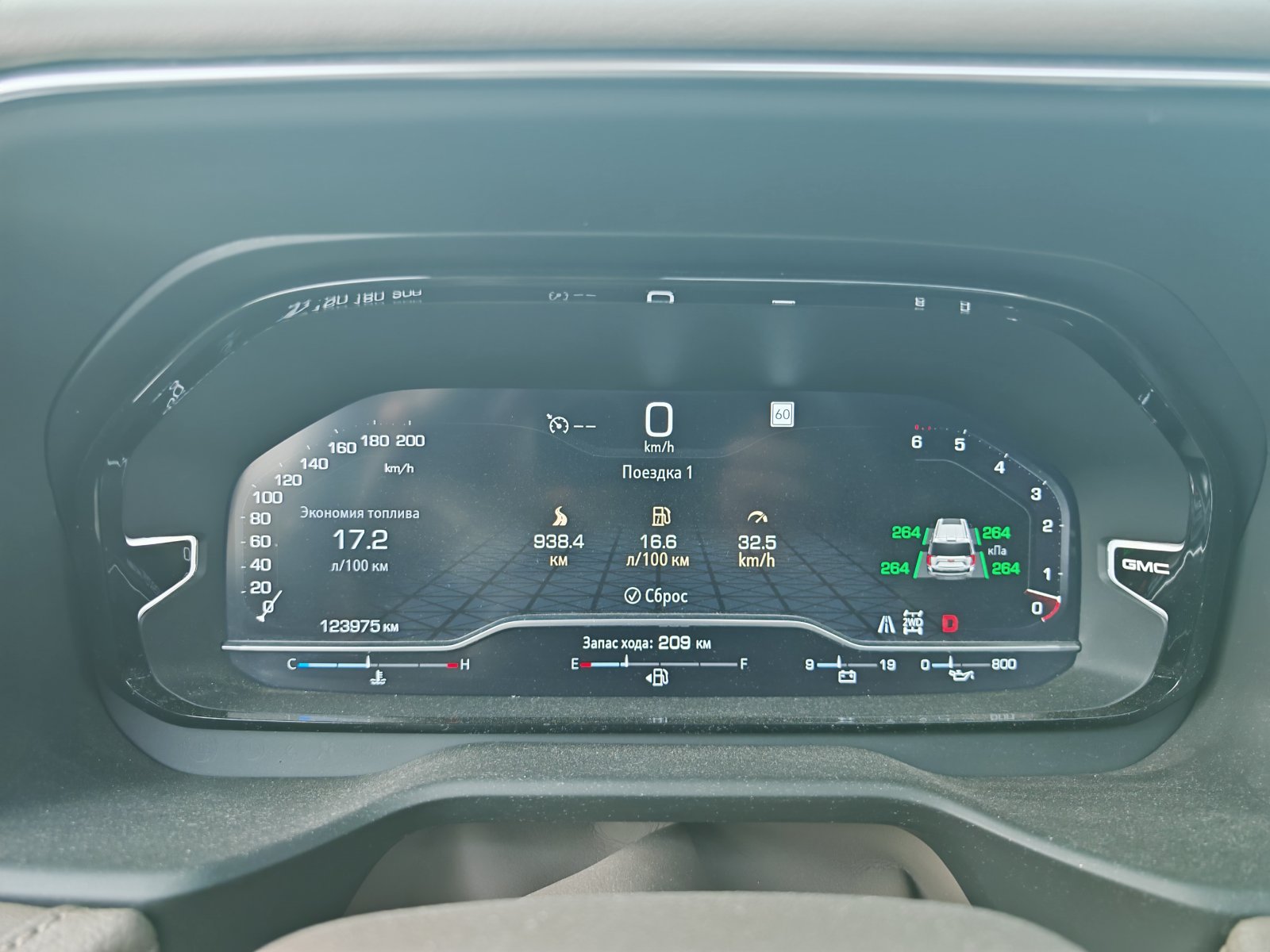

I drove 700 miles on 0-40 oil during the run-in, after which I filled 0-20. It seems that the version that it is necessary to pour oil 0-40 is confirmed, at 0-40 the pressure is high, and at 0-20 it is about twice as low. Do the photos confirm this? :) But no, fans of this movie, :) it's not that simple) after running in, I filled in exactly the same oil that I used to drive 75,000 miles on my previous engine, this is the oil from the Belgian company Wolf 0-20 dexos. Why did I fill in 0-20 anyway? I talked to the Service that made this engine for me. Everyone they made an engine for runs on 0-20 oil, and the mileage on the new engine is already high. So, they poured 0-20 oil on me, I rode a little, warmed up, drove along a small section of the highway at a speed of 70-80 miles per hour, and that's what my oil pressure is 0-20. Wonders. it is about 300 kPa. I'll even post a photo of the oil pressure 0-40 and 0-20 next to it))) at 0-20 it's just a little lower. well, about 300 kPa at 0-20 and maybe 320 kPa at 0-40. My opinion is that either the software has changed and GM has increased the oil pressure, or this is a new modification of the oil pump. But oil has practically no effect on pressure. The pressure on my new engine is clearly higher than on the previous one.
