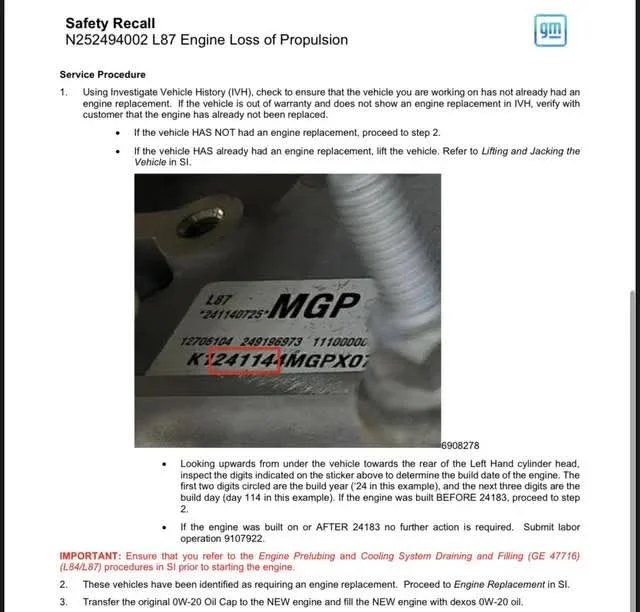

Put a bit of a jack on it. Slide under on drivers side, get comfortable, and look around driver side, aft end of motor. It’s up between two sides you can only see it at an angle. I was able to read without taking a picture. Like I said, get comfortable, it’ll take some snooping around.
I have have two stickers also around the headlight areas. I believe this date is the final assembly date. Mine said Mexico, I assume fianal assembly Mexico?
Blackcar
Mar 31, 2018
920
863
Right the engine build date wouldn't be by the headlight it's on the driverside head on the rear and can be a real PITA to take a picture of it.
Engine build dates are typically 1-2 months before vehicle build date.
This image and shows location and how to read date code

It is hard to take a picture. I couldn’t do it, but with a flashlight I could read it. Mine was K1220072jw4x3162. Car wasn’t sold until late 2022. Engine was built January 7th 2022.
Blackcar
Mar 31, 2018
920
863
Looks to be built 2022 and 72 day of year if I'm reading tag correctly
I believe your right 007 is correct.
Kaminski
Aug 25, 2024
19
29
Maybe. I’m not sure if it is day 007, so 7, or 0072, so day 72. ‍Either way, seeing Vlad’s stock engine replacement condition, not really happy it sat so long.

Manufacturers typically use Julian dates, this is what the date code is on the engine tag. The Julian date is preceded by a letter and then a number, then the Julian date is the next 5 numbers starting with the 2 digit year and then the day number for the calendar year. Sometimes Julian dates may have a Shift Code before of after the Julian date and sometimes if a build date date group there may even be a Plant/Factory designator as well.
GM does have pretty good records based on my read. While the recall pretty much states it includes the 2024 models, they indicate the engine build date is really the governing factor.
My 2024 VIN has not been recalled, I can confirmed I checked by engine build date a while ago and the engine build date is July 15, 2024 so the engine is outside of the "problem" window.
My vehicle build month is 8/2024 so I assume the engines take approximately 2-4 weeks after the build date to be installed in a vehicle. Not months. So if you have a July 2024 build date, you may be lucky to have an engine build after July 1, 2024. If your July 2024 build vehicle is not been recalled, you are hopefully safe. But only real way to confirm is check the tag on the rear of the driver side cylinder head. I you have a Z71/ZR2 or an AT4 you probably have a skid plate blocking an easy view. If you have a borescope camera you might be able to use this to read the tag rather than removing a skid plate?
if you VIN has not been recalled, there is a pretty good chance your engine was built outside the "problem" window based on my situation.
