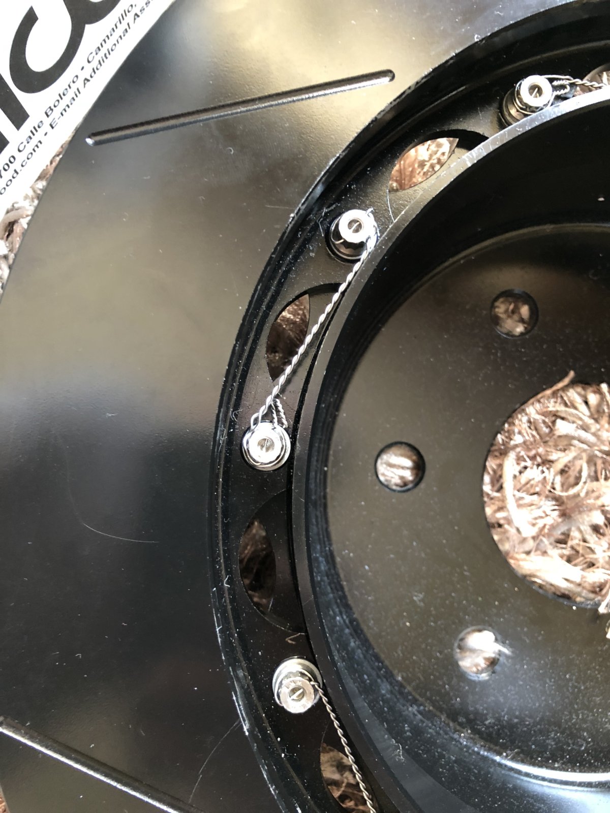

I’ve got the Wilwoods as well. Fronts are installed and backs are waiting for the safety wire tool to be delivered so I can secure the hat bolts. Love the fronts so far. Big improvement over stock...especially if you actually have to use them.

I did the Wilwoods BBK as well and when I saw the instructions for using safety wire I got ahold of them. They told me they had to do that because the brakes are race rated and that's a track requirement. For the street, you can just loctite and torque them. Just an FYI in case you get frustrated trying to wire them. You can ask Wilwood yourself if you like. Safety wire will only keep the bolts from falling onto the street or track, they won't keep the bolts tight. Nothing else on our trucks has safety wire lol.

Good to know. Actually Great to know. Ordered the tool (which I’ll likely never use again) and started last night. One rotor and hat done last night. Might as well finish the other one today. It’s fun to tinker.

Definitely can’t do it without the tool. I messed up a couple of times. It’s not perfect but should do. Glad to know it’s not do or die if they’re not perfect .

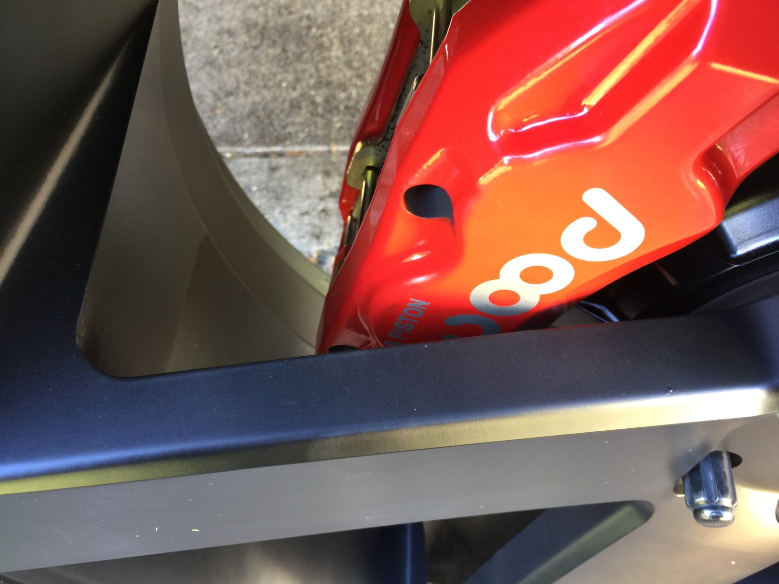

Do these BBK's fit the factory 20"x9" 5 spoke factory wheels?
The minimum wheel size is 20" but you need to look at the diagrams and measure. I know it depends on the design of the wheels as to whether the caliper clears. Sometimes it's not the diameter that's the problem but the spokes. My 26" Dubs are closer to interfering than are my 22" reps. Wilwood's website has diagrams with dimensions you can check.
View attachment 199914 View attachment 199915
I agree with everything Rocket Man said in regards to braking performance. The only thing I can add, which is subjective, is the braking “feels” more mechanical. Not as soft and cushy like stock, but more like you can feel the pads making contact with the rotor under your foot.
