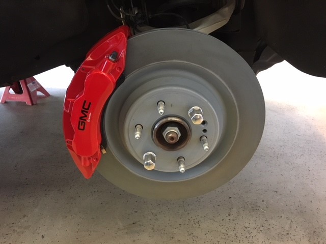

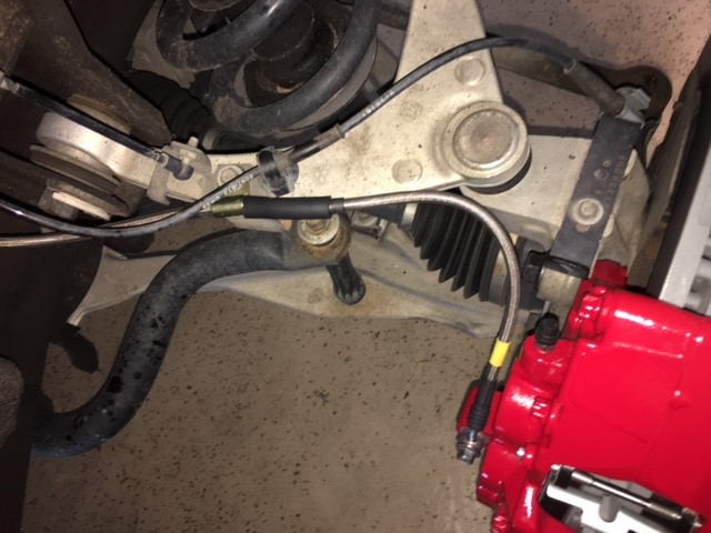

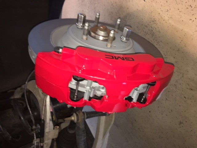

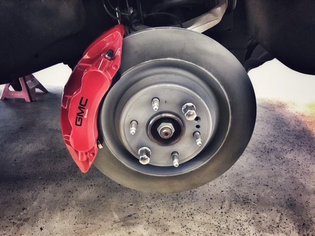

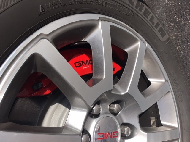

HI - Just installed the GMC (GM) Brembo kit this past weekend. Easy install, and much, much, much better stopping over stock 14" rotors and calipers. I also added braided lines (Not included in the GM kit)
Here are some photos

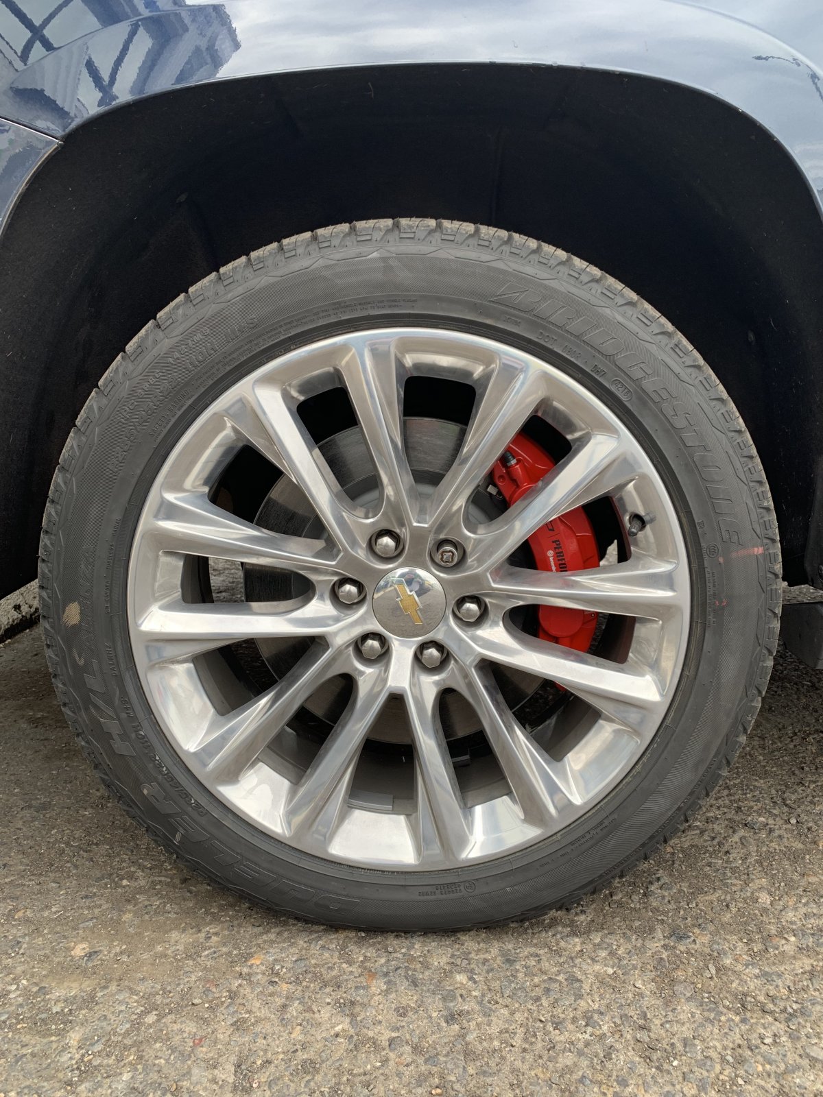

Just installed the Brembo GMC kit on my Denali. Very easy except for getting copper washer off of brake line bolt. Just breaking them in, so I haven’t tried any hard stops. Shop around, you can find this kit for just over 2k. Tried finding a Denali with this option back in May when I bought my 18 but none were available. Option was around 2800 so it was more economical to add them myself. I still have old rotors and calipers as well.

Photos?

Cool. How much? They only offer on the front right?
Yes, only the front. Given the front/rear weight distribution of the Suburban the rears don’t do all that much.
I think they were about $3000 after installation. I also did the exhaust and front air deflector at the same time and it was about $5000 all together.
