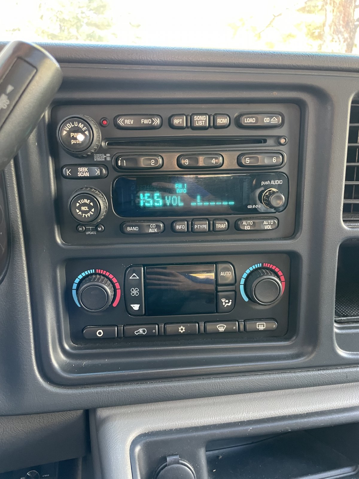

I have a 2003 suburban z71 with factory 6 disc in dash cd receiver. When it’s colder than 50 degrees the radio powers on but now sound or door chime until the cabin warms up. Summer months it works fine. Cold months nothing the you hear a pop and you get sound.
I’ve tried replacing the Bose amp (under the center console) pulled from a junkyard Tahoe of same vintage. Still same issue.
Also tried reflowing solider in the main circuit board on the radio receiver and my original amp.
Still no change has the no sound when cold. The random theftlock seems new but it self heals and goes away within a few seconds. Only happens very rarely. The random radio powering off then on is new.
Anyone else experience this? Is there a known wiring harness issue under dash or center console?
My burb has the sunroof, maybe in the past 20 years someone left it open and it rained? Although switching out the Bose amp didn’t seem to fix anything.

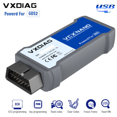

Thanks, didn’t know about that. Apparently the interface software is free and you just have to buy the device.
Like this?
Wired $100
Wi-Fi $125

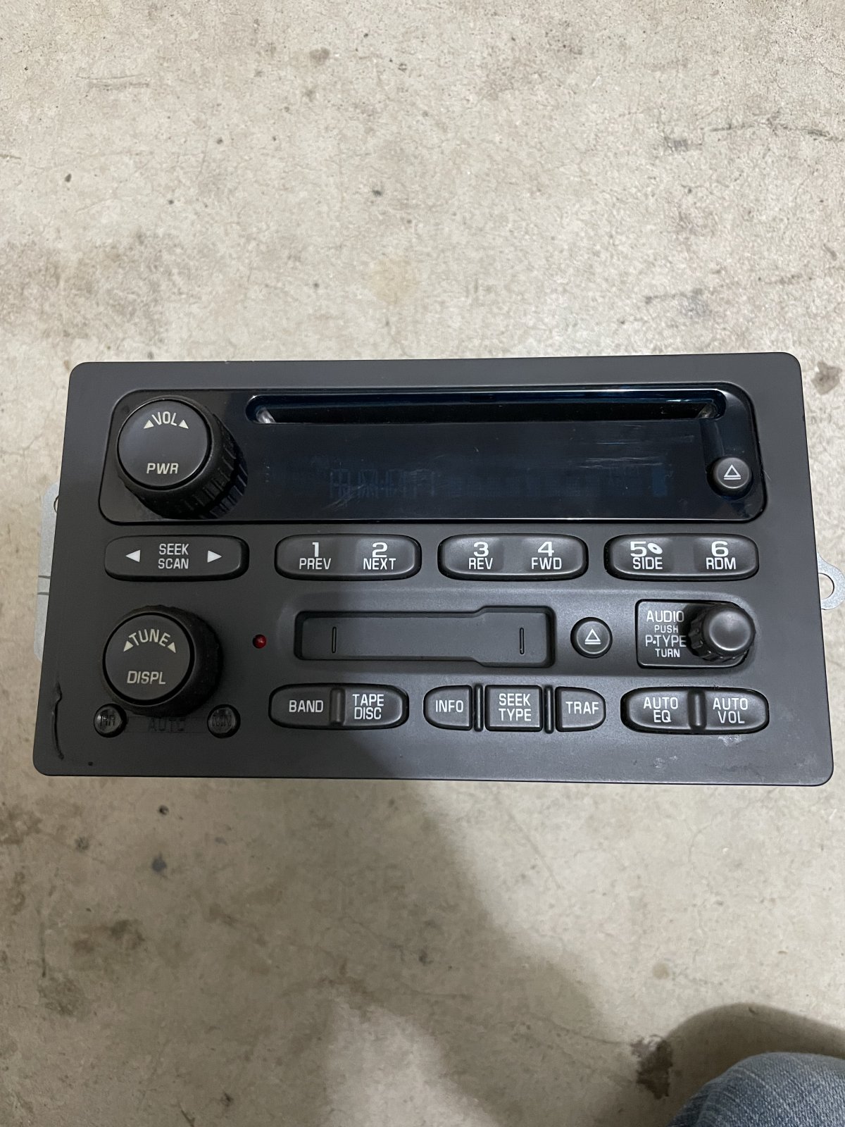

Pulled oem radio and will keep in house warm while rest of the burb is cold overnight

If you got no sound, either the radio is not equipped for your radio system, or, some other part of your radio system has failed.
You are on to something. Installed the replacement radio which is in really nice condition but no sound. Powers on and can change stations but no chime no sound at all
I hook up original radio and stuff and works when it’s not cold out of course.
Like this?
Wired $100
Wi-Fi $125
yep
