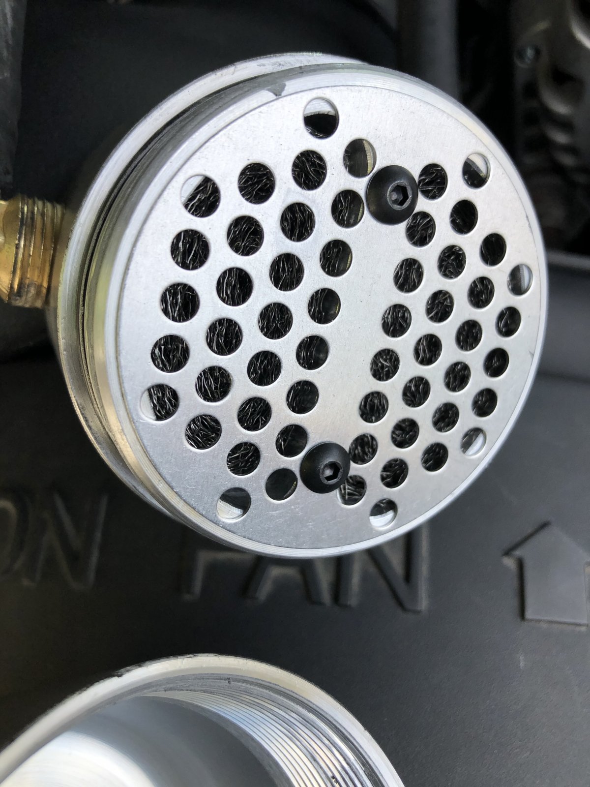

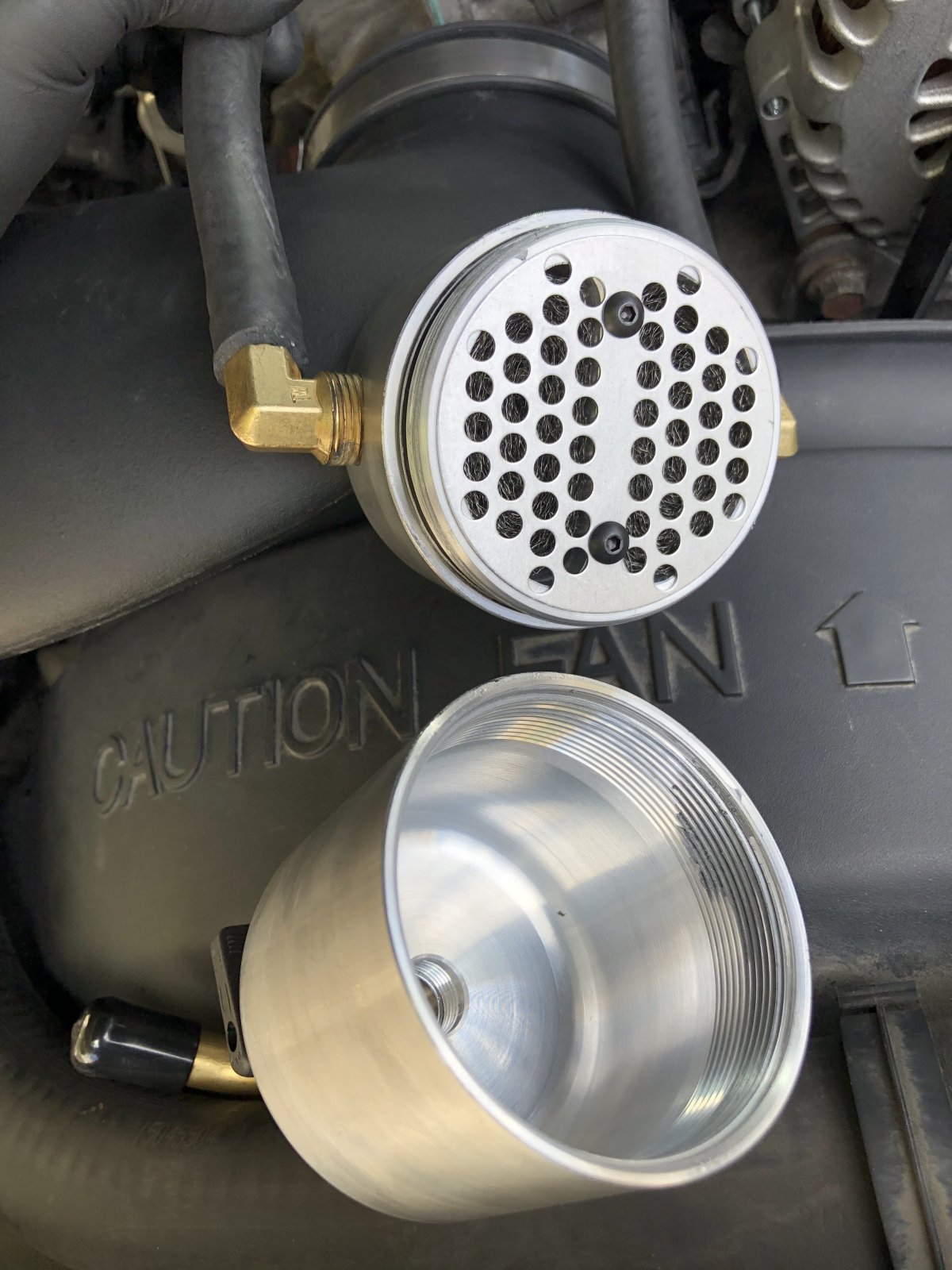

Imo, hose length doesn't really matter. You should be fine. What alot of guys do, including myself--is to put some steel scrubbing wool in addition to the catch can filter. It helps to catch more oil vapors.
33,210
51,472
Do you mean add steel wool to the inside of the catch can? Which grit?
I used the steel scrubber stuff you clean pots with. Open your catch can and look under the part(top)that the hoses go in/out of. You should see a filter in there. Mine unscrews and allowed me to add the additional filter material to it.

Ah yes, so stuff even more steel scrubber in there... good idea, will do.
