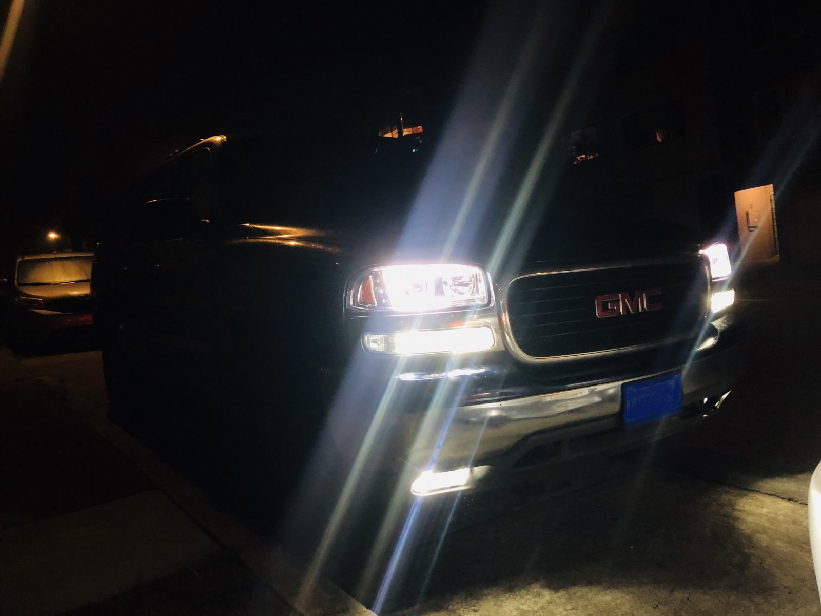

Ok, it’s the bulbs. I had two different types in there (to compare which is brighter), I swapped them around, and now the DRLs come on when parking lamp switch is on, but not the parking lamps.
Just need to order another set of the bulbs that work.
Given that they are LED, I should be able to get away with this connection set up, ya? No relay required?
Yep should be fine.

Lights all in.
The side marker lights flash simultaneously with the turns signals (not alternatively), which I don’t mind, but aren’t they supposed to be illuminated otherwise when the parking lights are activated?

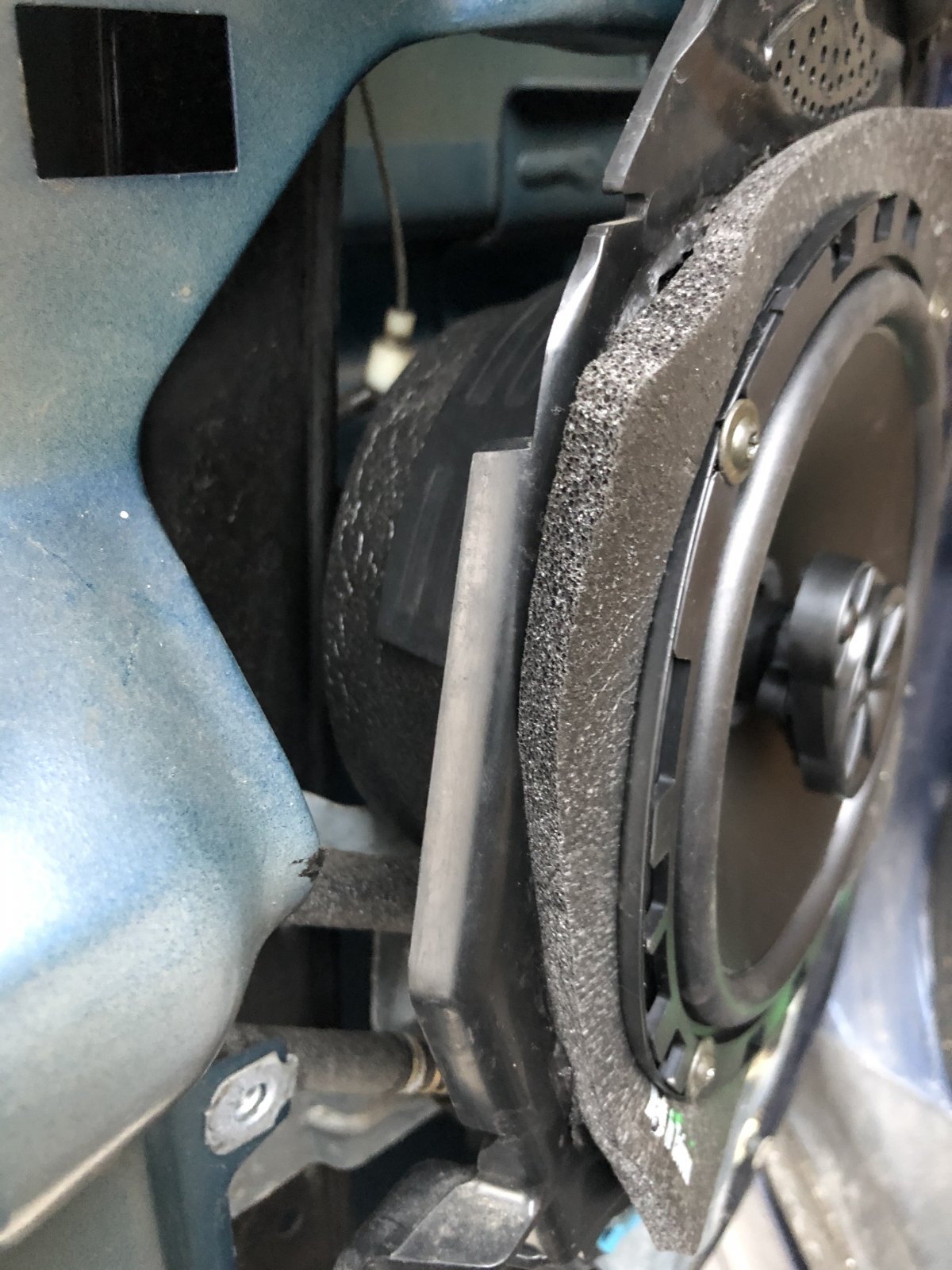

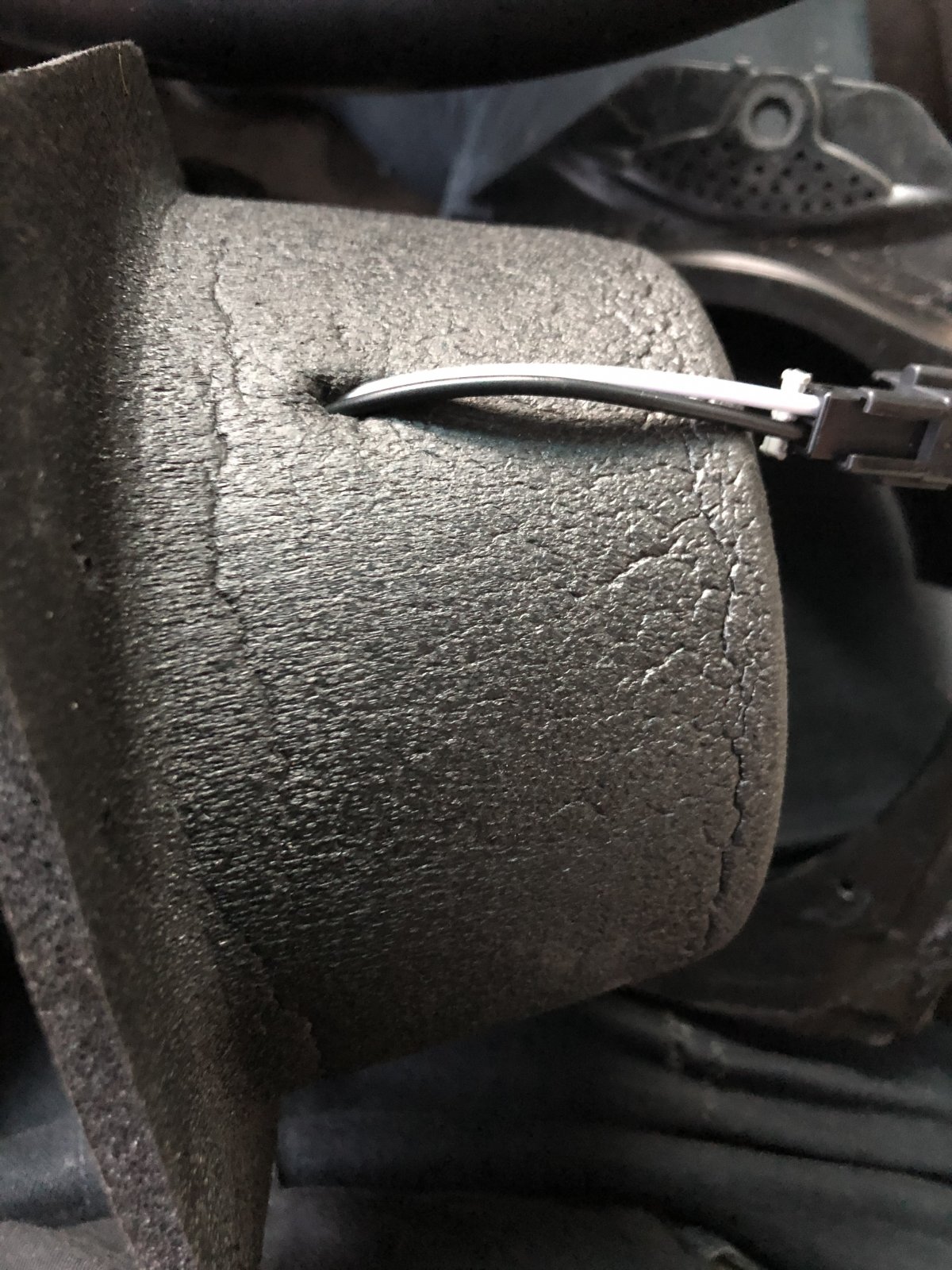

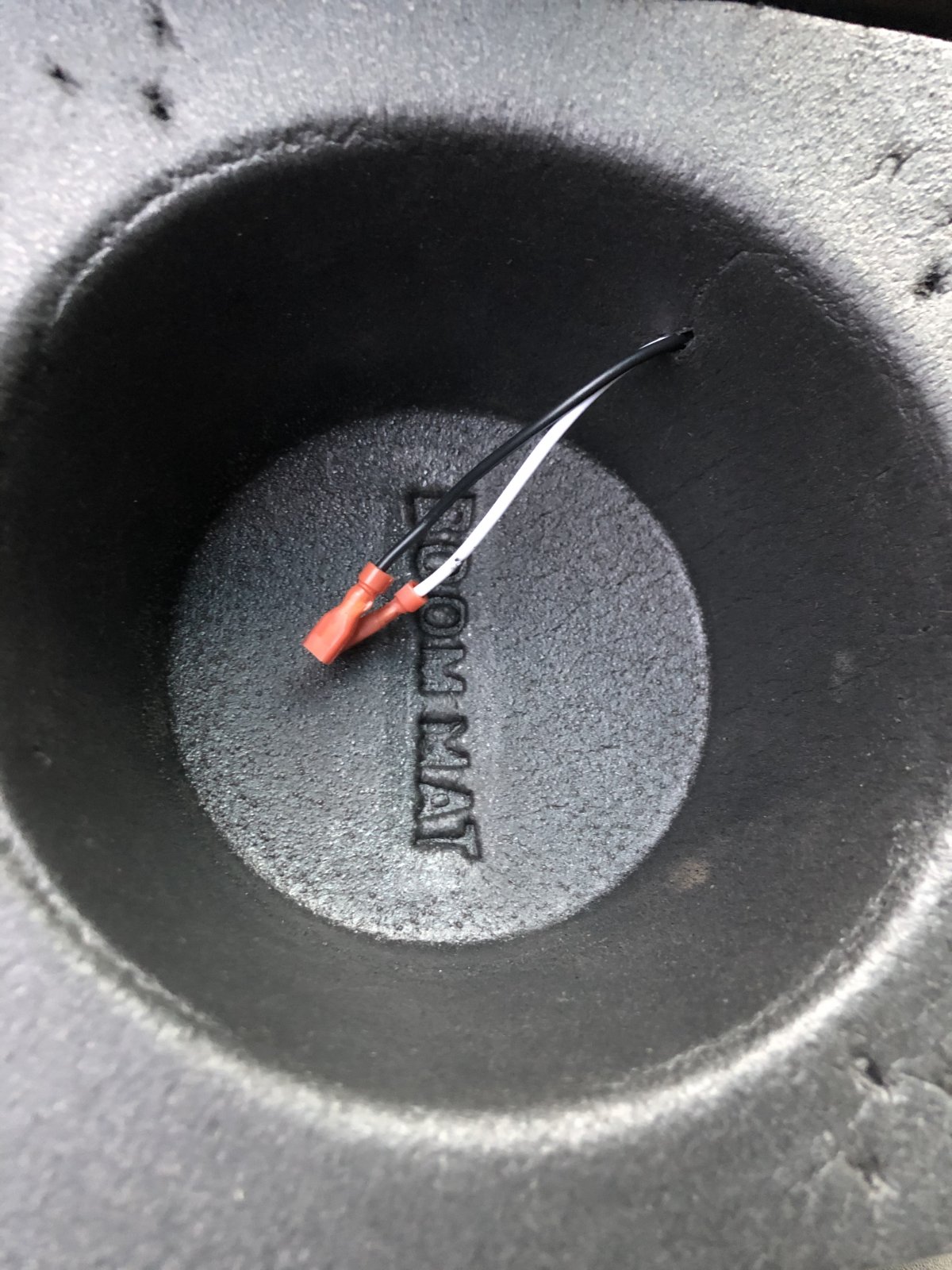

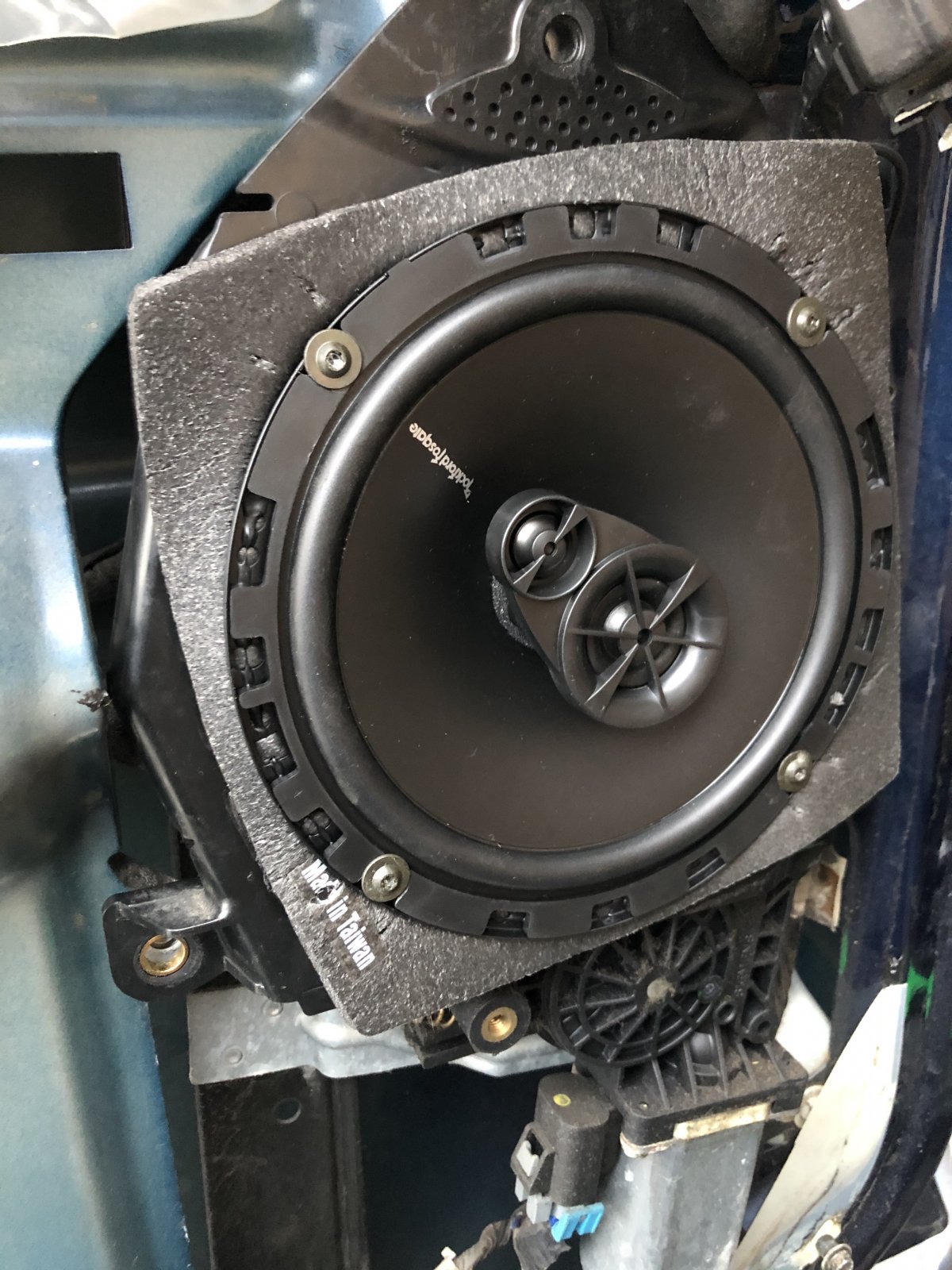

I’m going to use these baffle enclosures for the speakers to help increase the bass a bit, as well as protect the speakers from moisture, and seems like I may not even need the adapters for the rear.
So far it looks like it will work.

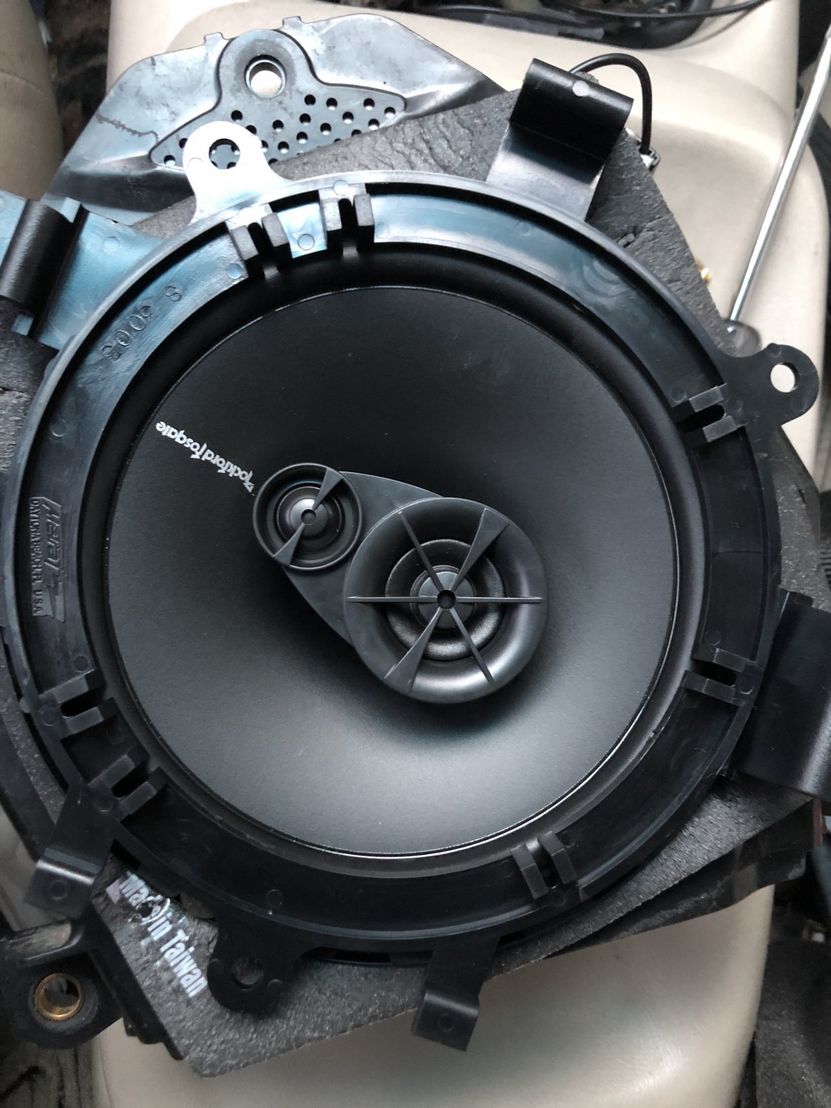

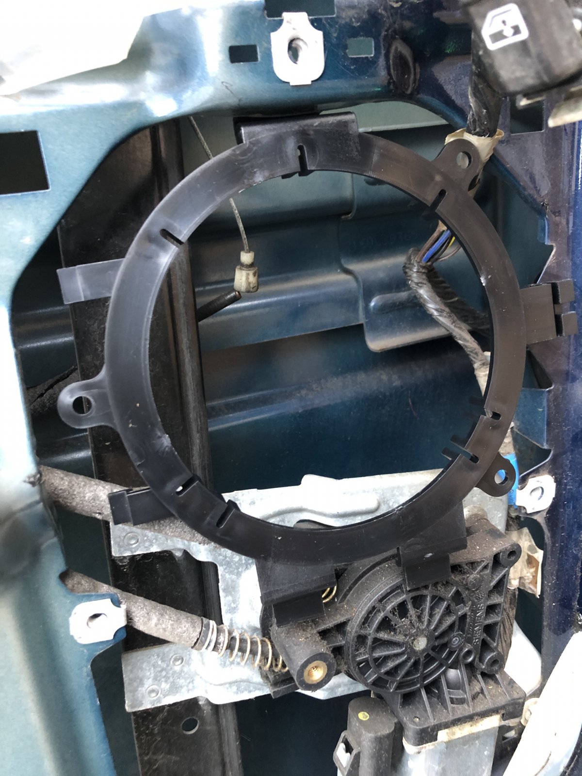

And just for good measure, here is a photo of those adapters on top of the speakers in the stock housing... There would have been nowhere to attach the screws.
Possibly incorrect adapters? What is the correct model number for the correct adapters?

How about a picture of the stock speakers in the stock location unmolested? I looked through my pics and can't find any of the rear door speakers but I know there wasn't anything difficult or I would remember. Maybe you can just install them in the original location with no adapters? Also, if you use those foam surrounds, you need to cut the bottom half off or they will sound terrible. You cant seal them in that small of a space, they need to breathe. take those things and cut them in half and just put them over the top as a water shield. The door itself is the enclosure. And where is your plastic vapor barrier? If they're missing you need to use sound deadener or heavy plastic sealed around the perimeter of the door before you install the speaker (cut a hole for the speaker to mount into) or they will sound terrible. You need to create a somewhat sealed enclosure out of the door for the bass.
View attachment 251425 View attachment 251426
Definitely wrong adapters! Those are for the OBS trucks (Old Body Style), you have a NBS truck(New Body Style). Find the ones for your truck, and then they should fit!
52,949
This video shows the stock speakers and I’m pretty sure all you need to do is mount the new 6.5’s in the same locations without adapters, might have to drill new screw holes. Do the speakers fit in the holes after you pulled the original speakers out?

Just heat up the metal on the door and then press it on a section at a time so you don’t melt the plastic. I have been trying to remember what I did for my rear door speakers and found this video that I believe shows what I did. I remember cutting off the tabs that stick out on the plastic like he did at 7:40 in the video, and I think my speakers came with some adapter rings like he showed. Anyway, yes I did for sure reuse the original plastic mounts and I did for sure have to modify them, just not sure if it’s exactly like he does in the video. The first part about removing the nubs that stick out, I did that and remember it. As far as enlarging the hole, I’m not sure. I believe I removed the plastic mounts and worked on them on a bench until the speakers fit.

Hmm interesting, the stock mounts in my 01 don’t have those tabs, however they do have smaller bulbs sticking out, which I will trim.

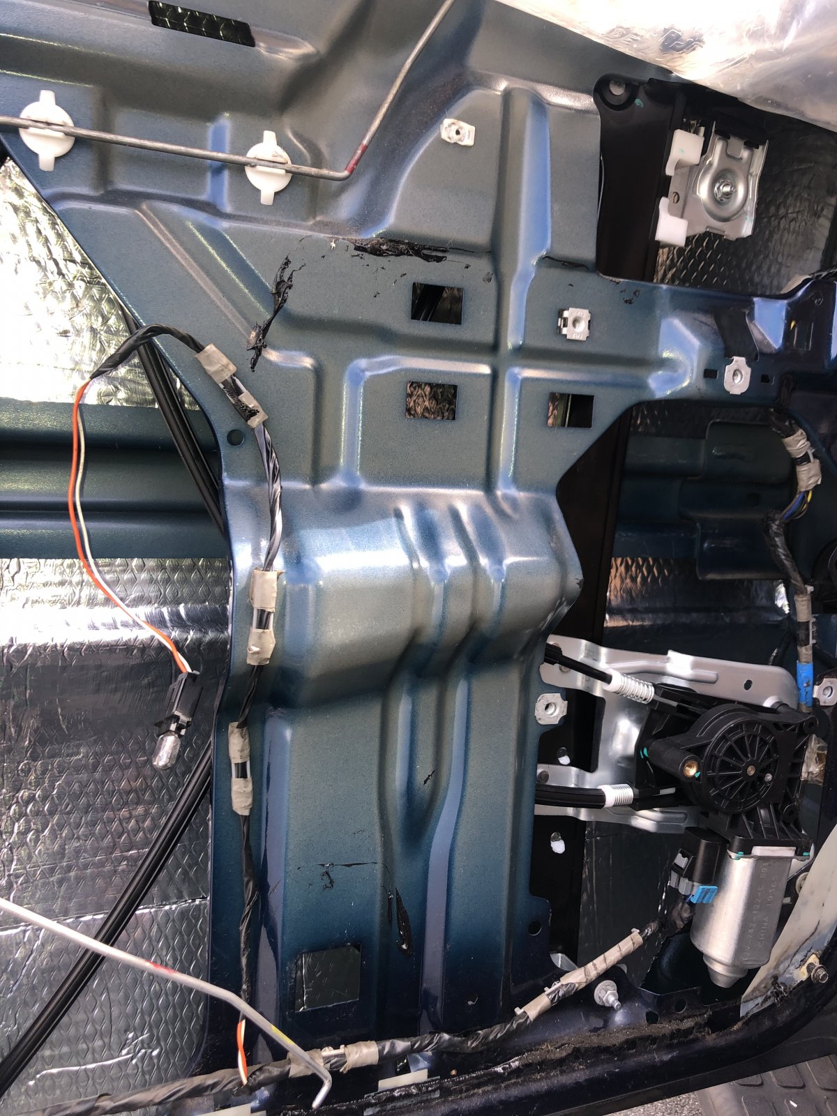

Installing sound deadener was a heck of a lot easier with the window regulator removed. The fronts will be a little more interesting.
