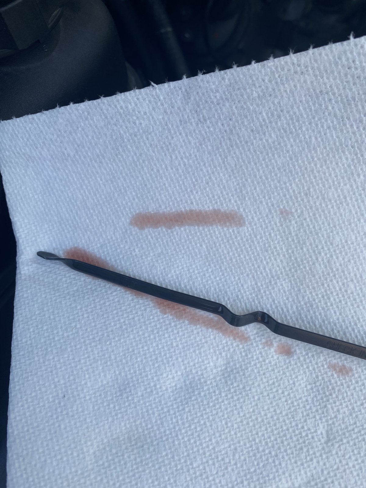

So I just check the fluid again and while I can’t really read the level well but the color looks quite good to me! (See pic)This would be consistent with the transfer case fluid I changed which was also still quite red. Maybe the previous owner changed it and just doesn’t show up on the Carfax! Either way I’ll still do it just in case the filter was not changed I suppose?

So just to follow up with this and not leave things hanging. I added about 60% (worried about it being too much) of a bottle of Seafoam Trans Tune to the transmission fluid and drove the truck about 300-400 miles before taking it to another transmission shop. First shop I took it to test drove it like a grandpa and said it was fine and the fluid was red and recommended not touching it. I then took it to another shop and he drove it without me but said he put it through the paces and it never skipped a beat. He then performed the fluid and filter service ($300) and said the pan was clear and found no evidence of any issues. He said I was on borrowed time as he does 20-30 a year of these now and says the same as all others on here, torque converters and the pumps at the bell housing. He does not rebuild them but does remanufactured units for around $3700 with a 3 year 100k mile warranty.
I have not gotten the trans temp up that hot to where I had the previous concerns but it does seem to drive better after the trans tune and fluid and service. Next up is the coolant and hoses in the spring time and hope its remains reliable!
