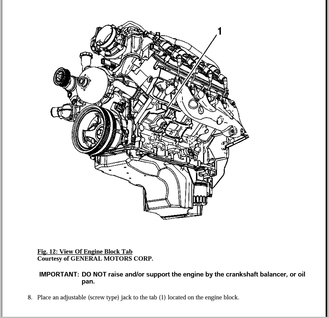

There are actually spots cast into both sides of the engine block that protrude out specifically for this.
View attachment 268969[/QUOTE]
Dang, I have power steering cooler lines blocking that tab, and the passenger side looks like almost no access to the tags without removing a bunch of stuff...

When I did all the work of dropping the pan and swapping oil pump and timing chain, etc. back in the day I used a engine hoist/cherry picker, but a piece of 2x4 stood on its end between the jack and the jacking points on the block should work just fine as well.
My Burb is a 2wd though so I know there is less stuff in the way.
