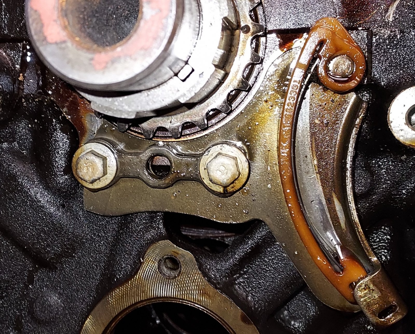

Well, here is the damage, and my opinion on what happened.
Chain tensioner bracket broke, causing the chain to break. Cam stopped but the crank didn't.
Just one exhaust valve bent, and that valves' pushrod and rocker arm have slight grind marks (where the rocker and pushrod meet). However, no pushrod is bent.
All other parts of this engine with 350000+ miles are in just about perfect shape.
AFM system never failed. Cam bearings show the milage, but Cam shaft is perfect.
ALL of the AFM and regular lifters function, and are perfect being ran for 350000 miles.
Main bearing clearance is .002, and rod bearing is .0015 - show no signs of wear.
One piston has a slight exhaust valve contact mark, but the rest of them are good.
One important thing that stands out to me is the valve seals. They are seriously worn.
After all this milage that is probably expected. BUT, can this be a lesson as to replace the valve seals every 100000 miles or so? Can doing so, save some of the tarnish build up inside of the engine? Also, can doing so help the function of AFM/DOD? Questions may be worth answering for somebody who just wants what the factory designed...just an extra thought.
In closing, IMO, and based upon my first experience with AFM -
All of the anti AFM/DOD system hype that is put on the internet may have hidden truths that may not be mentioned when AFM/DOD is trashed.
Are the systems that fail properly maintained?
Is the oil and filter changed 3000 miles religiously?
Is there an after market air intake system that can introduce air filter oil into the intake system?
These are just my thoughts on the AFM system in my engine. Of which I'm deleting (LOL) but never the less the proof is in what my eyes see.
My engine oil and filter has been changed every 3000 miles (since I purchased it with 95000 on it)
AFM system worked as it should with NO issues what so ever.
Filter is Purolator BOSS, Oil is Quakerstate Ultimate Durability (dexo stuff) full synthetic - green bottle with gold label. 5w30.
Thanks again to everyone! The knowledge here is more than I can ask for.

WOW! Just ... WOW!
The condition and bearing clearances is remarkable!
You are probably about DOD AFM being overblown; you only hear about the bad ones. I suspect some of those cases is after vehicle having multiple owners down the road and someone didn't do proper maintenance.
What are your plans for the engine? How do the cylinders look? Any measurements for diameter, taper, etc. on that? Maybe just ball hone for cylinders?

The cylinders look perfect. Cross hatch is equally visible on all of them. No ridge, or vertical scuff marks. Rings are good, spin freely in piston. Piston skirt coating is rubbed off, but that is supposed to happen.
BUT, I never go by eye. I'll measure next week, then send it to machine shop for them to measure.
IF our measurements coincide with each other - I'll take it from there - but probably a light hone and a good hot parts cleaner wash cycle or two - some paint and away we go.
Plans are to rebuild this engine - but as far as it going back in my Tahoe - I may still swap a 6.0 into my Tahoe. That idea came from this thread. LOL
One thing that WILL NEVER happen too me again - is a Melling Timing Chain or Melling timing component will NEVER fail me again! I'LL NEVER LET THAT HAPPEN AGAIN!!
