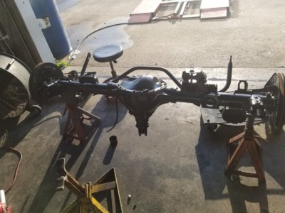

Axle showed up, had it delivered to friends shop so we could install on lift.

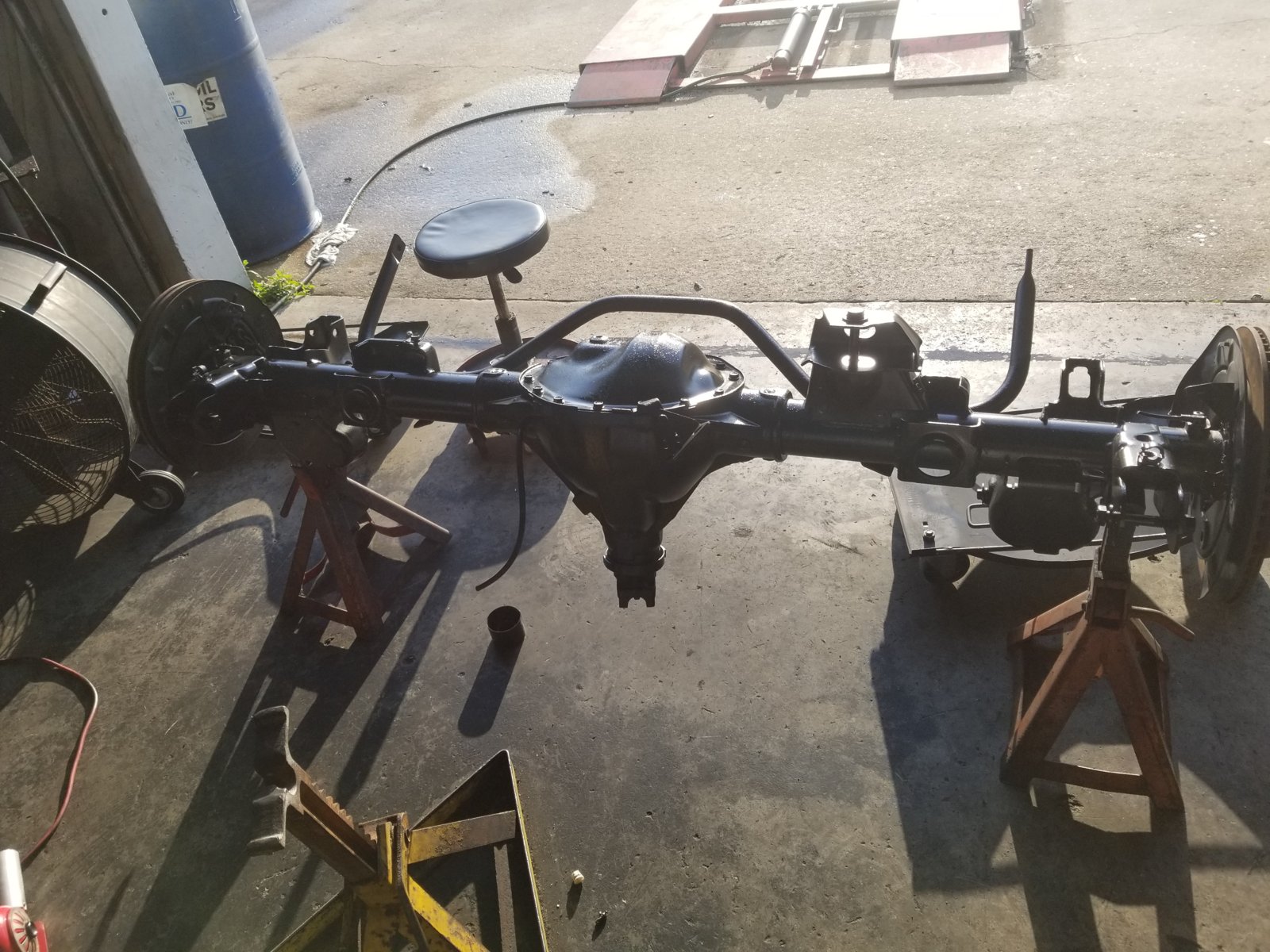

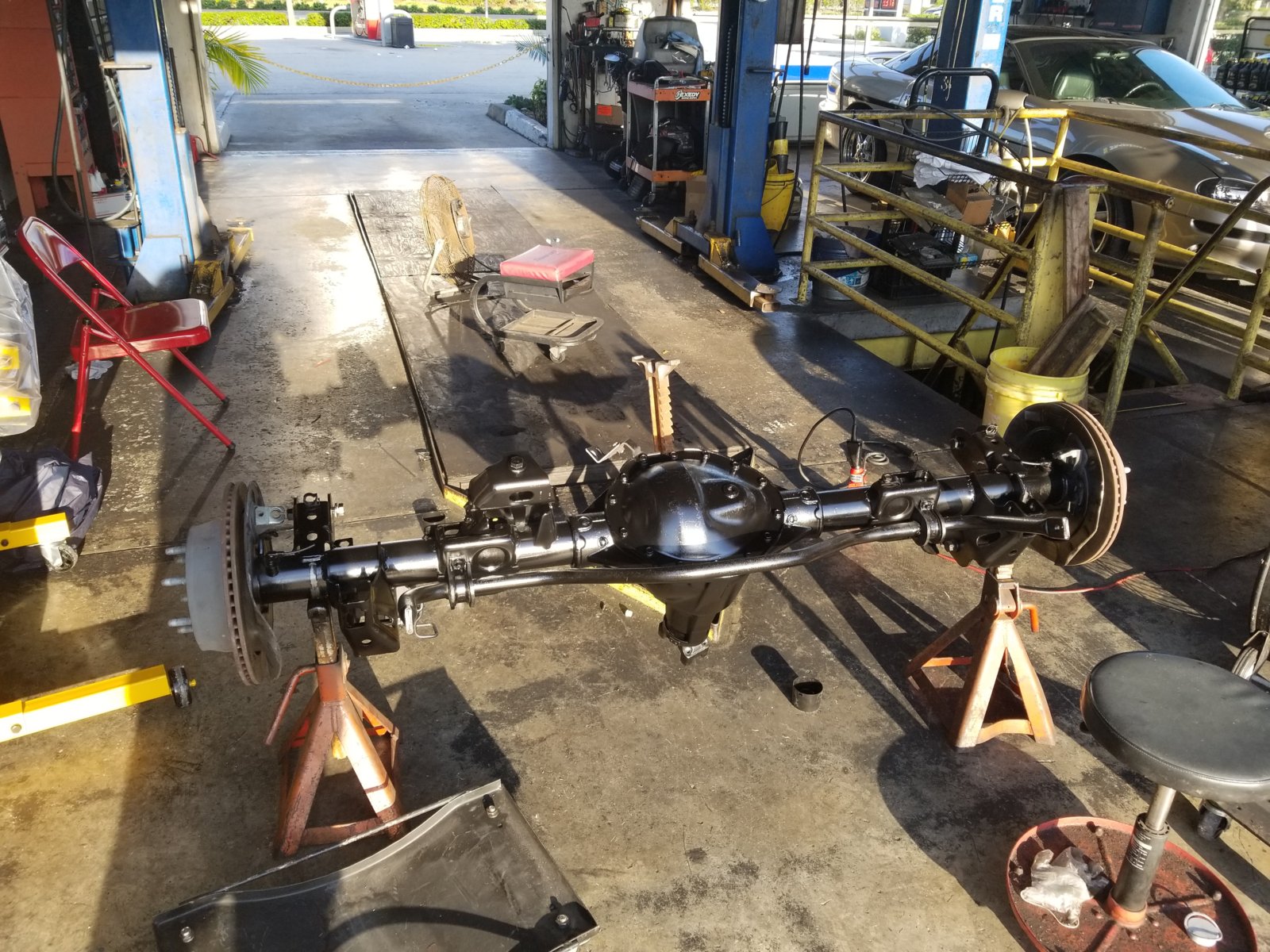

Axle looks great, reported as 26k miles and looks clean. Didn't do me any favors past that tho- cut the flex line to calipers (no calipers) and for whatever reason cut all hard brake lines on the axle, bent the hell out of the dust covers/backing plates, cut the speed sensors right before the connector.
Going to clean it up, slap some paint on it. Ordered the PML cover and lube locker gasket, ordered the conversion ujoint but I need to crawl under as it sits and try to determine what end is on my driveshaft. Going to do the charcoal canister while I'm there too

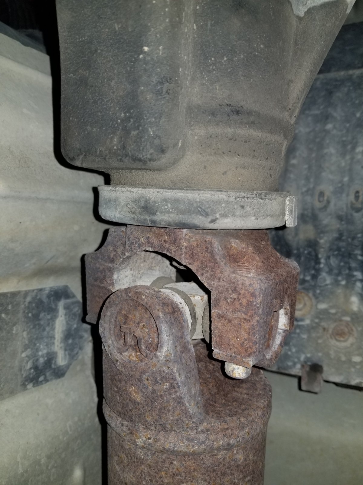

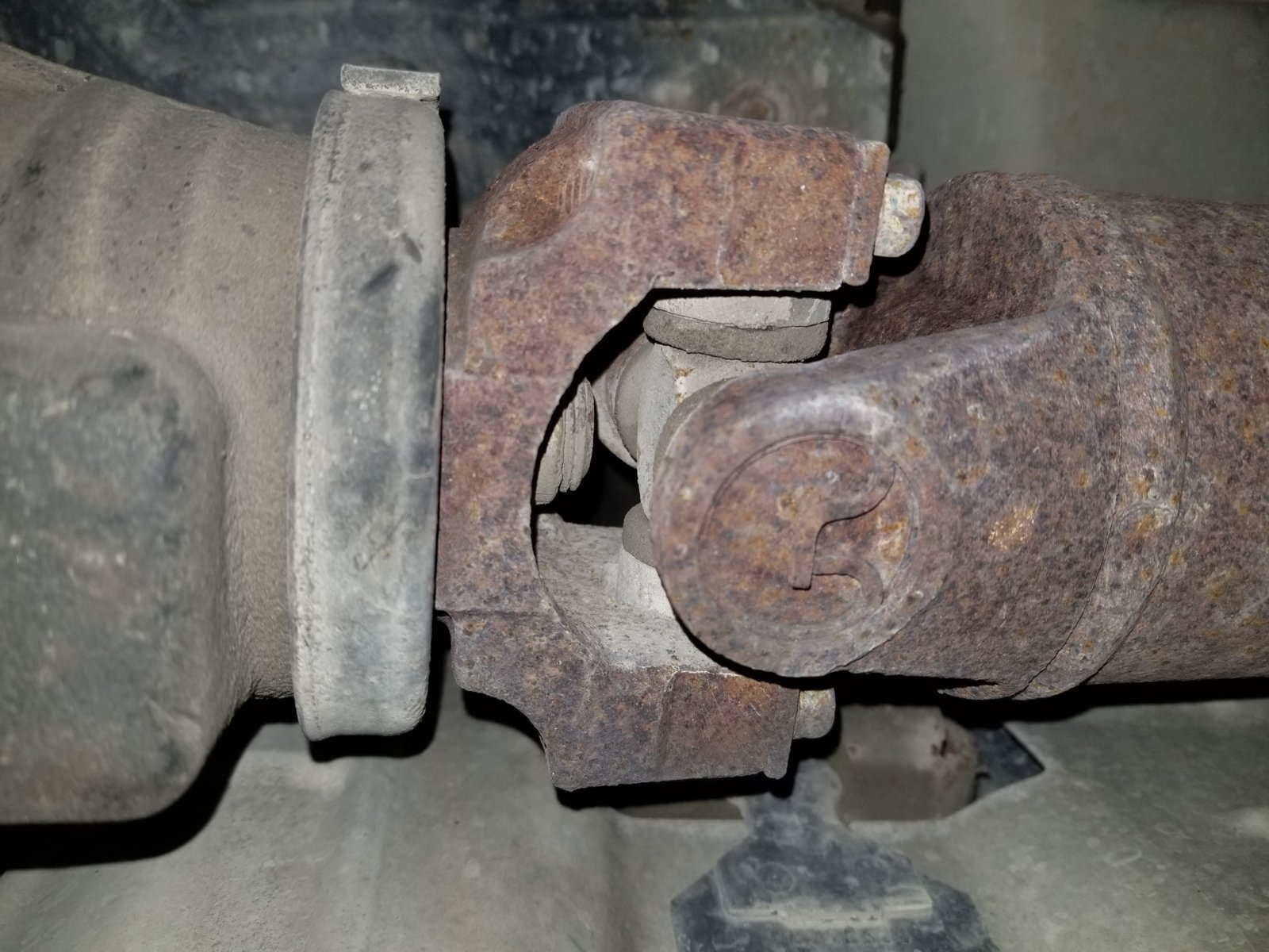

So mech and I were trying to make sure we had the correct ujoint. He had a 1310 to 1350 one. Compared it, it definitely looked like both , the stock driveshaft and 8.6 yoke, were 1350. He called a few places. Couldn't confirm, said f it and pulled the stock driveshaft out and set it in the 14bolt yoke as it sits, just needs straps.
Soooo as a side note, the 10 bolt 8.6" I have now, has a 1350 yoke on it:shrug:

Been scratching my head about it for a few weeks. ive got a 1350 to 1310 and a 1350 to mechanics 3R conversion joints, that's why we finally just pulled the driveshaft and set it in the 14 bolt yoke.
The smaller ujoints all have inner clips to keep the caps on. Mine just has outer clips on the driveshaft and tab/strap on the yoke

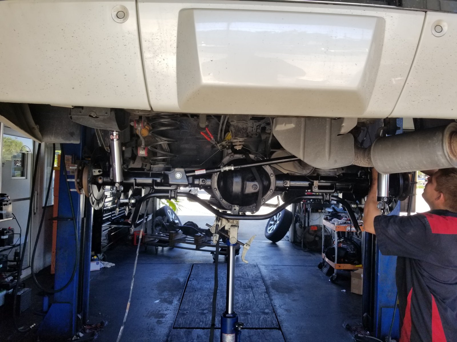

welp, kinda uneventful. everything swapped right over to it.
brakes - caliper brackets, calipers, pads, hardlines just needed to be massaged a little over the pumpkin.
5 links bolted right up- uppers/lowers/panhard. panhard is very close to the stock cover on the 14bolt, may not be able to use cover with spoon adjustable
shocks mounts exactly the same with belltech extenders worked perfect.
and driveshaft already had correct u-joint from my 10bolt.
