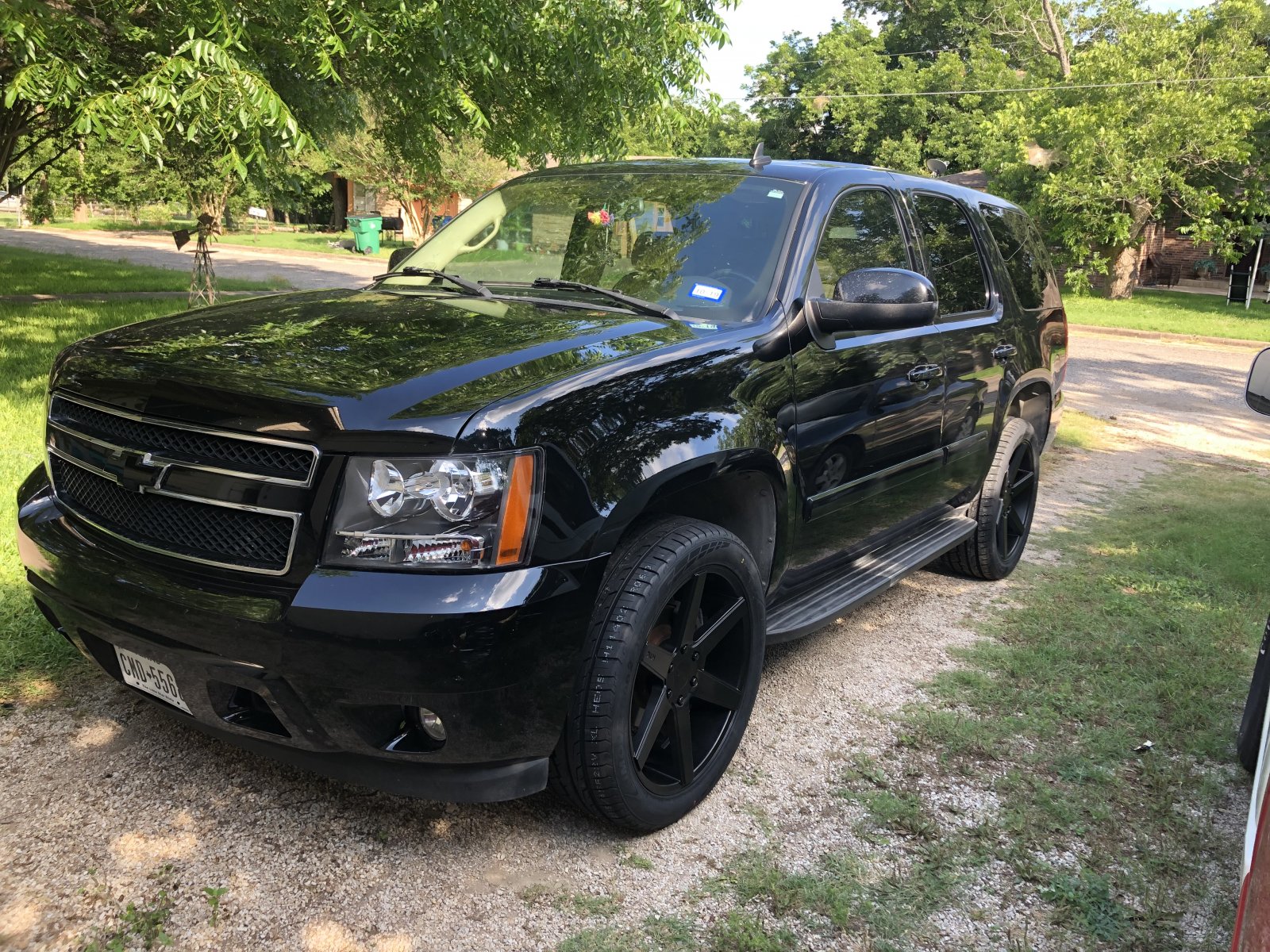

Whats up everyone. I got some new 22’s (KMC 704) for the wife’s ‘07 Tahoe. Now she wants to drop it. I’ve been lookin at a 3-4 to 4-5 drop kit for it. I have 285/45/22 on it. I’ve been lookin at the bell tech kits Tony sells but I’ve also been lookin at the McGaughys drop kits. Just wondering if any one could give pros and cons on both kits. Tahoe needs new shocks and struts so lookin at kits with new struts and shocks as well. Thanks for your time guys.

Whats up everyone. I got some new 22’s (KMC 704) for the wife’s ‘07 Tahoe. Now she wants to drop it. I’ve been lookin at a 3-4 to 4-5 drop kit for it. I have 285/45/22 on it. I’ve been lookin at the bell tech kits Tony sells but I’ve also been lookin at the McGaughys drop kits. Just wondering if any one could give pros and cons on both kits. Tahoe needs new shocks and struts so lookin at kits with new struts and shocks as well. Thanks for your time guys. View attachment 224468
I'm planning pretty much the same drop and have all my main parts. I have the McG spindles. I have nothing against the BT spindles, but chose McG because they're liked by GM. Mine needs new struts and shocks as well, so I went with BT Street Performance adjustable lowering struts for the front and matching SP shocks for the rear. From what I've read, the SP shocks and struts ride just like stock or a little softer. I have 3" McG coils for the rear and some "mystery" coils that I'm guessing will drop it around 5". If it's too soft, I have some Airlift bags I'll add in to firm it up as needed, even when towing.
