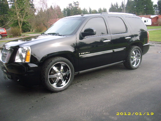

I just installed the Belltech 2/4 drop yesterday that I purchased from Tony.
The installation was fairly easy and took about 3 hours. I cut the bumpstops as Tony indicated and set the air ride links at 3". There is a little rub on the inner fender with the wheels turned hard.
Here is the before and after measurments:
LF 35 3/8" 33 1/2"
RF 35 3/8" 34"
LR 37 5/8" 35 1/2"
RR 38" 35 1/4"

Good looking Denali!
I'm guessing 22"s?

The RR started out higher than the left with the factory springs installed. These measurements were done right after the drop so I am hoping the rear springs will settle a little bit. The compressor seems to kick on more than before so I am going to adjust the links to 2.75" and see what happens. The ride is great for a lowered vehicle.

Looks good. What year is your Denali? I have the exact same truck but 2007. I'm thinking about dropping it a little after I get a set of 22s. Your pic really helped me visualize what mine will look like.
