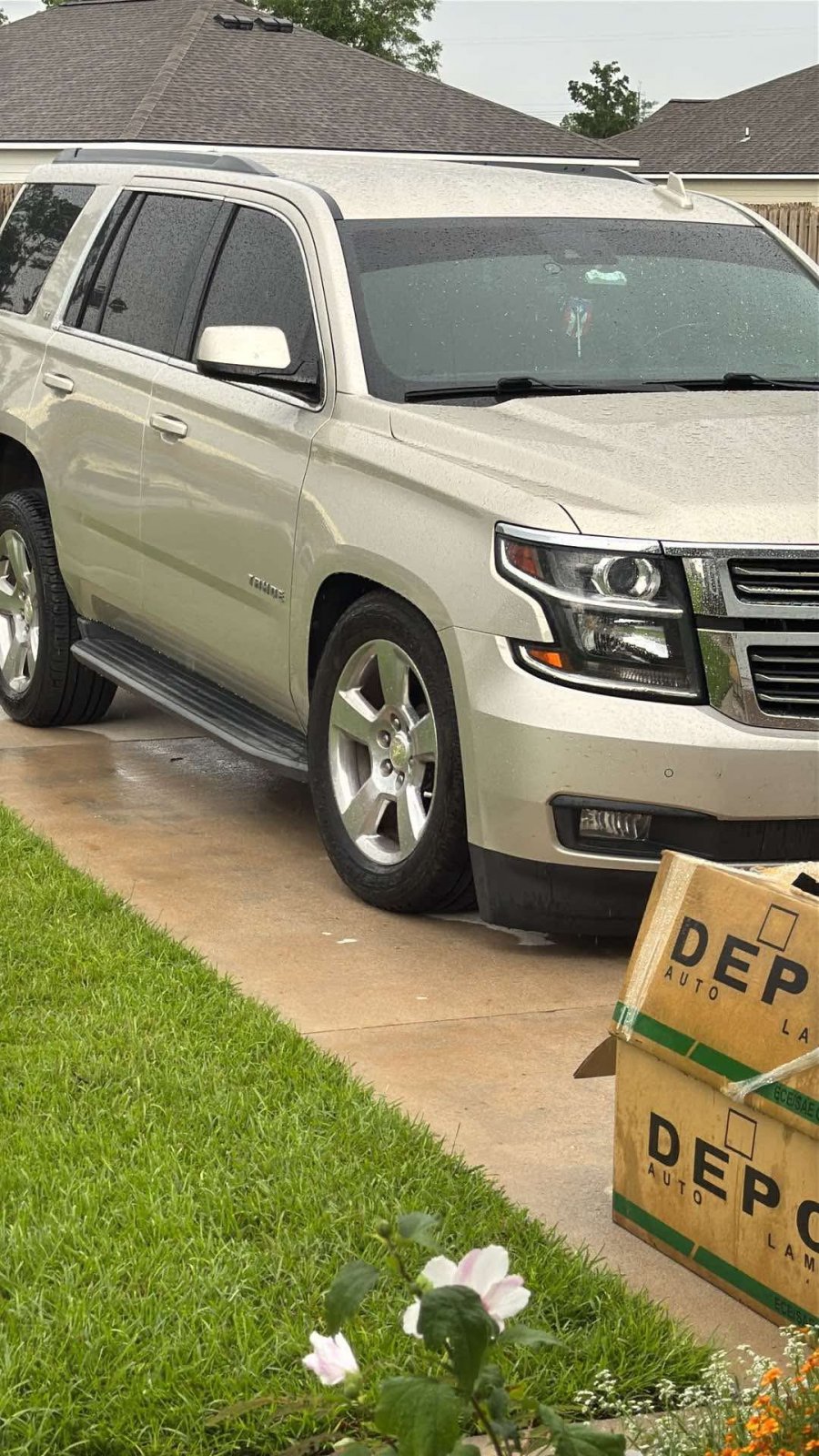

just finished installing the front part of a 2/4 belltech drop. Why does it look way more than 2? Am I just being paranoid

Mine looked like that after one end was done. It won't look as extreme after you drop the back. But yeah it does look like more than 2".
What kit did you get? Was it just spindles or spindles and struts? That looks pretty far drop for just spindles. Looks like 3-4" drop in the front right there.
I did spindles and flipped the struts under the arms to get the same look.

I got the belltech 2/4 drop as well, which also had the option for 3" drop instead of 4". Just spindles in the front, shock mount relocation brackets and springs in the rear. I measured before and after and it was right in the 2" front drop and 3" rear drop range. Can't remember the exact numbers. But it definitely looked wonky when I was half way through.
