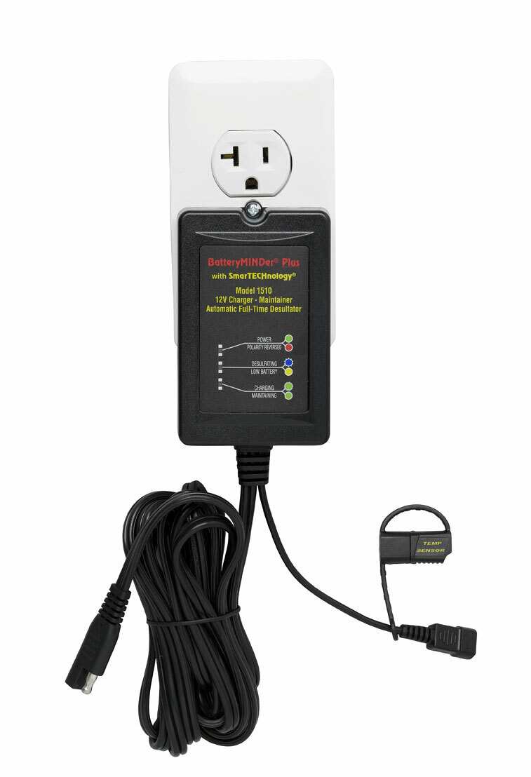

I'm a fan of maintainers that also de-sulfate. Mine sits for a week, sometimes two. Sure, this doesn't drain the battery. But, there's still a steady load that is constantly drawing down the voltage. The maintainer keeps it charged while also keeping in de-sulfated.
I have the BatteryMINDer 1510: https://www.amazon.com/BatteryMINDer-Model-1500-SmarTECHnology-Motorcycles/dp/B00Q3CM2QY?th=1
It's only 1.5 amp, which should be good for a battery that's already in 'good' condition. But, for desulfation, the general rule is to buy as strong (amps) of a desulfator as you can afford. The NOCO Genius line seems to be really good stuff.

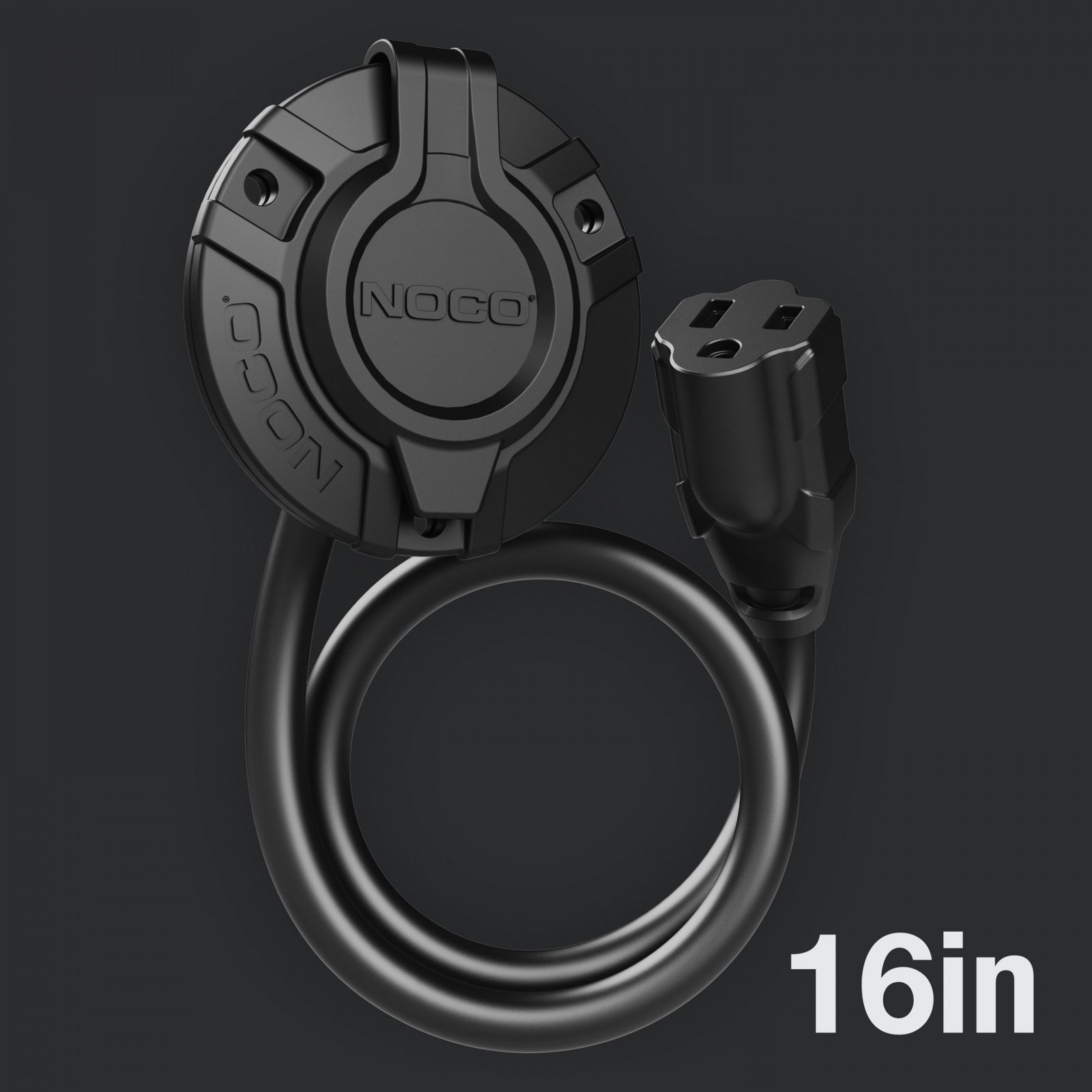

I use a NOCO Genius on my Silverado that sits for a week or two. It’s mounted under the hood and I ran a 120v extension along the frame to the rear and used the trailer harness area (I never tow with it, long story) to mount a receptacle so I can back it in and just plug it in. You could mount the receptacle anywhere you wanted.

Ive got the battery minder 1510 for my Tahoe. Can get them on sale often from northern tool. Recently got a noco genius 5 and a couple of noco to sae adapters to be able to use the 25’ extension cables I have for my battery minders, battery tenders and optimate chargers for all my motorized machines.
