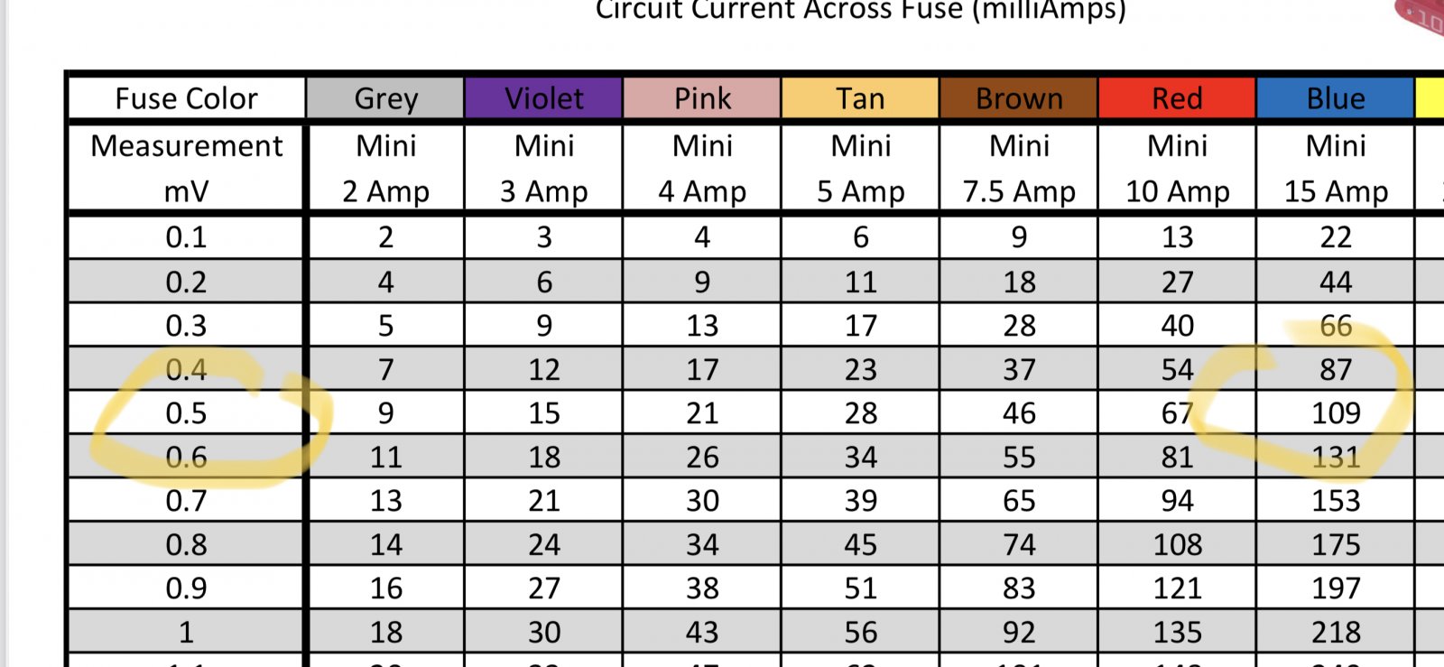

I have a 2007 tahoe LTZ and after a few days or multiple short trips the battery is dead. Battery is good and the charging system works but when checking a voltage drop on the fuses the #41 RDO 15A fuse has about .05mV or 109A running through the fuse while everything is off and the vehicle has sat over night it is an aftermarket radio as well. I have also checked a voltage drop on all the other fuses even in the dash and they all go to 0mV and I have turned the exit lighting to off but the radio will stay on and still play music after that for about 10 minutes till it turns off so I have had to click the tab to disconnect the face plate but still having a bead battery just wondering it the amount of mV and amps is enough to drain the battery

If you meant to type .05ma instead of .05 mv that is one thing because that would be 50ma, but if the 109A reading is correct, then that is quite a big draw. 109amp is the same thing as 109000 ma.

I was using the power probe chart and at .05mV that translates to 109mA just didn’t know if it was enough to drain it and I’ll see about disconnecting power and see if that works

if it was drawing 109 amps you would have a fire.. but 109ma is nothing
this suggest the battery is bad i can go several days with my dash camera 250ma with out issue
