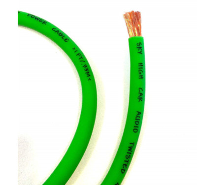

battery cable ?
10,521
15,268
That looks like 4 gauge wire, which is good up to about 125 amps, probably less than you alternator's max amp output. While this 'should' be OK, I suggest that you look into 0 gauge wire which is good up to 300 amps.
07burban88
Nov 24, 2025
95
127
i can snag 0 awg. i also see welding cable that says both battery and welding cable. same thing or different?
