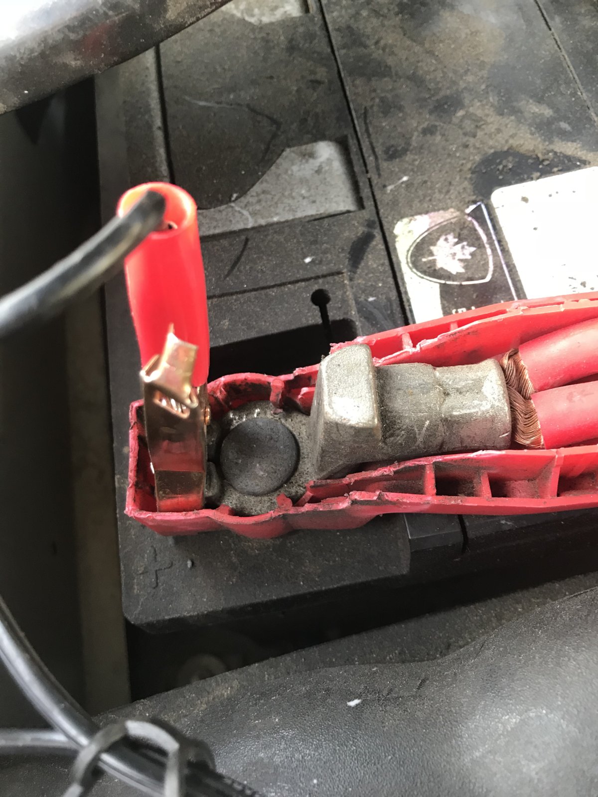

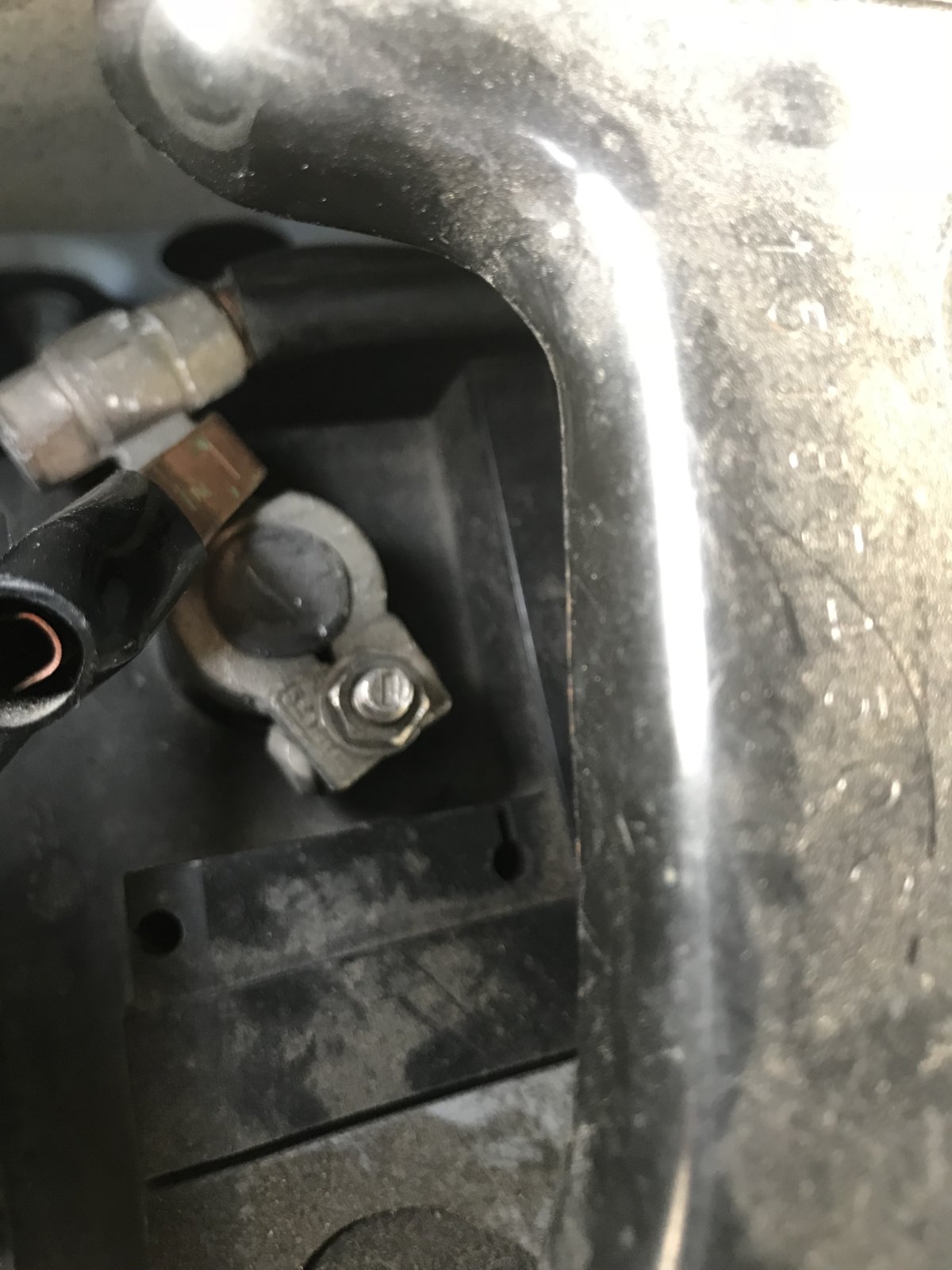

Here are pics of each terminal. Nice and clean.

If the truck acts dead ( assuming the battery is good under load) but perks right up when you put jumper cables on it, then the power is not getting from the battery to the wire. Take the 15 minutes to put a light sand or wire brush on those battery posts and the inside of the clamps and see what it does.
