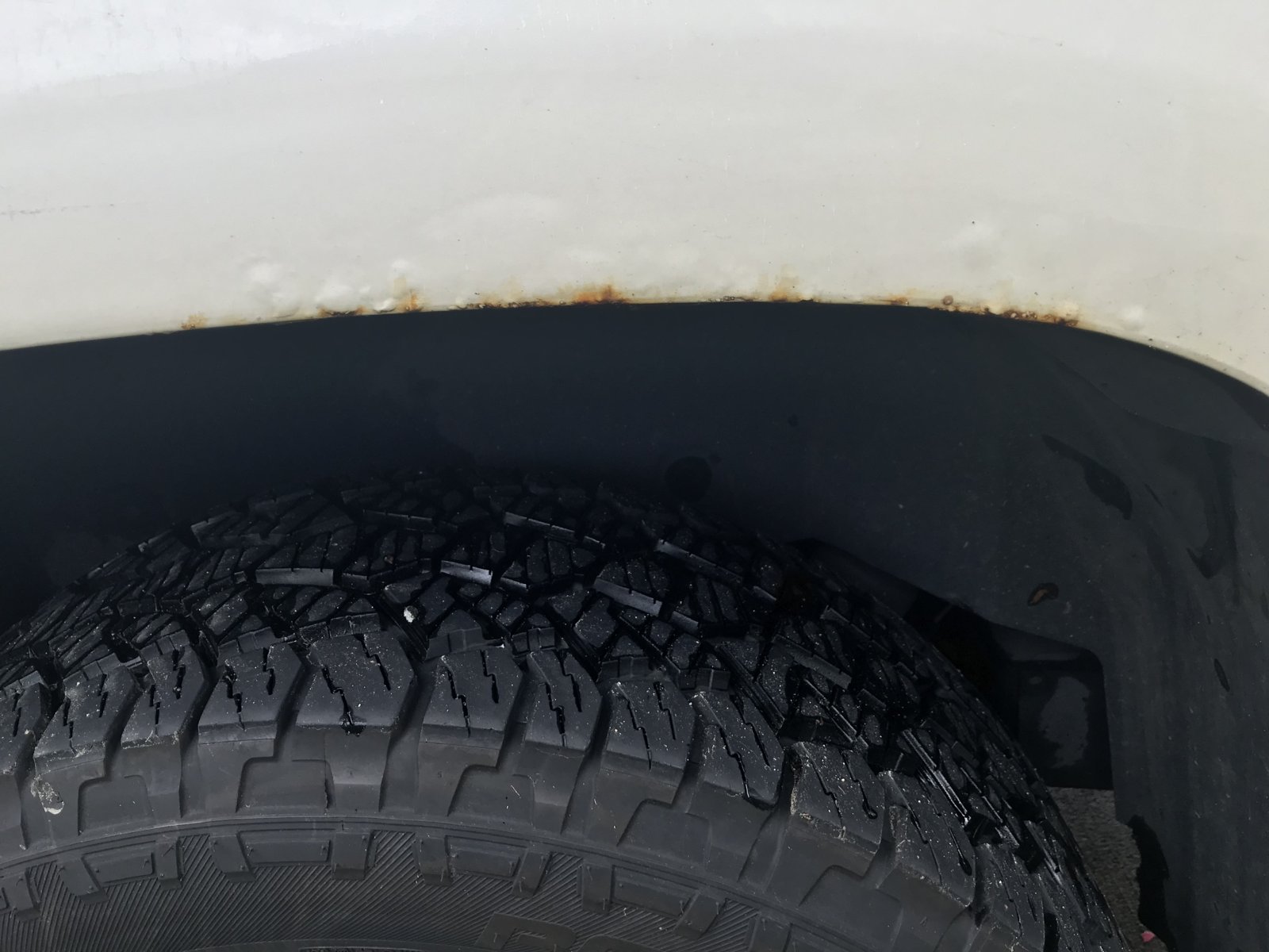

This is the left rear fender. Is this even worth try to get repaired? I've never messed with rust before.

Think he said ‘rear fender’ which technically is the quarter panel and part of the entire body and not replaceable unless.... cut weld paint ......kinda stuff happens
Yeah it's the rear quarter panel,would be pretty tough to replace lol.
