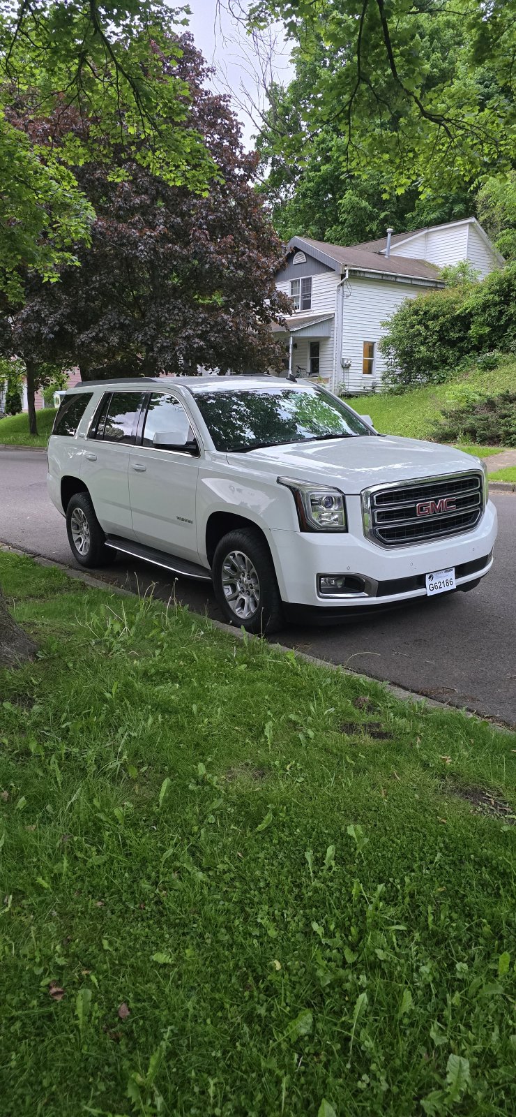

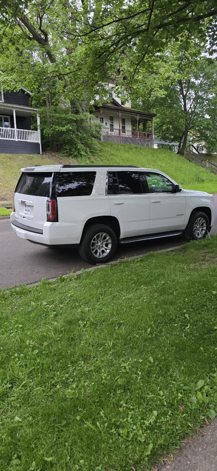

Thanks for all the replies guys, we got it to the shop yesterday and the only thing they could hear today was the injectors which I guess are notoriously loud, they couldn't replicate the ticking like in the video. they're going to keep it a couple more days and see if they can hear any indication of lifter trouble before blindly tearing into it. definitely plan to do the AFM delete tune as well at this point. Will keep everyone updated. yukon has 157,000 miles on it fyi.
