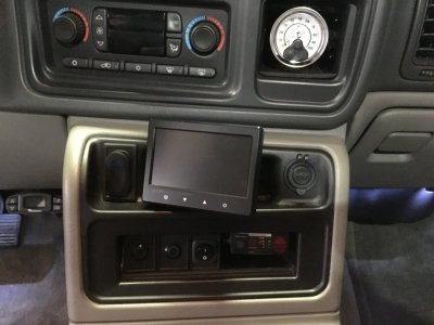

Here's where I put mine: IMG_0154.JPG

hey blue 04 z71 do you have a link for that kit. we need a back up camera bad and that would be the perfect place to put the scree.

Yea looks amazing @04z71 nice spot for that camera love that it looks factory I agree with @juggernaut do you have a link or where did you order it from would like to install that also

does that mirror screen when not in use act as a mirror or would the screen still be visible?

Sorry fellas that was a few years ago. The seller had a bunch and I bought 2. The one ended up being damaged in shipping and he let me keep it and refunded my money. So I have some spare parts to this one. Like I said this one will be going for sale as soon as I pull the trigger on a double din.
This one has a s video cable that you have to run
