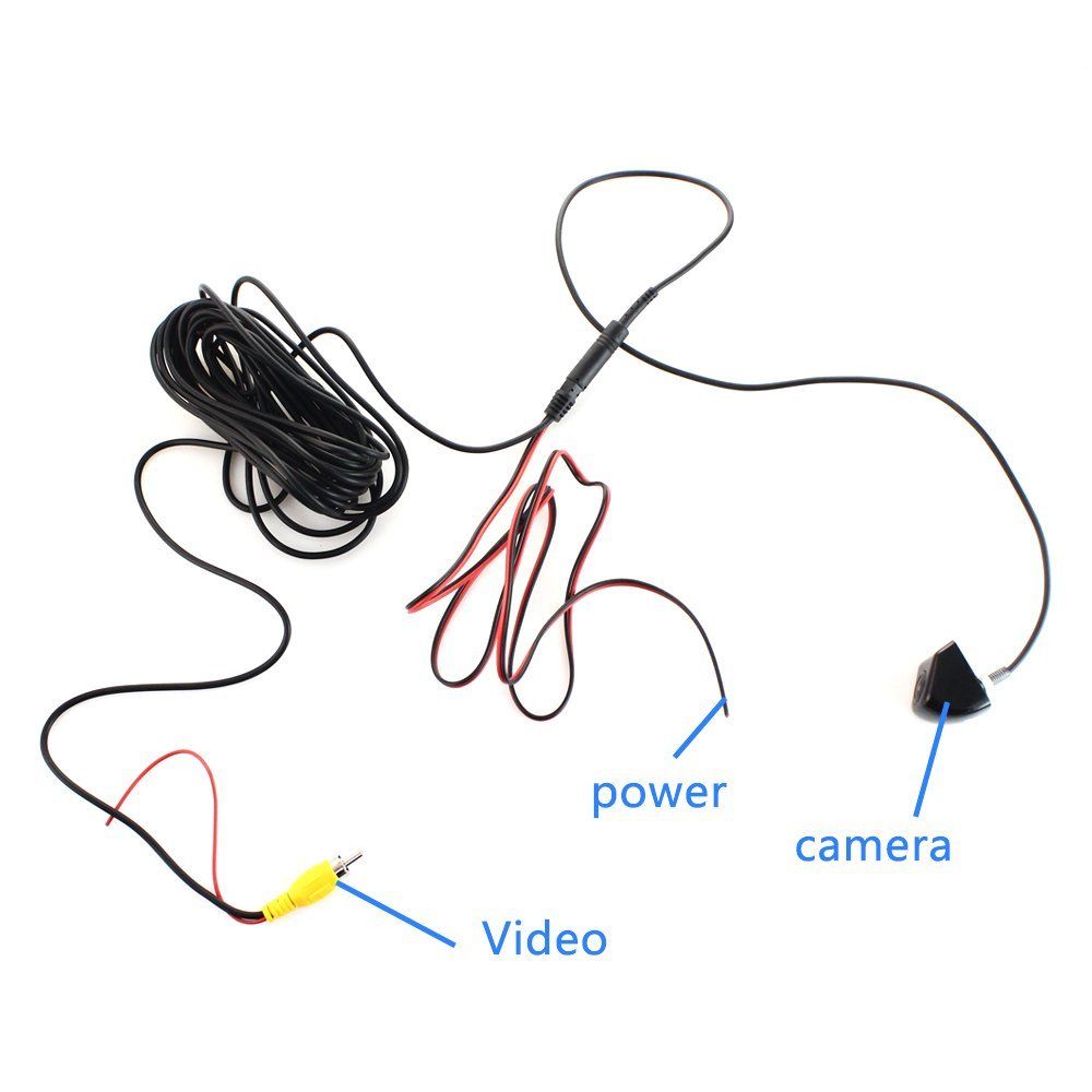

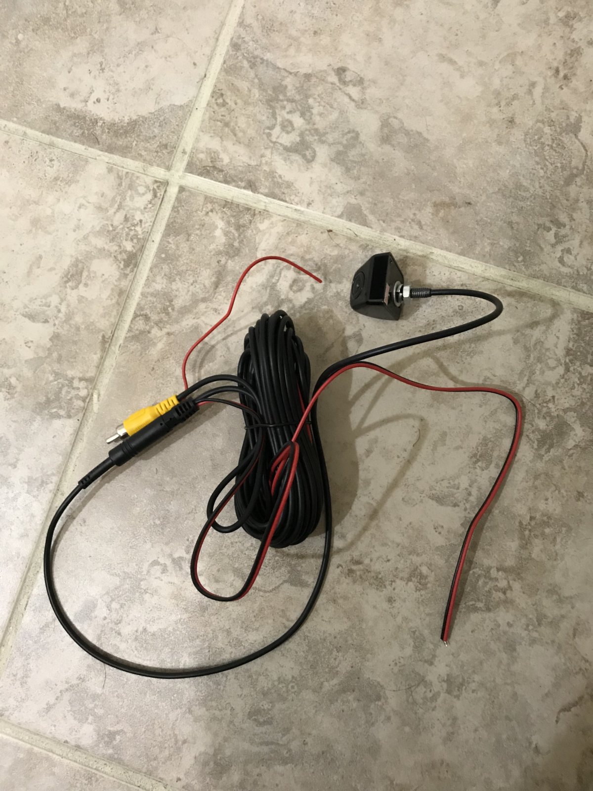

My camera just arrived. No instructions.
kbuskill
Mar 11, 2017
5,862
9,933
NE. FL.
Hard to tell from the pic with the wiring not stretched out but looks like the red and black that are together would be positive (ignition/constant) and negative and the other single red wire would get hooked to you positive lead of the reverse lights to act as a signal wire to turn the camera on when in reverse.
Just a guess on my part.

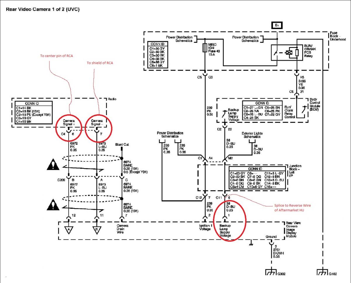

found a diagram for mine
So I think you can create a pigtail off the stock camera's wiring harness for the video feed.
Red and black wire to ground and 12V power
I ended up taking my trunk apart as I'm looking for an AC refrigerant leak (months of searching), still can't find it. Turns out there are quite a few grounds for me to tap into.

OK--
I tried to hard wire it last night. I found a good 12v on the reverse light power that I spliced into. Checked out fine with the voltmeter.
I used the ground on the factory camera harness-- this did not work, need to find a different ground.
When I tested it the other night I just ran the aftermarket camera on temporarily off the battery grnd/+ it worked fine. But last night using the factory harness I could only get squiggly lines last night-- this must mean my ground in the harness is no good (might be why the camera wasn't working to begin with).
Found this, will check it out after work on the Tahoe:
-G302 (In the Chassis Harness on the frame to the rear of the left front tire.)
