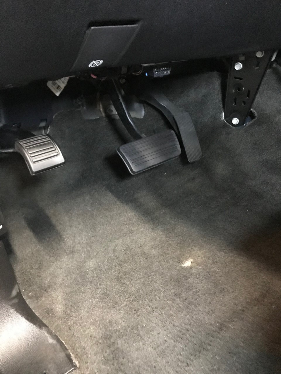

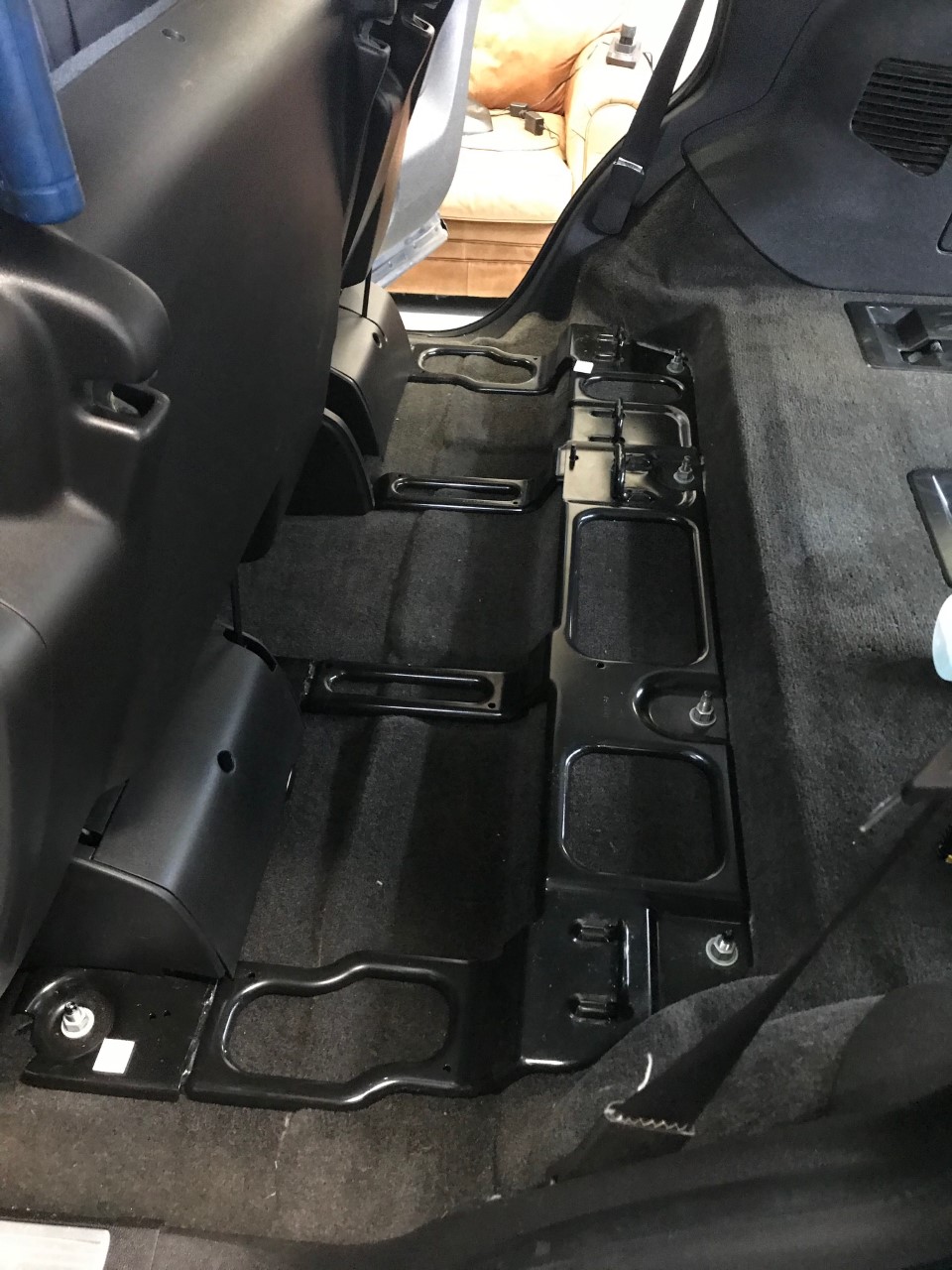

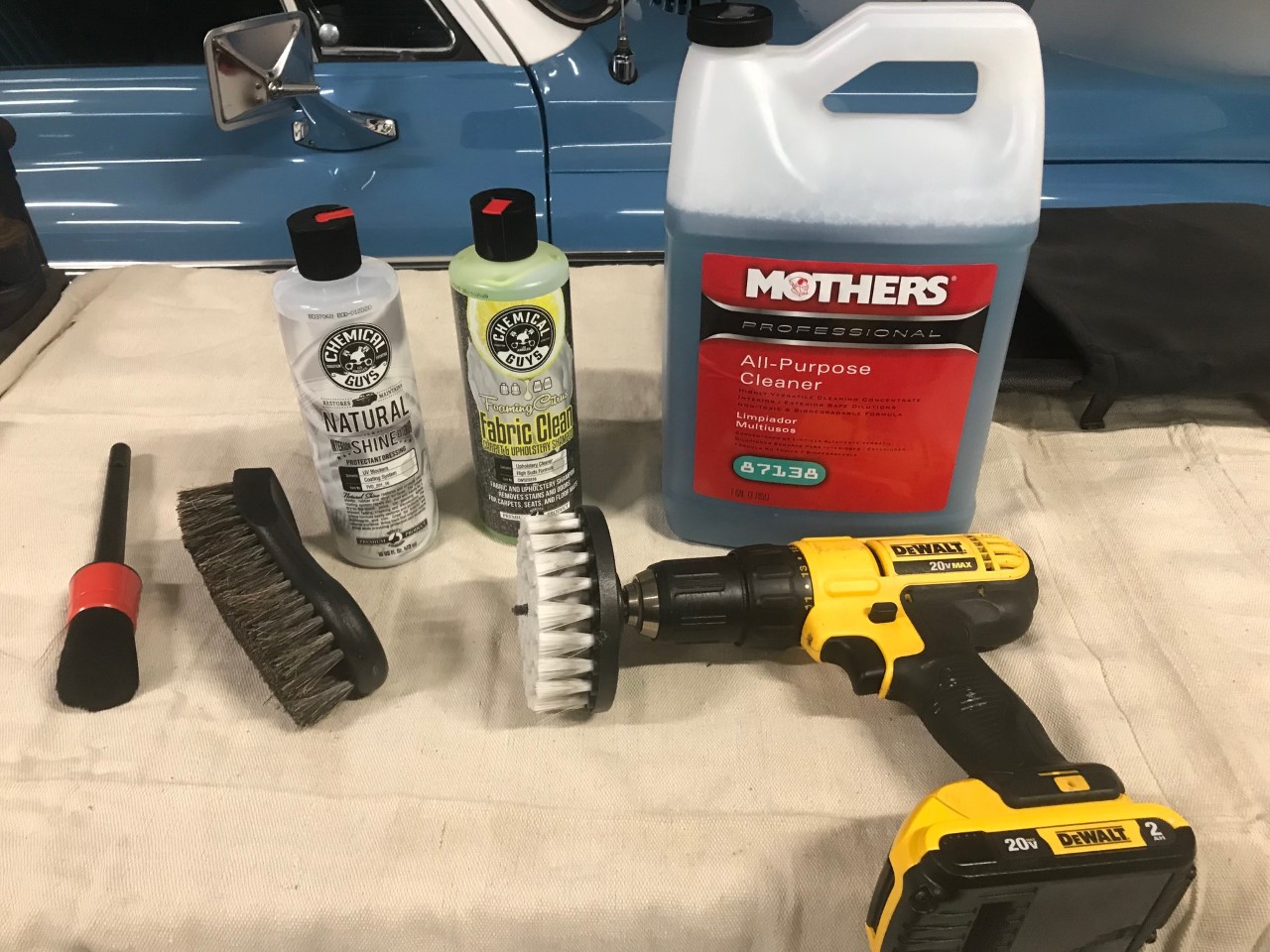

Plastics got scrubbed with a horse hair brush and all-purpose cleaner then dressing. Removed a disgusting amount of makeup from the visor, radio, shifter and turn signal, etc.

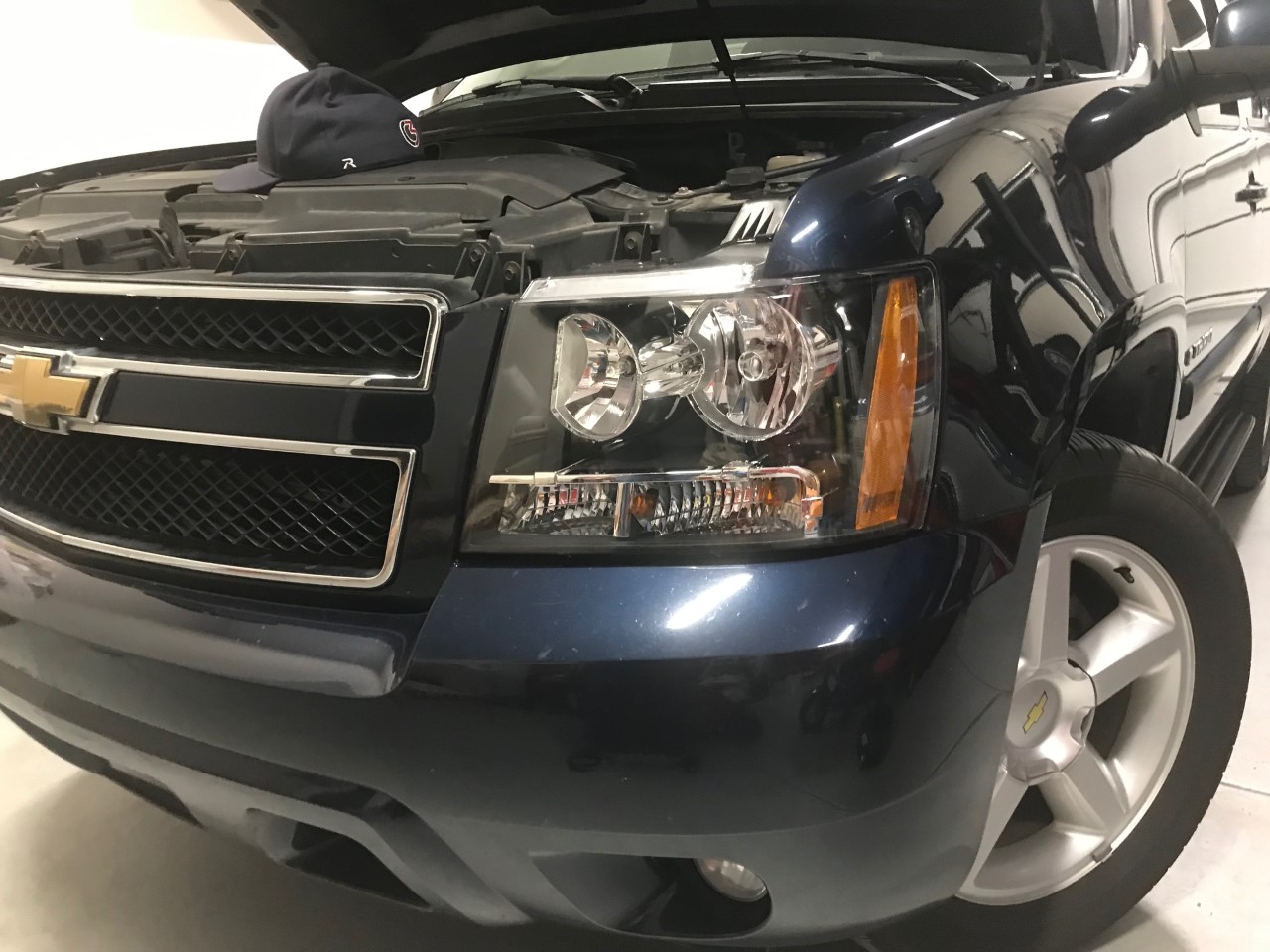

So I'm at $1,471 for parts to date, not including supplies or tools, but I am further along than I anticipated for the money. Not having to do ball joints, tires, etc. has been good for the budget. I still have to address the fuel tank leak, hopefully that's a cracked fitting or a line and not the pump then I am planning to take care of the rear main seal, oil pan gasket, oil pressure sending unit, and valve cover gaskets. After that, with a few more "test" miles it should be ready for driver status then finish the exterior cosmetic stuff at an easier pace. Not bad progress for 6 days I think (bought last Saturday). Here's the current parts list.

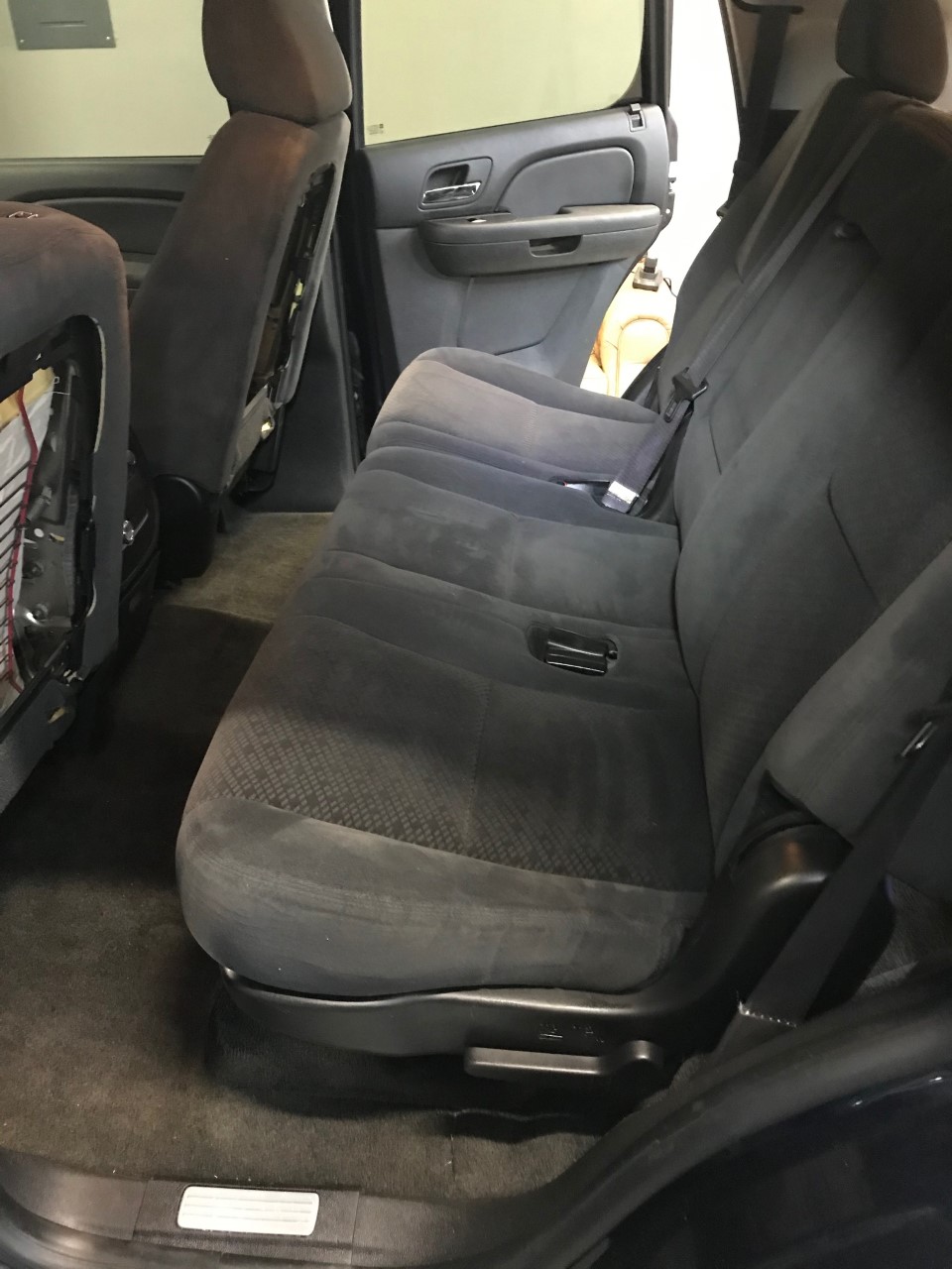

The durofoam seat bottom is in, and I made some repairs on the seat back. It felt a little soft because the wings were split where it wraps the seat frame. So I glued the foam together, cut some canvas drop cloth an stuffed it back in the cover. It feels like new.

Thanks! And dang you just reminded me I have some of that 303 and it's great lol. For cleaning plastics I used Mother's all purpose cleaner with a horsehair brush and detail brushes. For upholstery I usd Chemical Guys Foaming Citrus Fabric cleaner and a drill brush. I used Chemical Guys Natural Shine for dressing.

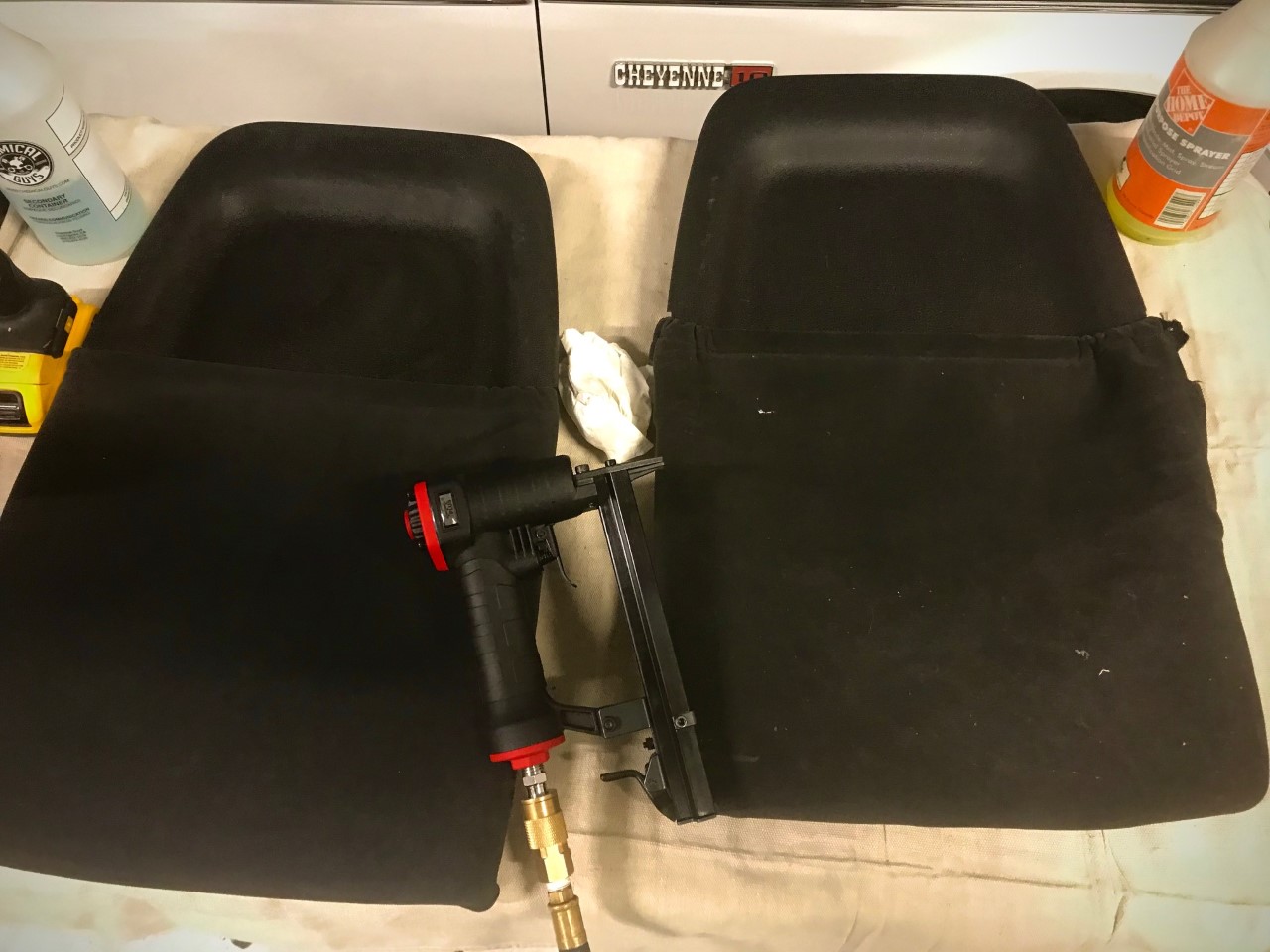

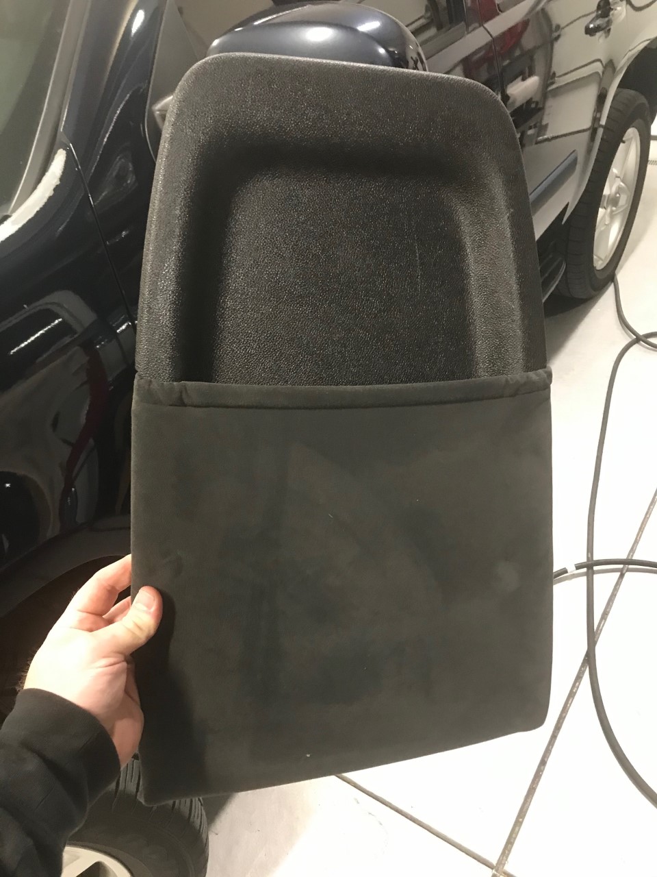

Tried out the upholstery staple gun on the seat back pockets. Both were falling off and loose but not torn or anything. I removed all the staples, tightened the elastic (it's just tied on the back if anyone has this problem), re-stapled the edges and cleaned. 5/32 staples. Happy with the outcome.
